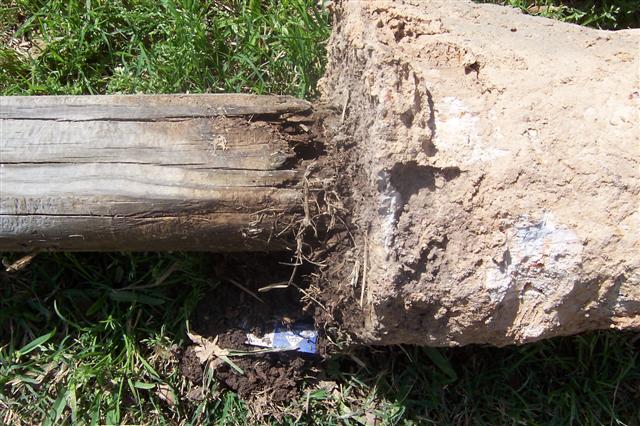

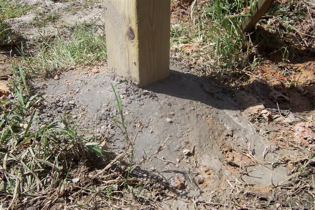

If you have clay soil, then you don't really need to add concrete to the posts. If you have sand or a loamy soil, then concrete should be used. Either way, the important thing to remember is that almost all rot occurs at the area where the post comes out of the ground. At this area, water settles and the moisture remains. Every post that I have ever repaired, and I've done quite a few, have rotted at this location. What is below grade is usually in perfect condition. If there is damage, it's minimal.
When setting your post, it is very important to build up a slope around the post to get water to flow away from it. It doesn't matter if it's dirt or concrete, just as long as it flows away. What I think happens, is people do this to some degree, but over time, the dirt settles and end ups creating a shallow area that holds water. With concrete, I see that concrete is well below grade, and this is even worse, as it holds water right next to the post.
