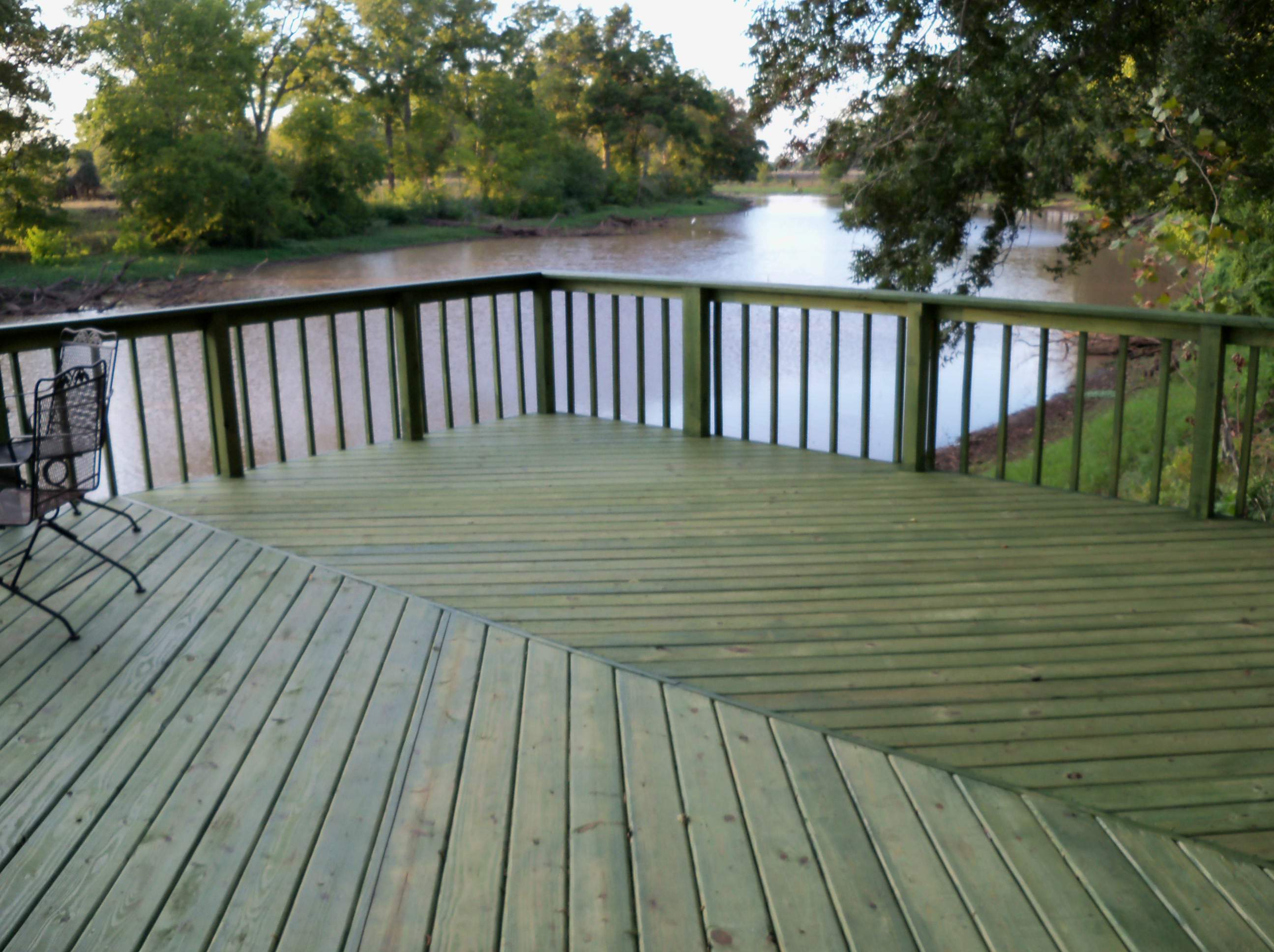

I just built this deck late last Summer and used a Valspar deck stain and it soaked in really well and repels water. It goes on like paint and the semi-transparent type I used shows a bit of the wood grain but contains a lot of solid particles. So far I like it much better than the translucent stains/preservatives I used on the older/ past deck. I plan to add another coat this next Spring to ensure good weatherproofing.

<img src="http://www.tractorbynet.com/forums/attachment.php?attachmentid=357559"/>
I thought you had to wait a full season before sealing wood?

In some areas that might be true but here on the Texas Gulf Coast this deck received 95F-100F temperatures for 2 months and 6 hours of hot western sunlight for 2 months before I applied the Valspar. The top decking which was treated 2X6 lumber with routed edges was screwed to the frame using furniture clamps where there was absolutely no space between the boards. Eight weeks later they all had a 1/4 inch gap between the boards so they had dried and shrunk enough to seal in my situation. Further north with moderate temperatures is a different case. In my area you can literally fry eggs on a Western facing deck for 4 months of the year from mid to late Summer.

I've had good luck with Cabot's stain on decks for clients and have started using it on the cedar posts I use on my place. Something to consider is that if the deck is 5/4 wood, it is going to shrink for at least a year. I still use 5/4 for some things, but prefer treated 2x8's for my decking. After years in the sun, there is almost no shrinkage or cupping like you get with smaller lumber. I never use nails either. Screws for decking, bolts for joists and beams on a solid rest notched out of the posts. I only use 6x6's for posts. Nothing else remains straight. It's not about strength, it's all about how it holds up over the years and what has proven to work compared to what fails over and over again.
