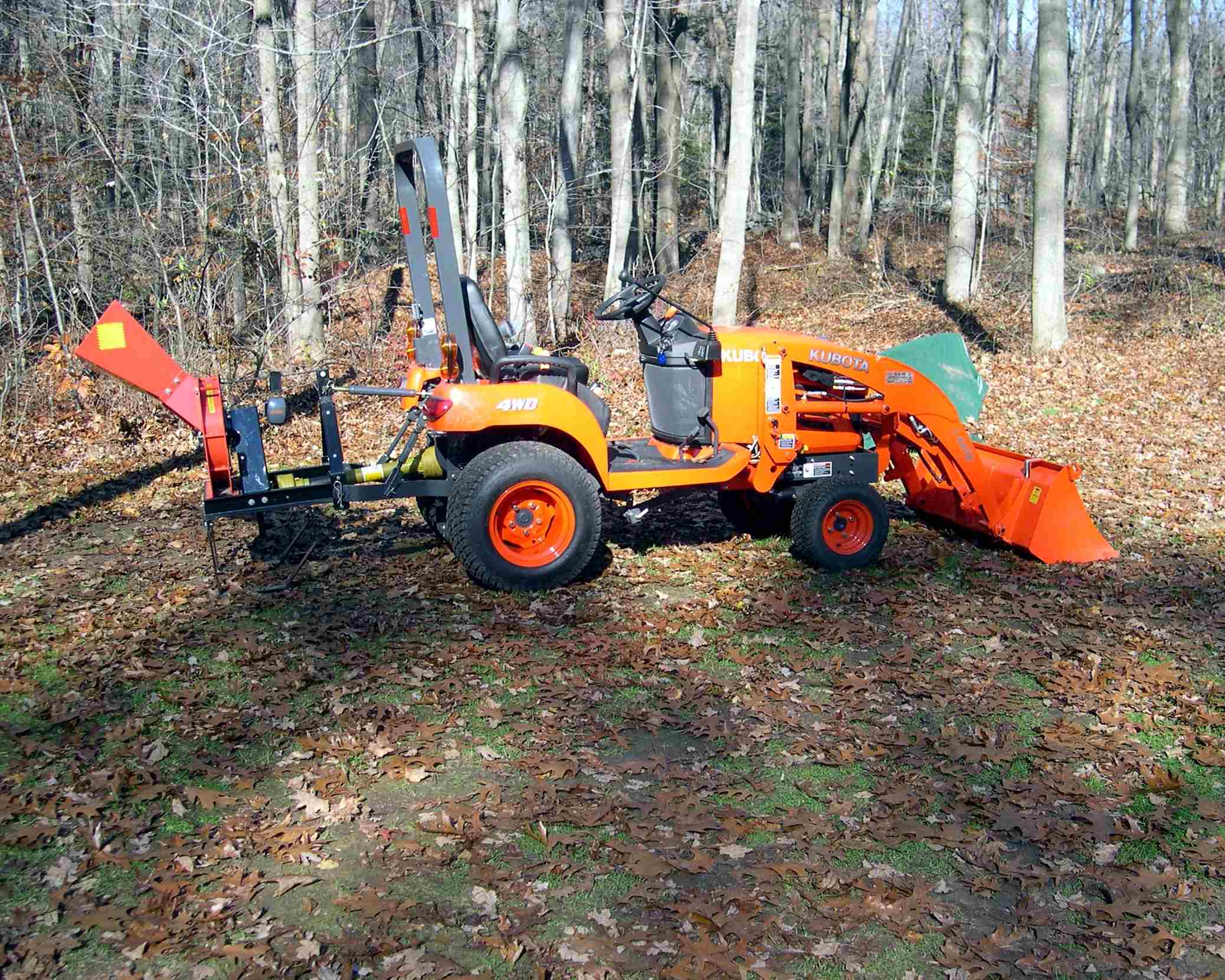

I have the BXM32 on my B2410. Sized well for it. 4" wood is firewood for me, so I went with the 3" chipper. The larger throat of the 4" would have been nice, but with the shredder the 4" was quite a bit more money. I have had to pull a few branches and cut the forks to get them in, but pretty minor issue. It has performed flawlessly for me so far!

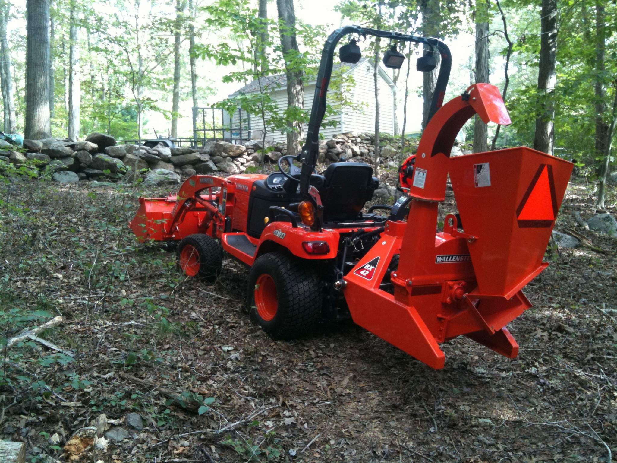

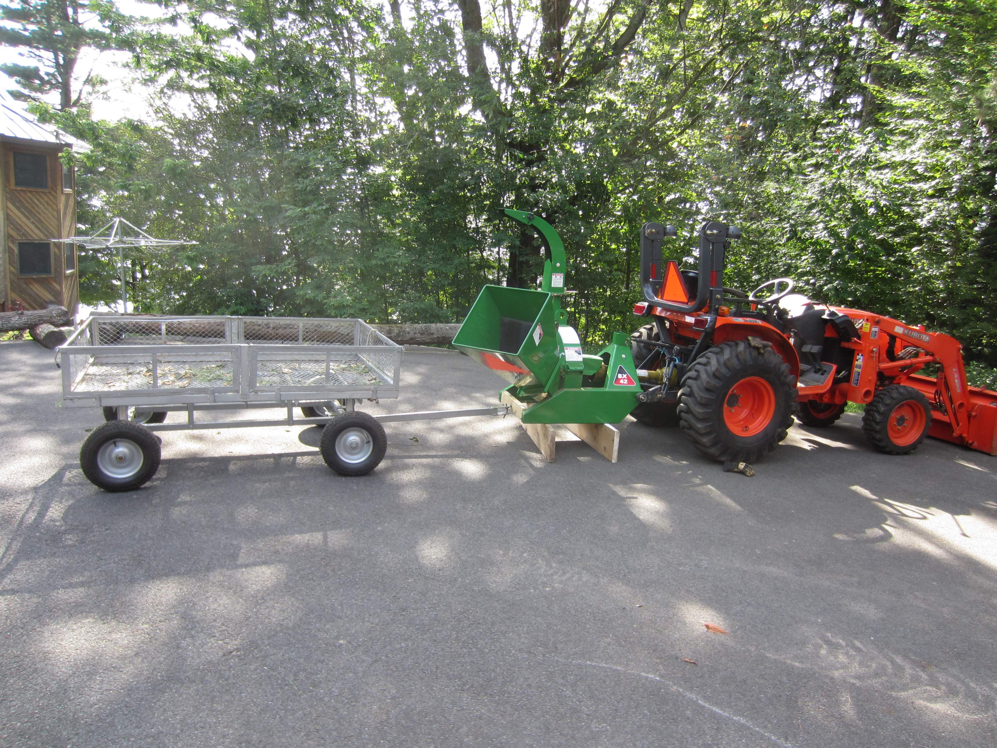

I bought a BXM 42 last year and I love the shredder part of it cause of the size shoot. Make sure your gloves are strapped tight cause that brush will disappear fast . Mine has a belt drive which is reason no. 2 why I bought a wally. The belt will give if I have something stuck which has not happened yet. Paul, This thing is for real, no kids toy.

Knight9 got a nice unit. Thanks for posting the photo. Your BXM32 looks like the ideal unit for my needs. Like you stated, anything more than 3" is firewood.

Murphy1244 is happy with his BXM42 but that model is to big for my little BX25 but would work well own the 5740. I also appreciate his warnings. If I think it's getting to dangerous I just ask my mother in law to feed the unit :laughing:
