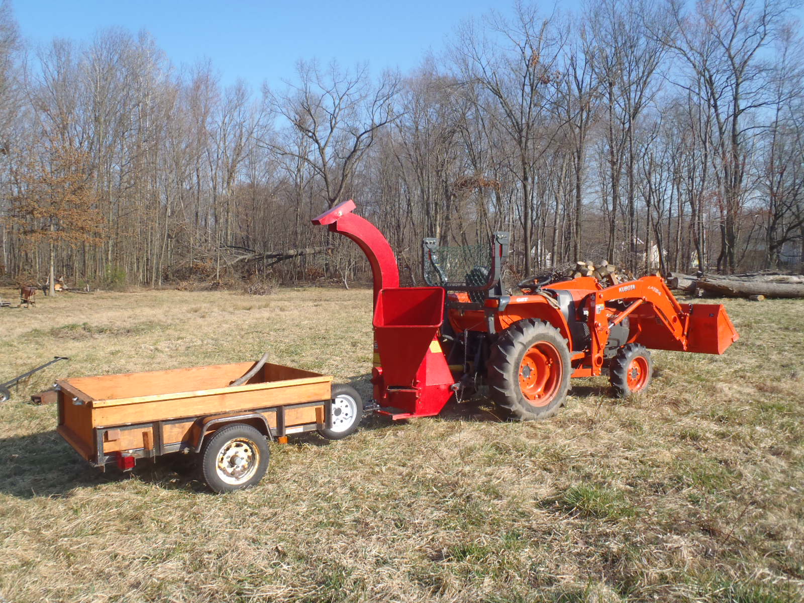

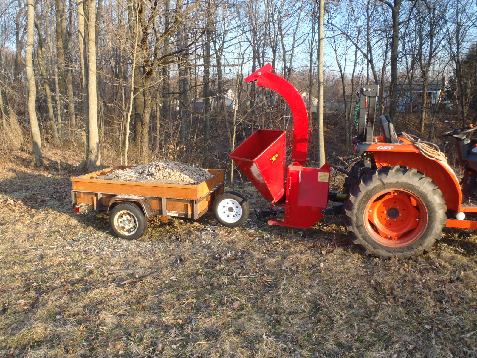

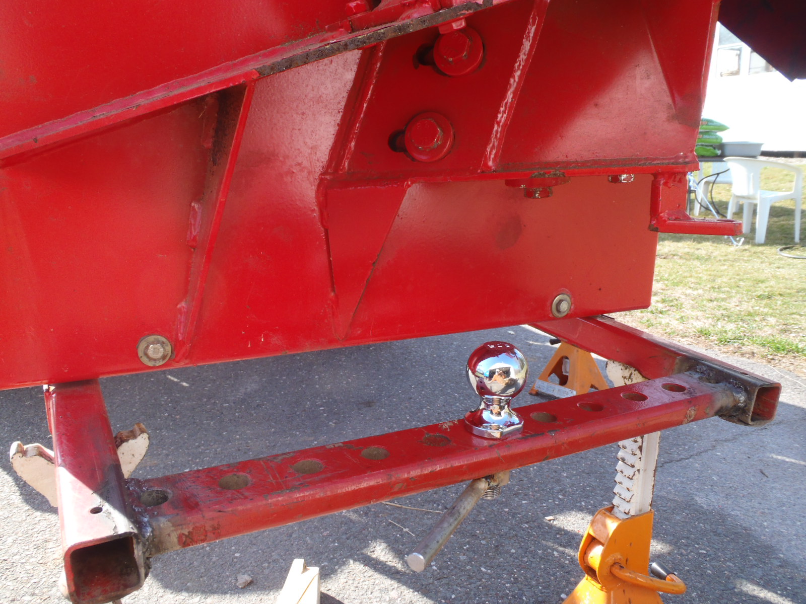

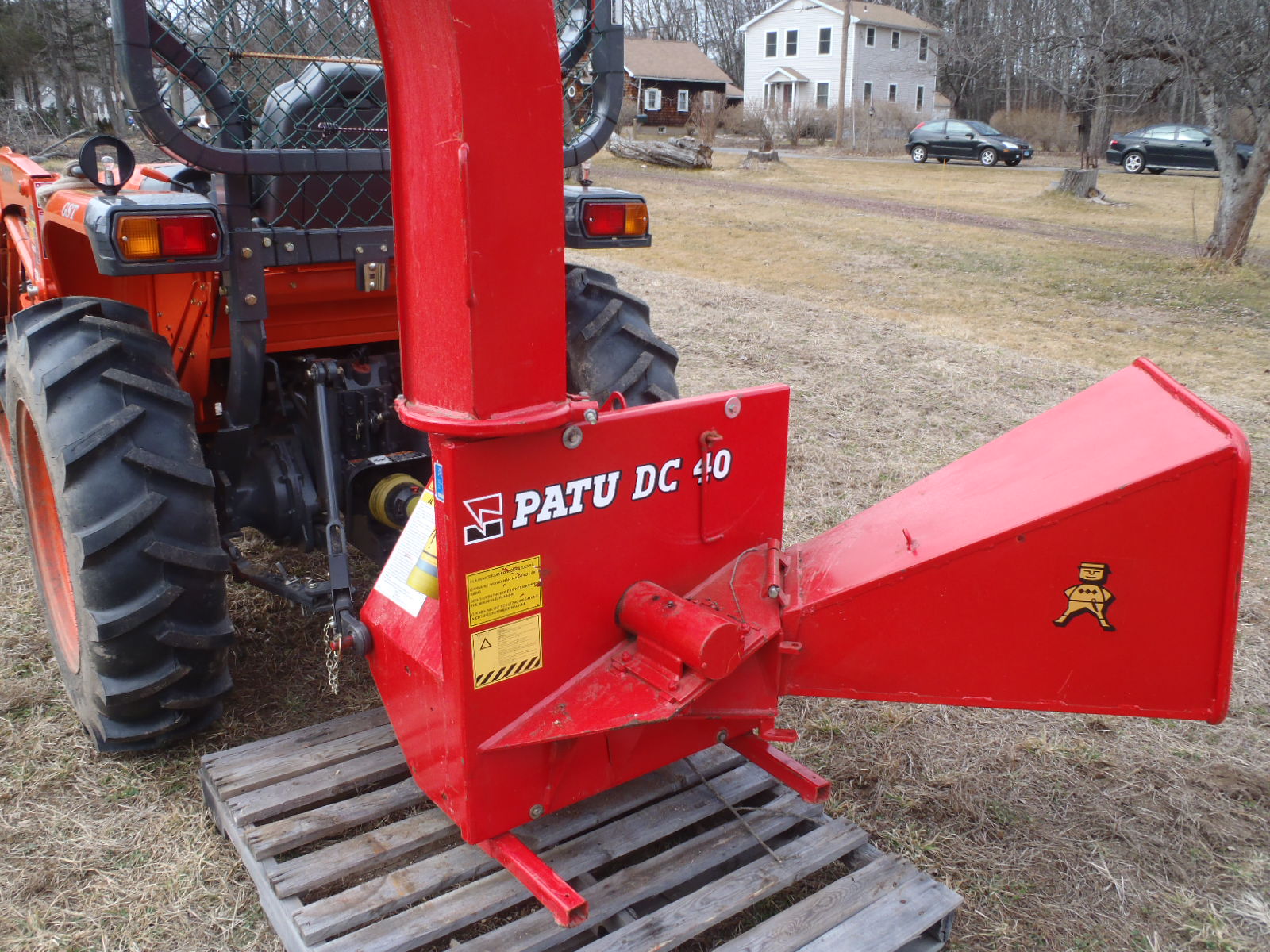

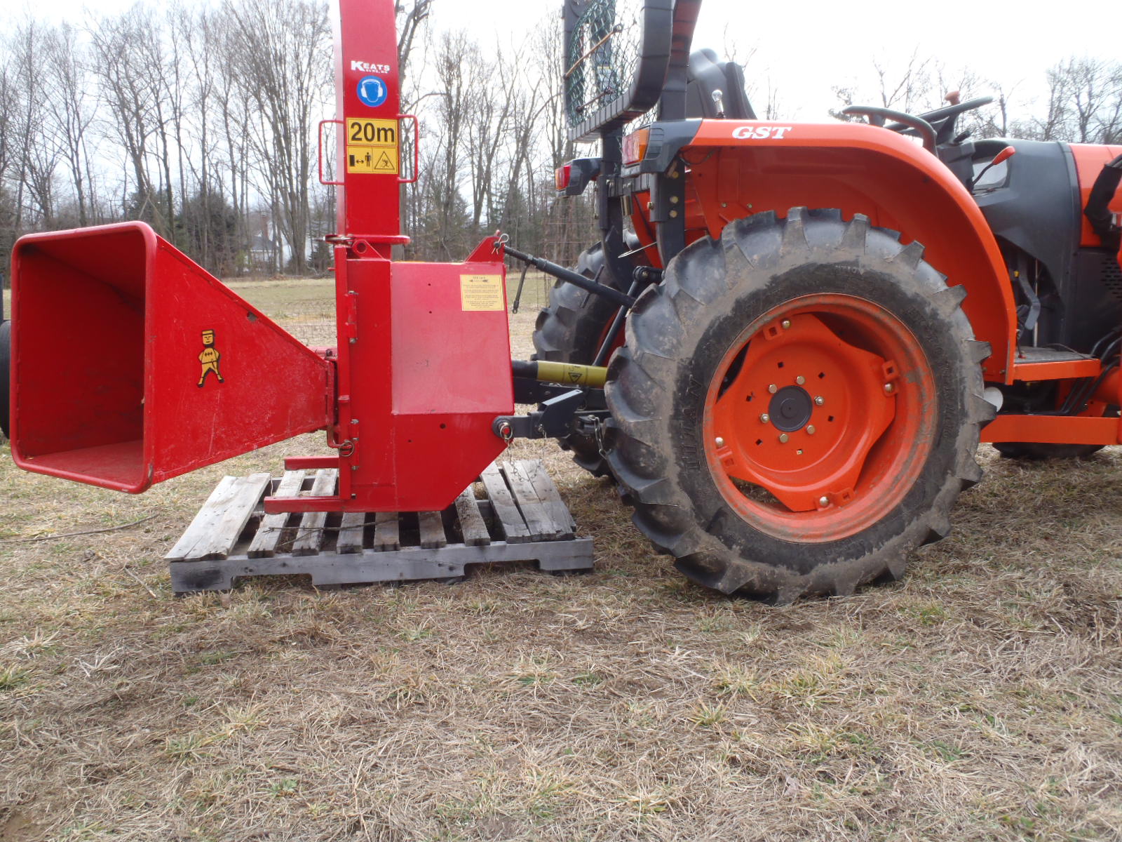

I was all set to get a new Wally bx42 when I found a Patu DC40 on CL a few months ago for $1500, which I bought. It had been used, but not abused. It's a direct drive, 3 blade configuration with a 360 degree rotatable output chute. It took some time to get the anvil gap & chip size adjusted, but once that was done it draws limbs in nicely. It has never clogged and I've made 15 to 18 trailer loads of chips, so far, and the blades are still sharp. The availability of replacement blades is a bit of a question mark for me - I haven't found someone who can supply them, yet. When the time comes, I may get a second set made by a local machine shop.
There have been a few times when I wished I'd got the Wally - especially when processing Pin Oak and Silver Maple, which both have some gnarly, twisted branches. That 4x10 infeed on the Wally would really shine with that kind of work. With the Patu it means I need to limb those branches more carefully, cutting anything that branches at a large angle from the main stem before I try to wrestle it into the chute. One thing I like about the Patu is that the chute is just about horizontal, meaning you don't have to lift limbs very much to get them feeding - you can just slide them in from a natural carrying height.
Overall, I am extreemly pleased with this purchase. It's built like a tank and takes anything that I can stuff into the opening and turns it into mulch.
