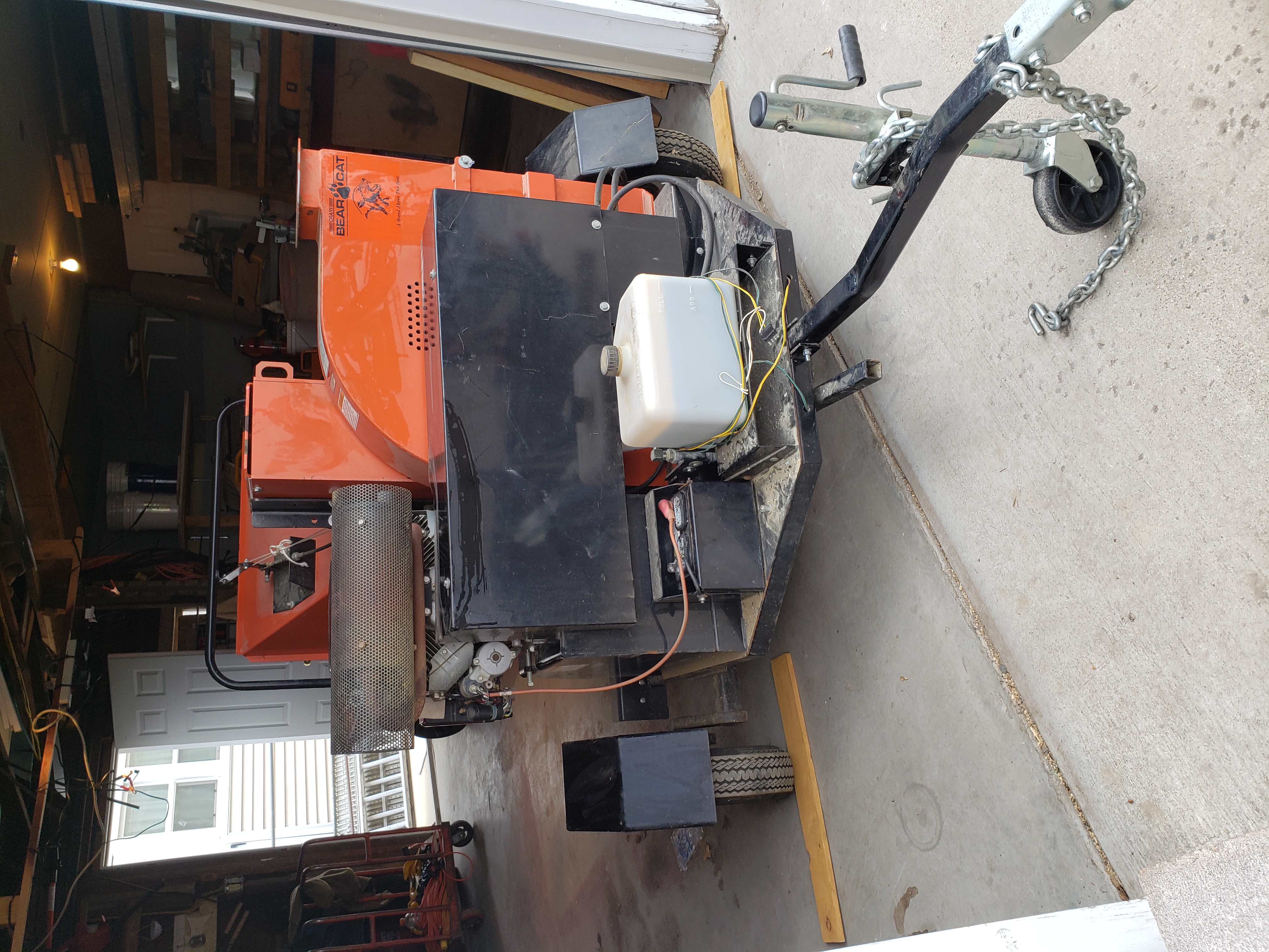

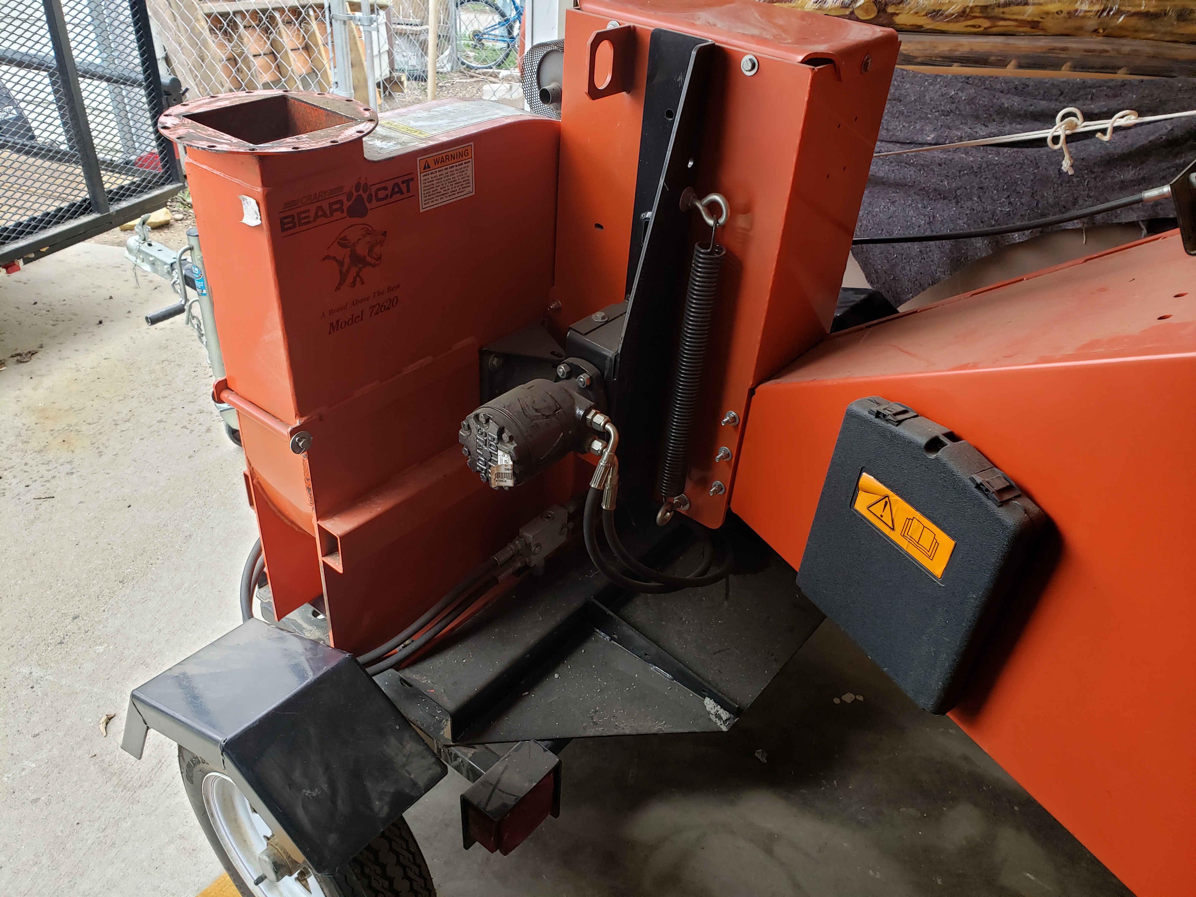

I have a echo bearcat chipper that is towable. I put about 30 hours on it chipping all the dead pine beetle up at my cabin and I have no more use for it. I am trying to sell it and I almost can't give it away. I paid north of 15,000 new and even at 8500, people think that is high. It's amazing how cheap some people are...
I've had a PTO chipper in the past, but these towable chippers that have the engine and hydraulics self contained are the way to go.
