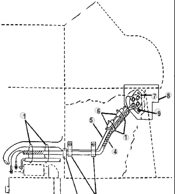

I reread OP's statement & decided 2040's non-starting problem is electrical not hydraulic related as I previously implied. I think starter solenoid plunger is binding from heat. Another thing that might help warm engine start better is relocating factory ground cable from RUSTY battery box to engine block or starter mounting bolt if not presently relocated. JD also offered a starter relay kit to supply more amperage to solenoid engagement wire(see photo below)

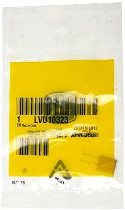

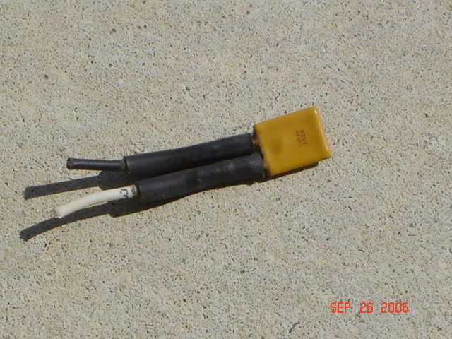

Your problem is almost definitely a failed thermister. I've had three John Deere tractors with exactly the same symptoms caused by a failed thermister. The standard symptoms are that the engine will start immediately when cold and will continue to run without problems, even when hot. If you shut the engine down, it won't re-start until the engine cools down even with the starter spinning fast. Actually, it is the thermister cooling down, not the engine. Once the thermister cools down, usually 30 minutes or so in my cases, the engine fires right back up. The thermister on my JD tractors was buried in the middle of the wiring harness directly below the steering wheel, and somewhat difficult to access. It takes me about an hour to replace the thermister. The same thermister is used on all JD tractors as far as I know, and the part number is: LVU10323. I believe I paid ~$5.00 for my first one and around ~$12.00 for the last one I bought. A lot of people have gotten ripped off with expensive repairs that were not needed due to the thermister failing. I was initially told by a JD dealer that I needed a new injection pump for a very large price, when this happened to me the first time. Fortunately, someone else familiar with JD tractors gave me the real story and I took my tractor back from the dealer and replaced the thermister myself.

He said the starting problem involves the starter not working. Doesn't sound like "spinning fast but not starting".
I'm no Deere expert, but I wasn't aware that any 40 series tractors used a thermister. Always good to learn something new.
/ Won't start when hot #10

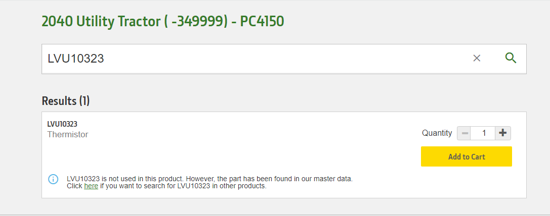

Harry you're correct JD 40 series tractors such as a 2040 had no thermistor(LVU10323)
