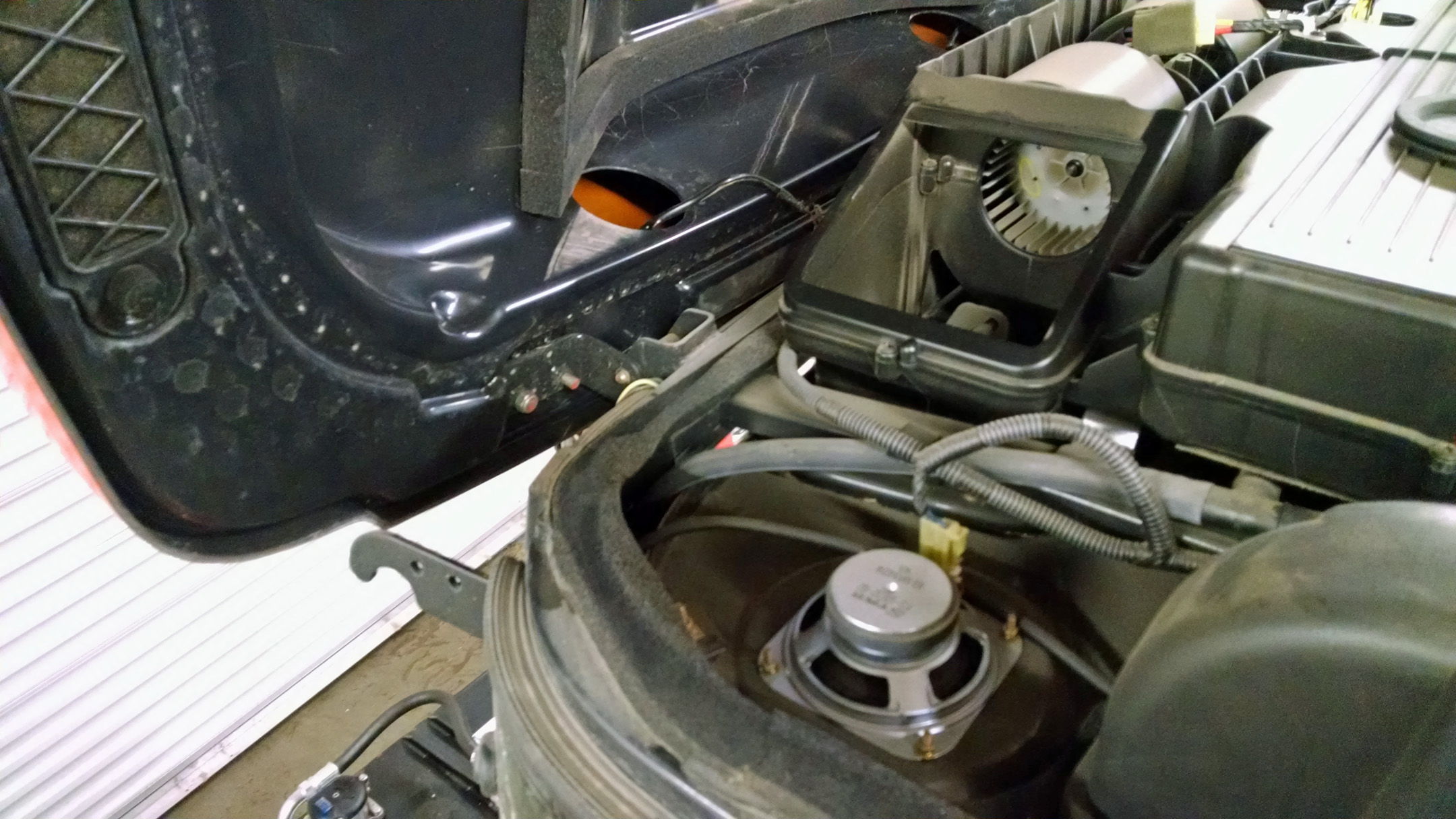

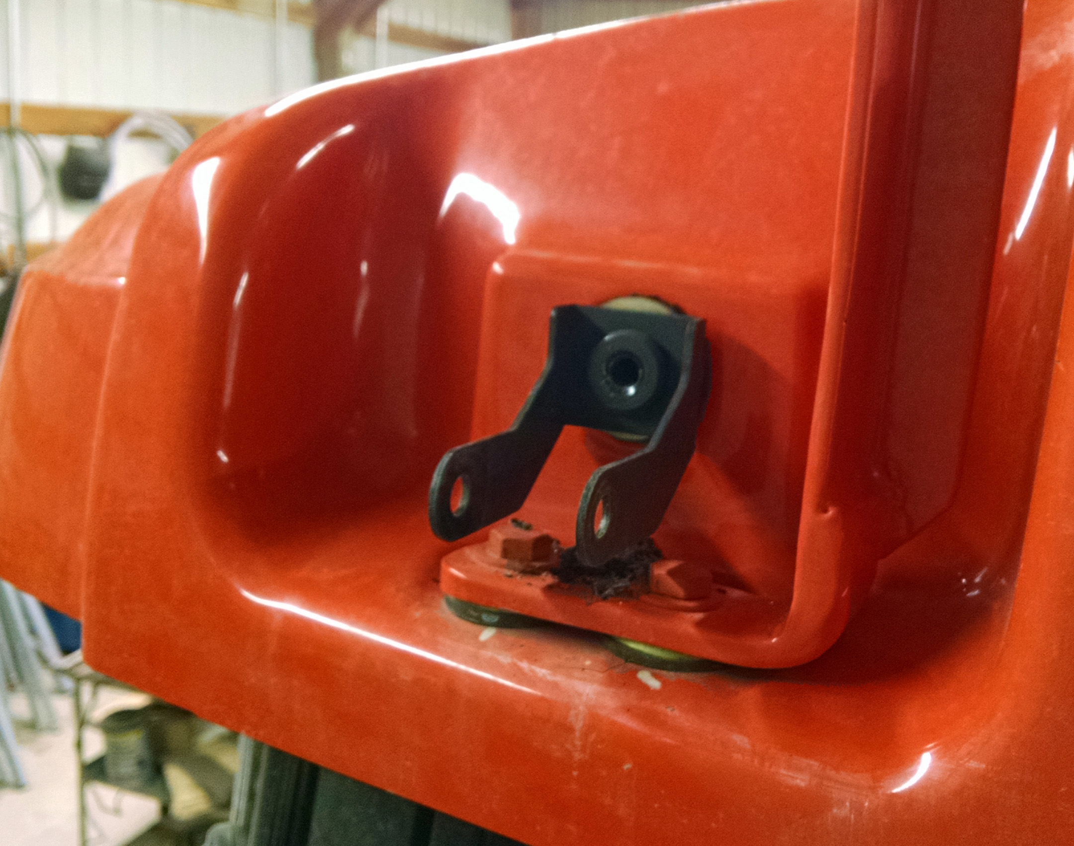

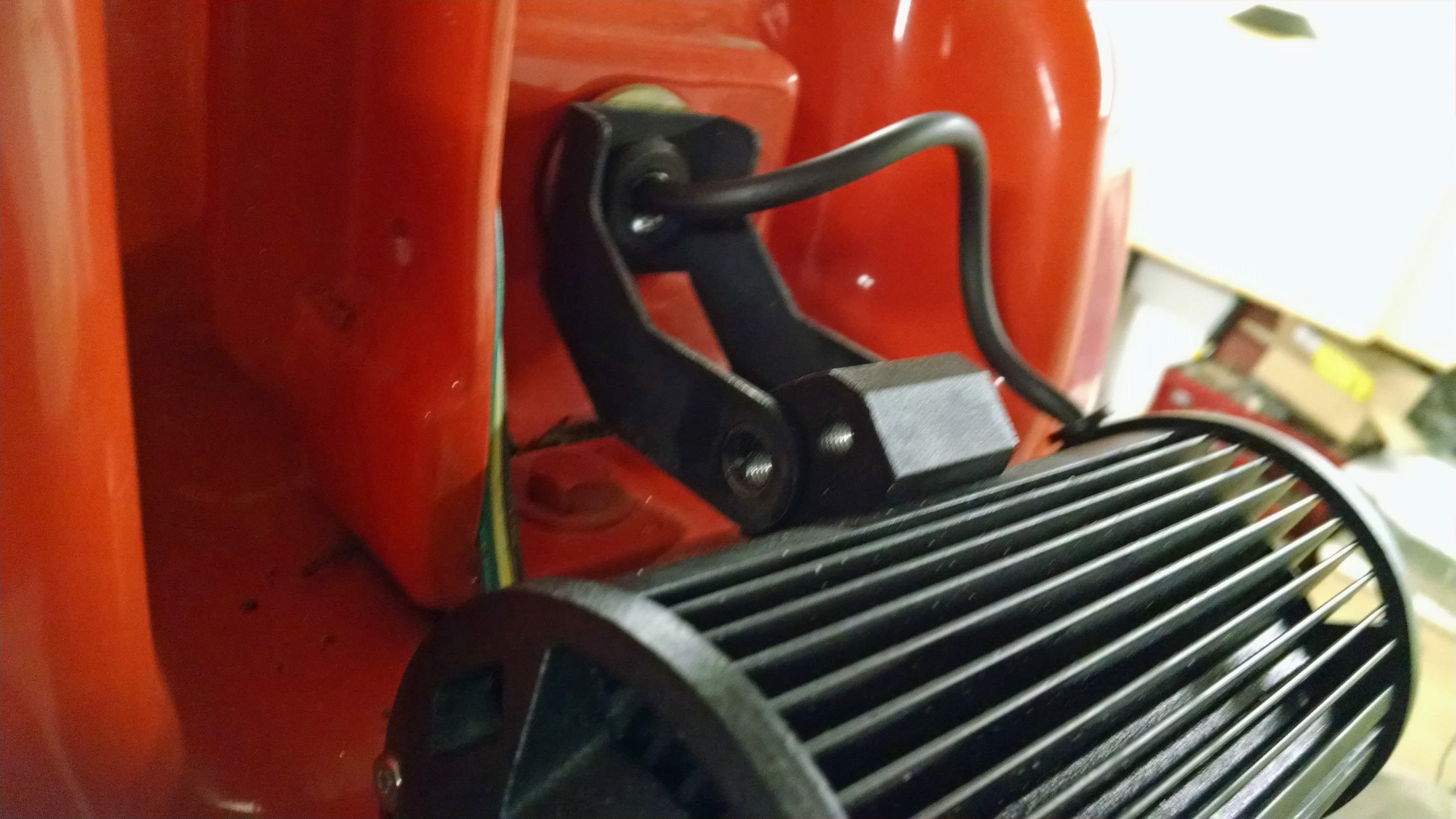

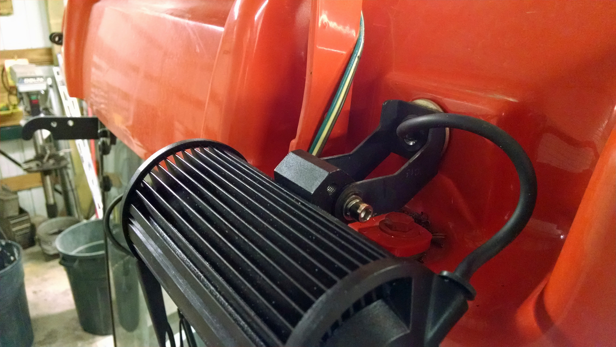

getting ready for winter, and was wondering if anyone has had success with replacing existing kioti cab lights (factory) with decent LED replacements. im ok with the factory lights, but was just pondering future replacements. dont want to have to modify factory light mounts.
any suggestions or actual results.

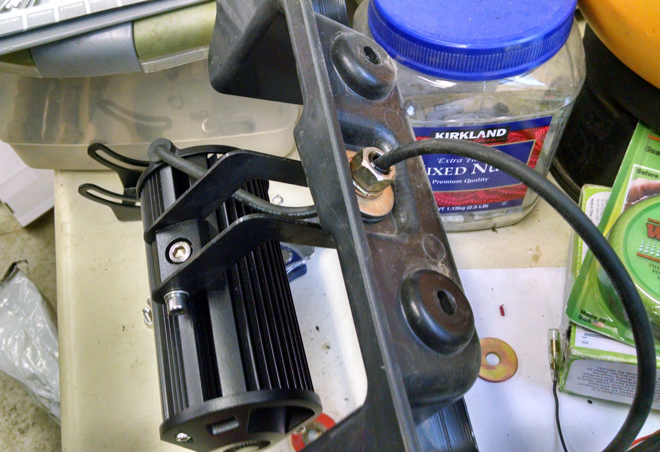

Yes, I've replaced the Kioti factory lights with 36 watt Cree LED's. Night and Day difference (pun intended). I replaced the rear lights with the same 36 watt LED's. The LED's actually draw less current then the factory halogen lights. Just remove the Cab lid and cut into the factory wiring system. I'm using LED flood lights, I started with 18 watt LED's on the rear..but it just wasn't enough. The 36 watt are VERY Bright!!! You can find tons of types and styles on E bay or Amazon for a decent price. I'm about $70.00 a pair delivered to my door.

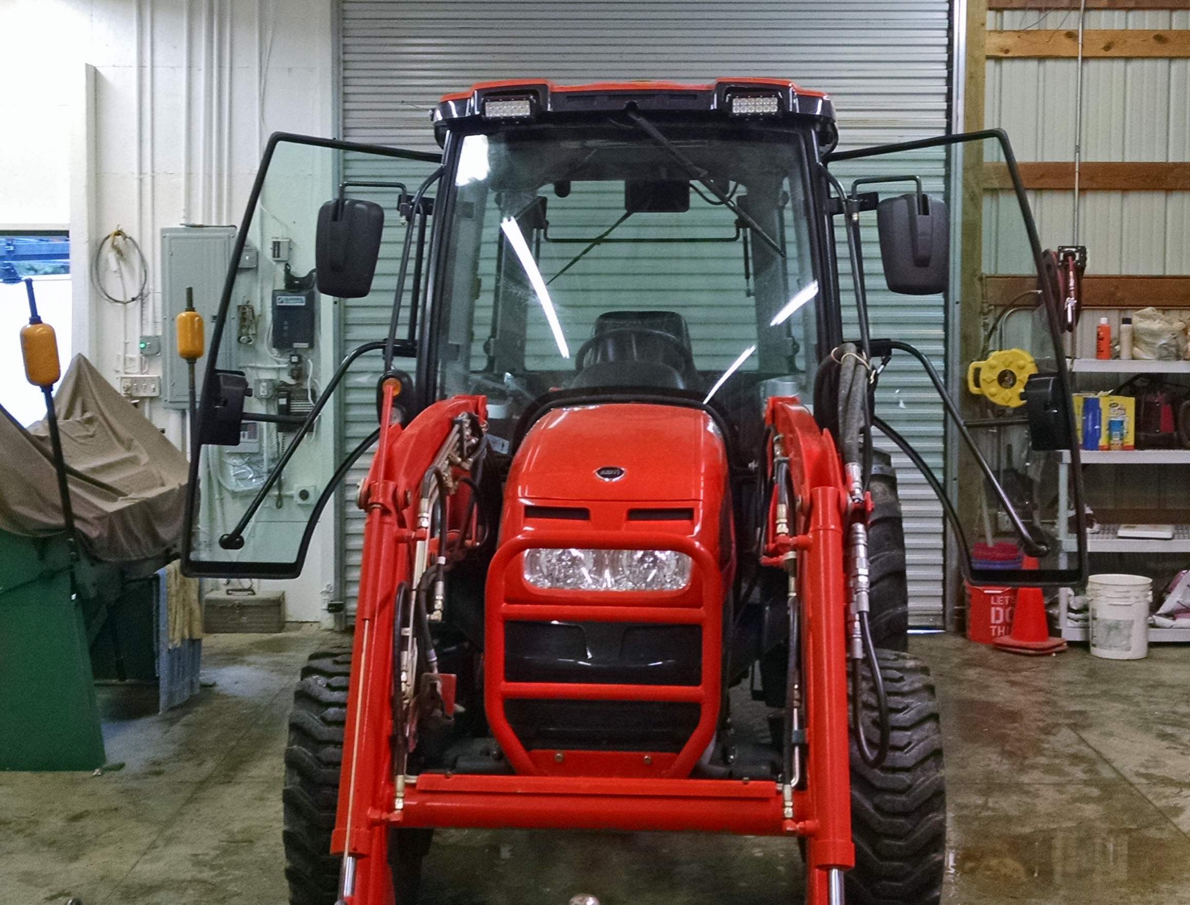

i found some 36 watt LED's on ebay. got 4 of them for $140.00 delivered . i thought $35 per light was doable. Took 2 hours to install. they were direct replacement. no new brackets needed.
im a convert.....used to think factory were enough. but these are very very bright.
light remounted.jpgfront lights installed.jpgexisting bracket.jpgnew light mounted.jpgrear light feed.jpgrear light installed.jpgrear light.jpgfront light installed.jpg

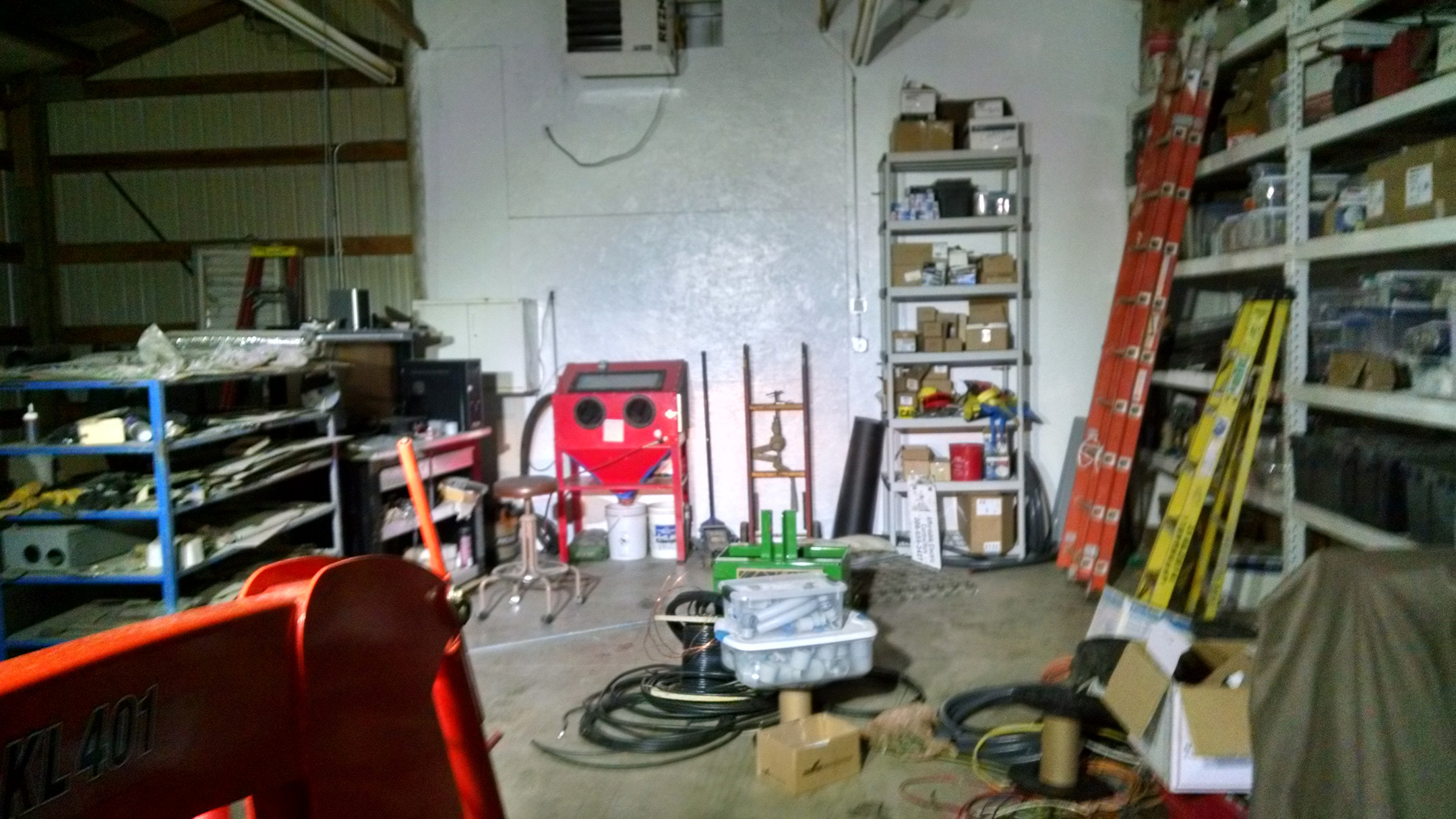

before install. looked brighter in shop than picture makes it out to be. headlight and overhead light on. original lighting.jpg

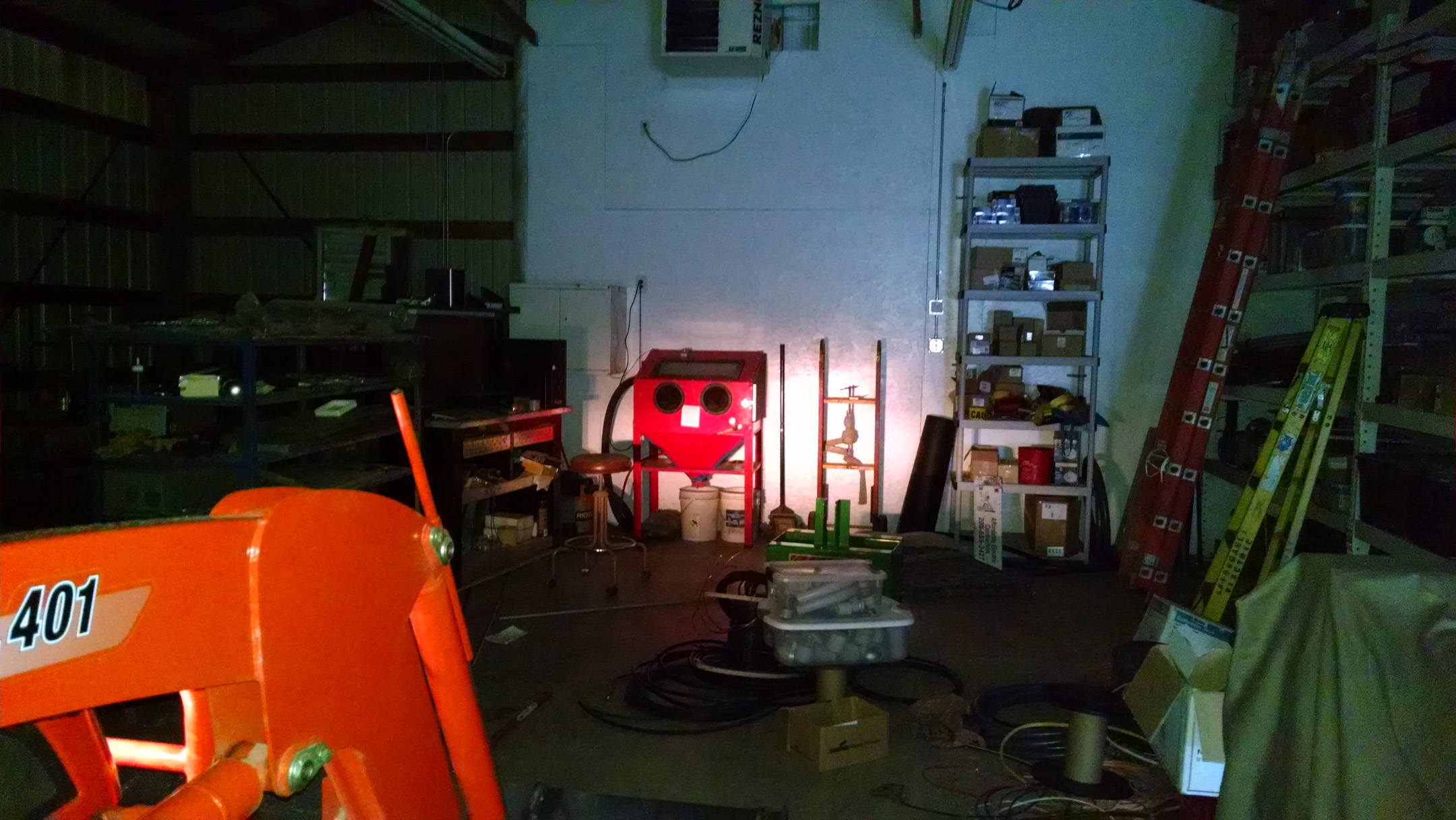

after install . new LED lighting . forgot to turn on headlights also like original pic..oh well. led lighting.jpg
