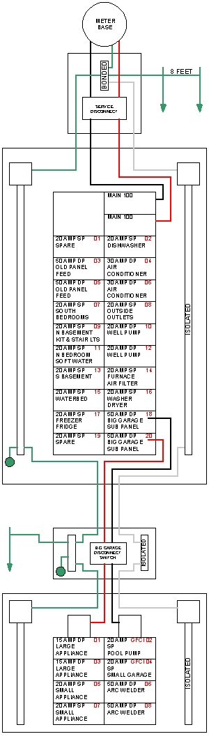

Here's a schematic of my house I found while looking around on TBN! hahaha...

We have a 1350 square foot house with 100 amp service. Central air. 220v well pump. Freezer, 2 fridges. Gas appliances all 110v. I have a service disconnect directly below my meter. That is the main panel. That feeds 12' of wire to my house sub-panel. In that house panel there's a 50 amp 2-pole breaker that feeds a sub-panel in the garage about 75' away. From that 50 amp sub-panel in the garage I run a 15hp swimming pool pump, an 8-10 amp salt water chlorine generator, 110v bandsaw, drill presses, 110v mig welder, 220v AC/DC arc welder, etc... I've had the pool pump, chlorine generator, band saw and arc welder all going at the same time and never tripped 50 amps to the garage. And I've done that in summer with the air on and laundry going inside the house. Never tripped a breaker.
