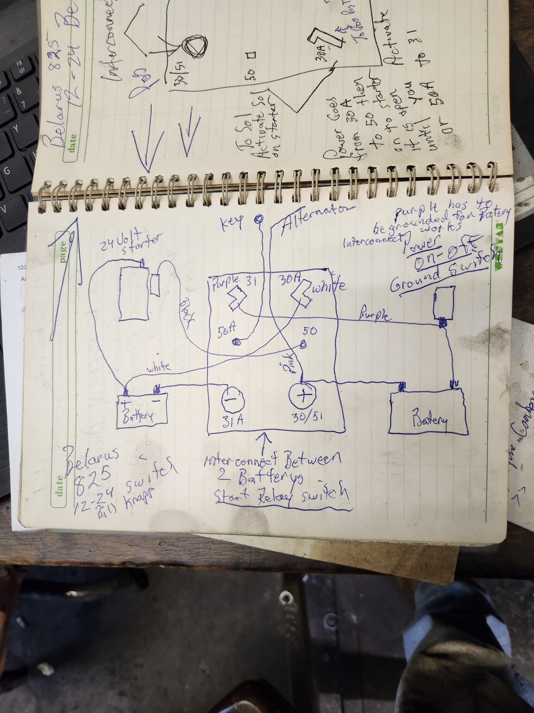

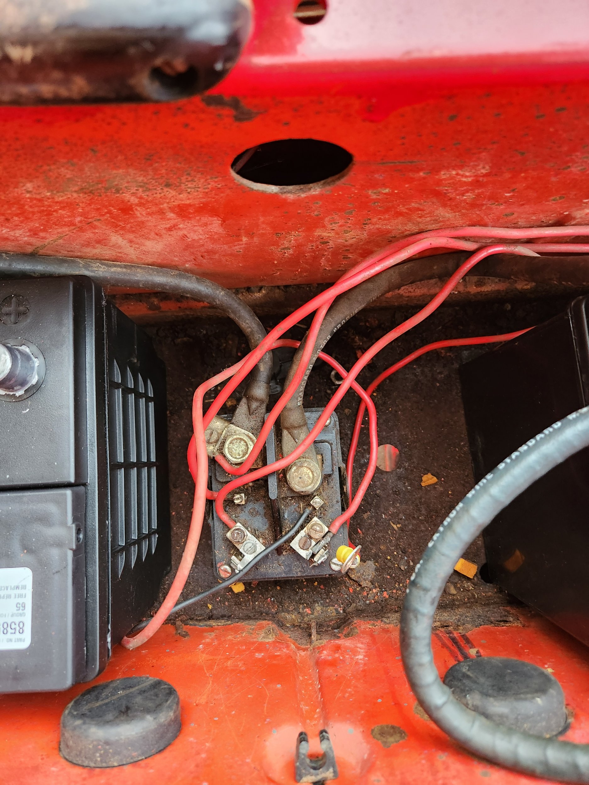

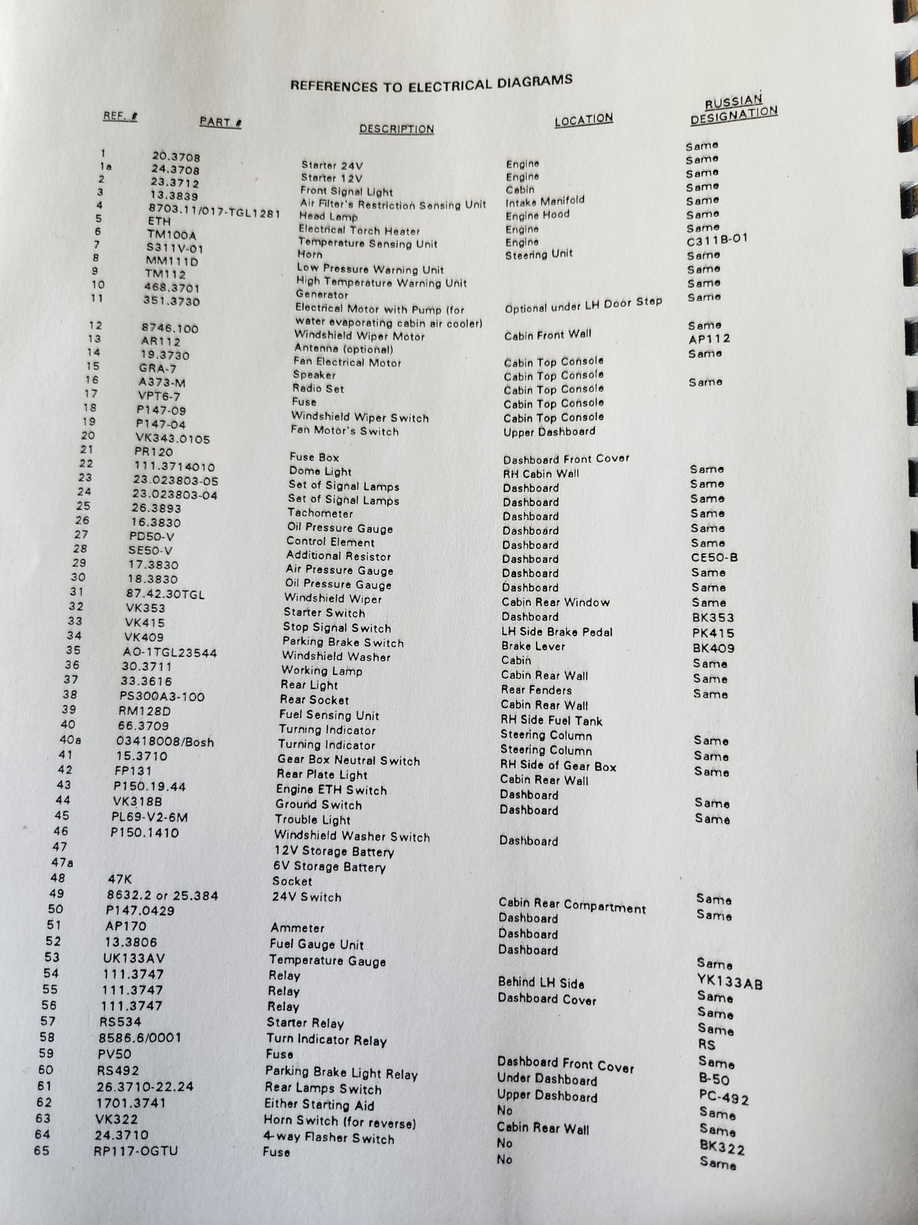

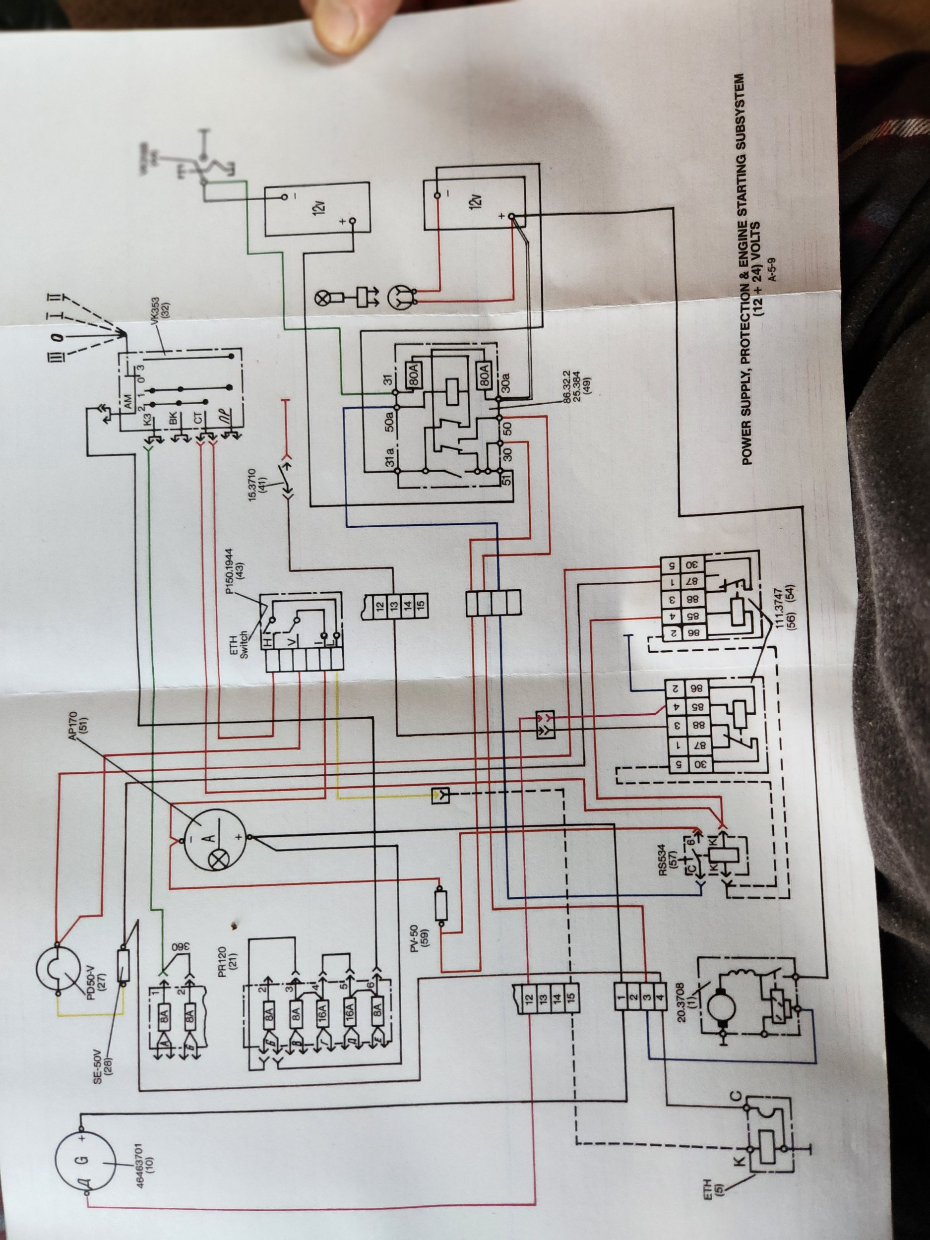

Does anyone out there have the wiring schematics for a belarus 825? I think that the person that had the tractor before me messed with the switch between the batteries that changes the voltage from 24 volts to 12 volts.. It doesnt even look like it is hooked up... All help is appreciated!
I have to figure mine out to. I find wiring such a overwhelming thing. My wiring in battery box is all the same color, so I have no idea what is what. I guess I'll have to chase each individual wire to find out where it goes. My my my, not looking forward to it
