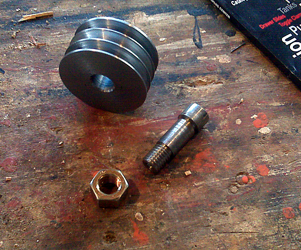

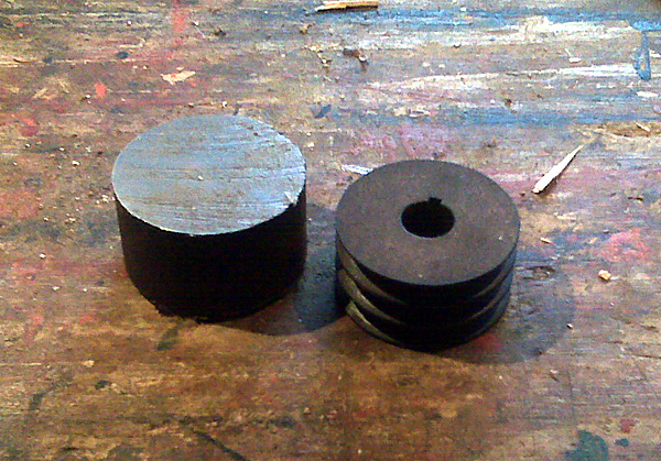

I wanted at least 3HP for the saw and locally I found only 6.5HP with the right rotation and 230V.
I decided to go with it, of course the pulley was not to be found anywhere, glad I have a lathe:thumbsup:
Here the original pulley and a piece of cold rolled steel I used to make the new one.

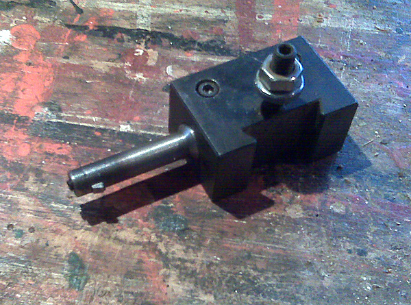

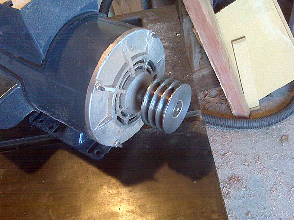

The boring bar with the broaching bit - it was not as hard as I expected to cut the keyway - finished pulley with the pin I used to hold it on and pulley mounted on the motor.
The saw cuts without hesitation anything I push through, never slows. Now I have to buy a switch, install blade protections, attach the router table and figure out rails and the ripping fence.
