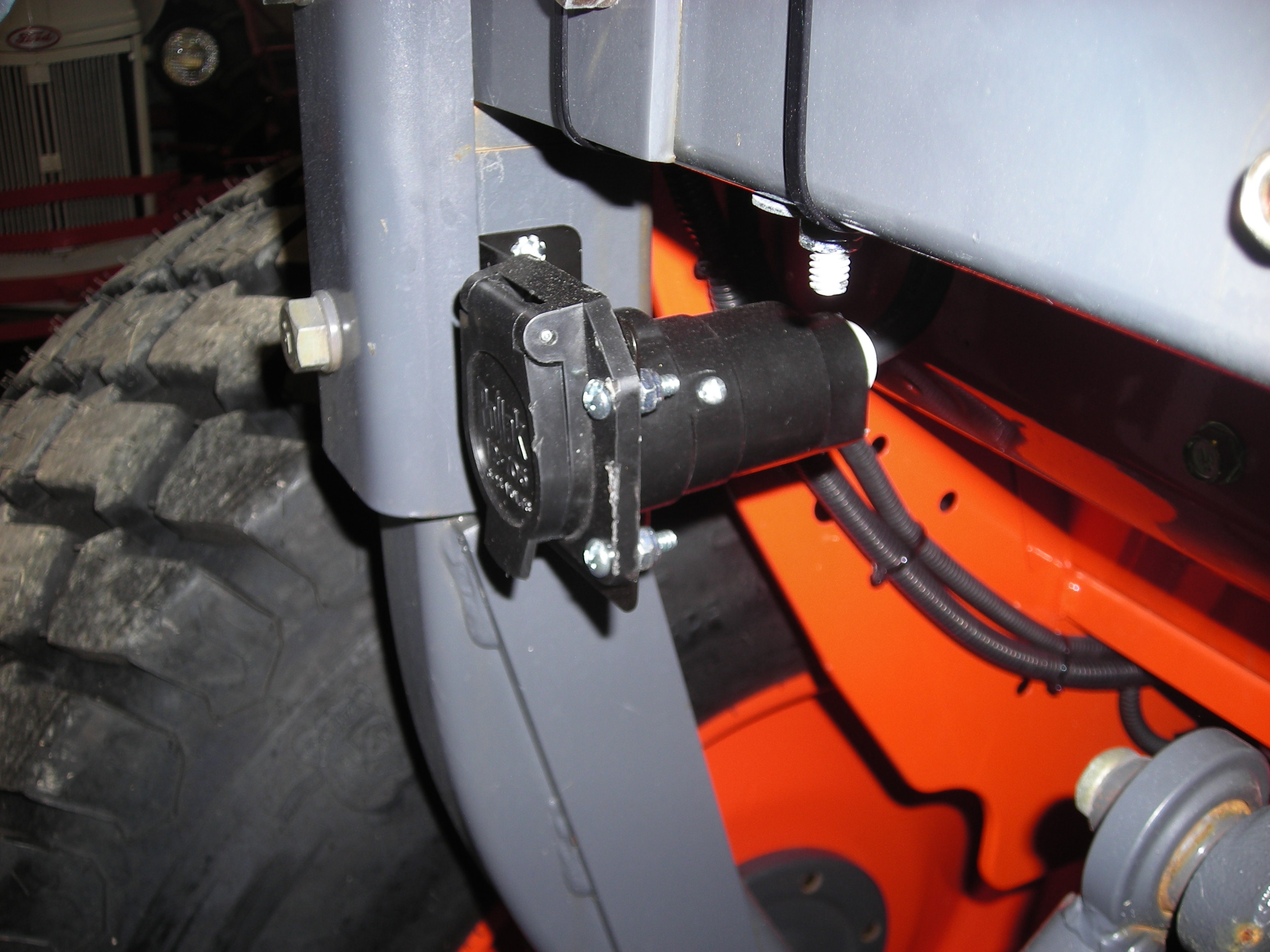

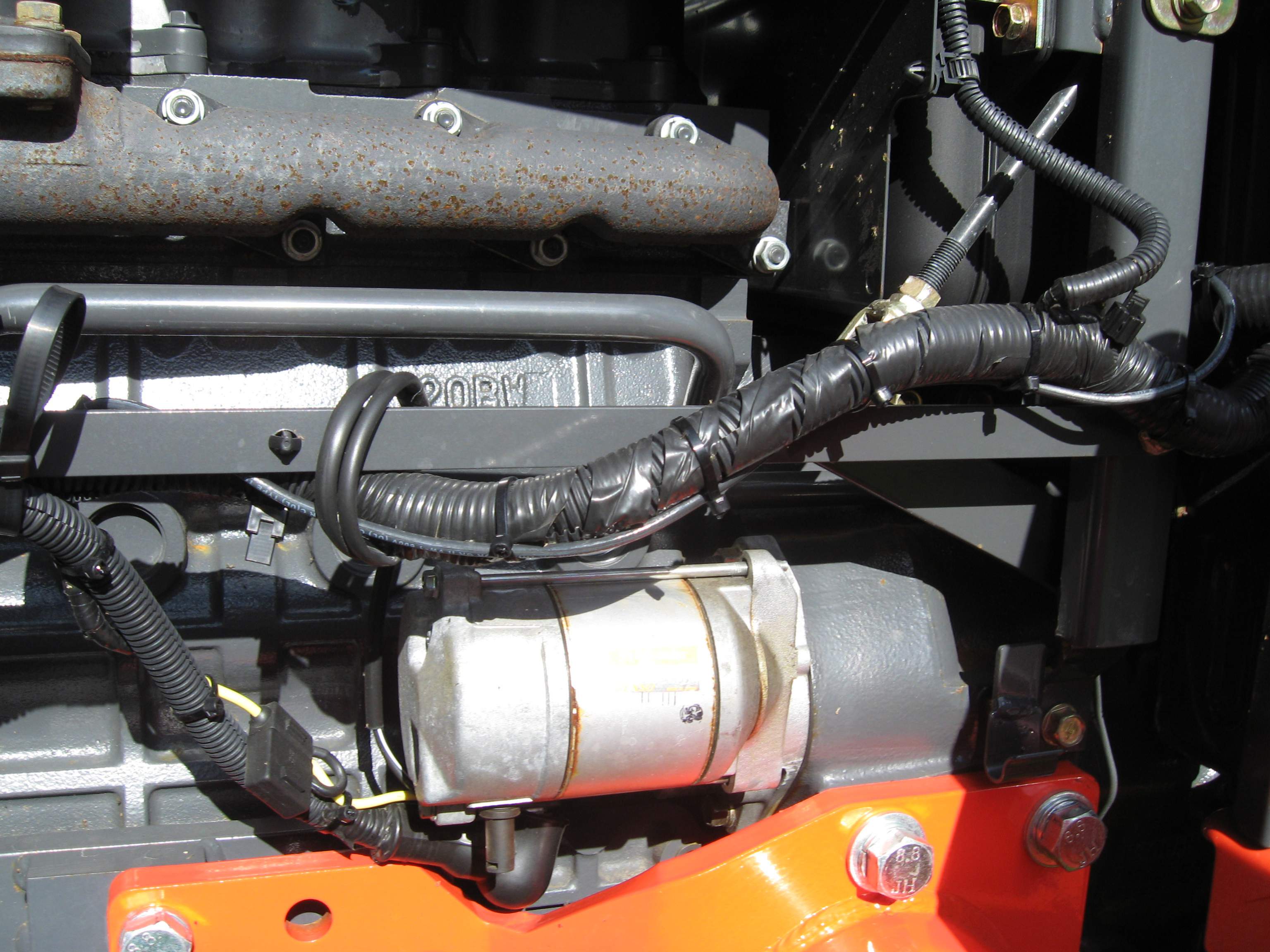

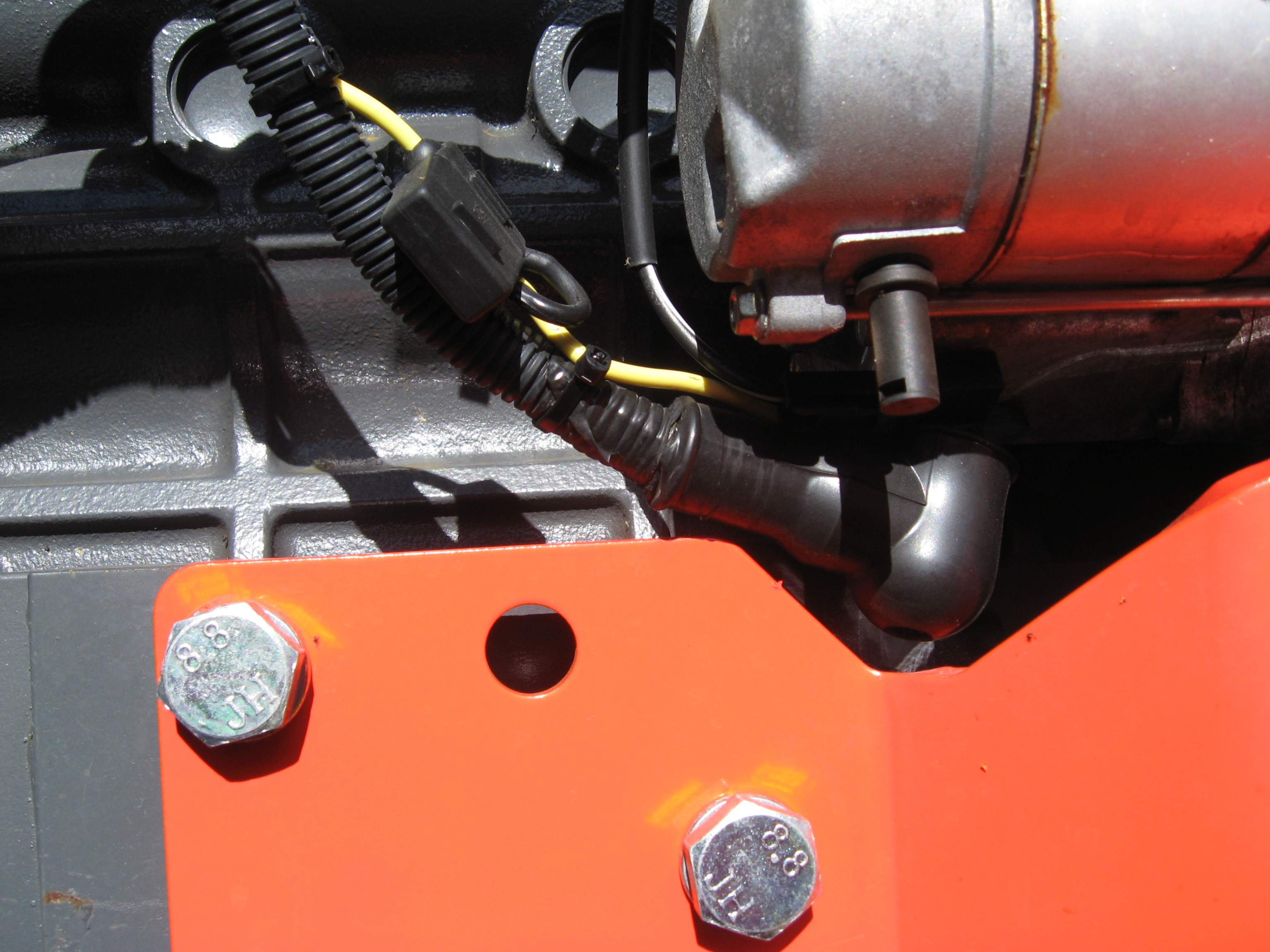

   / Wiring FIMCO 12V 40 Gallon 3 pt Sprayer L3940 #3
I mounted and wired a 7-way RV plug to the back of my L3940. The plug is full function, including constant 12VDC, which could power a sprayer (okay not brake lights or trailer brakes). Yes, I had to run a wire, but only to the starter, as the battery wire is already mounted to the starter. Install fuse, follow wiring harness to tail lights, and you are good to go. Philip.

   / Wiring FIMCO 12V 40 Gallon 3 pt Sprayer L3940 #4
That is waaay to professional looking:)

Is the small black box with the yellow wire running into/out of it the fuse?
yep that would be an ATC type inline fuseholder.
Thanks. Do some volunteer work around here for schools or sports clubs. Sometimes I need to put 2 or 3 implements on my main trailer and tow them to the spot of work with the tractor. Makes it nice being able to hook up the 7-way from the trailer to tractor. Even charges the break away battery.
Maibox, All these parts can be picked up at NAPA, or a local automotive shop. This would be a good project for a starter diy'er, fairly easy job. Need ATC in line fuse, wire terminal ends, wire, wire splice taps, bracket and plug, tie wraps, wire loom, drill and tap, and a few hours on a Saturday morning. If you need more detailed pics, just let me know.
Philip.

Thanks Phillip. About the only thing I'm not sure about is how to tie the wire into the starter wire--I assume you just spliced at that location and then ran it back?
   / Wiring FIMCO 12V 40 Gallon 3 pt Sprayer L3940 #10
No. Disconnect negavtive cable from battery. Find positive wire from battery where it connects to starter (see where yellow wire runs under black cap). Remove this nut, add new end connector and fuse holder here. Philip.
