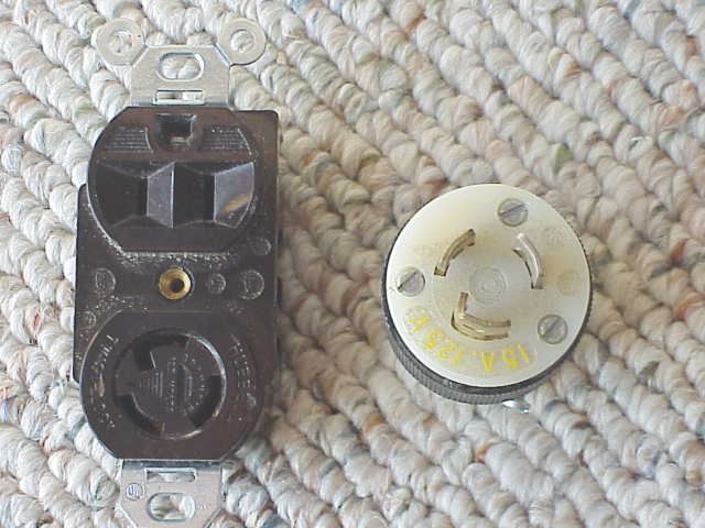

OK..... I am going to go out on a limb and hopefully you don't consider this a flame. Anytime you do an electrical job that doesn't conform to the National Electrical Code or the code that is in effect for the jurisdiction that you live, you are in violation. It doesn't matter what or how you label it. If it doesn't comply with the regulations, you are putting your homeowners insurance in jeopardy. If there is a fire, the cause of the fires doesn't have to be what you did that was improper for the insurance company to give you a hassle. I don't understand why people want to always re invent the wheel rather than to spend the extra few dollars to do the job right. I would guess that he paid at least $500 for the compressor and what is another $30 - $50 in material (if it is even that much) to do the correct wiring job the first time. It always amazes me that if a person took their car in to have it repaired and the technician did a patch job that was not up to standard, the person would be as upset as a wet hen. Then they themselves will go home and do a dangerous or substandard electrical job on the electrical system of their home that can lead to a fire or worse and consider it OK. You wouldn't accept a hack job from your tractor dealer, so why is it that you will do a hack job that will endanger your home and family. My family is worth more to me than any tractor out there, your should be to you also. Electrical wiring is not that difficult to do if you buy the $5.00 book and read it. If understanding what has to be done to do the job correctly is beyond your ability, then leave the job to a professional. Your life and your families lives depend on a safe home. Don't risk their lives to save a couple of dollars... If you don't understand the principles of electricity, then keep your hands out of the electrical panel. It would cost about $150 - $200 (my guess) to have a licensed electrician do the job. It will cost your family about $6000 to bury you if you get yourself electricuted because you didn't know what you are doing. Do the math.... Is your life worth the savings??

Junkman,
No ofense taken. In fact I agree with you.
I am just pointing out how it could be done and not cause a fire and or shock anyone. I never said it would meet code.
You will note in my message I pointed out that it was not the smart way to do this, and yes I agree one should always wire to code. If nothing else to not give your insurance company any excuses, not to meantion the safety of your family.
I am just saying that if anyone is determined to do this don't tie the neutral and ground togheter and don't run a 15 amp compressor on a 30 amp breaker.

This is an interesting thread. I guess you learn something everyday. So, if I read this right, it is illegal to use a plug that is over rated for the circuit? I cannot put a 20 amp outlet on a 15 amp circuit? How about a 20 amp switch on a 15 amp circuit? I have never heard of this. Thanks for the information!
/ Wiring 220V compressor #37
Interesting enough it appears that to be code compliant you can install a 50 amp outlet with a <font color="red"> </font> 50 amp breaker and use only a <font color="red"> </font> 10 gauge wire if the outlet is to be used by a welder? /forums/images/graemlins/shocked.gif If you want to read it for yourself, it is pages 785 to 788 of the 1999 National Electrical Code book. The NEC is written by the National Fire Protection Association. I believe that they know what they are doing!!!

Hi
Section 630 of the NEC is for Electric Welders. I checked my 1999 copy and see that they allow a calculation based on duty cycle to determine an adequate supply wire size. I don't see where it specifies a #10 conductor as stated above. Perhaps there is another reference in a separate section.
I suppose that this could apply to a plant setup where multiple welders are being used.
But why would I derate my own shop setup, and introduce a significant voltage drop ?? Just to save $10 in wire ?? I use #6, rated at the full 50A service, with the proper grounds. It works great and I sleep well at night !!

</font><font color="blue" class="small">( My compressor only has places for 3 wires. I was told by the "expert" at Home Depot to wire the green and white wires together and put them on the green spade.)</font>
That expert is wrong. Very wrong.
The white (neutral in the us) and green wire (ground in us) should be connected one place and only one place and that is at the service entrance panel.
I am not an electrician but I seem to recall the NEC specifically prohibiting using dual mode 120/240 outlets for 240 only appliances. I have no clue why, but I have been told that it is prohibited.
If you want to do it right, then I would suggest the same thing that the others have recommended, running a dedicated 240/15 or 240/20 outlet for the compressor.
On the other hand, let's remember who wrote the NEC and what its job is. It was written by firemen who don't want to see your house go up in smoke. The 30 amp circuit breaker on your dryer circuit is there to protect the wiring inside the wall to ensure it does not overheat and catch fire. Honestly, it is. That circuit breaker is not there to protect your appliances. It is there to protect the wiring and connectors. Connecting a 15 amp appliance to a 30 amp circuit "should" present no hazard. After all, how many of us plug in lamps wired with 18 guage wire (rated at about 6 amps) into a 20 amp standard wall outlet? You put a partial short in the lamp and the wire / plug will melt before the circuit breaker pops..
