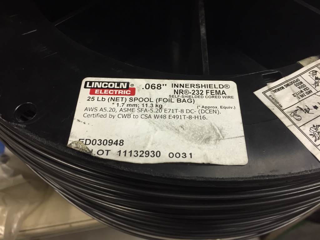

Currently about 2/3 the way through a 25lb spool of NR-232 and my tips are toast. The wire is .068 which apparently isn't a very common size. I have a new .035 liner and I'm thinking of shelving the 232 for a big project and then going to a smaller, more common wire. Dealer has suggested NR-211, but I wanted to double other opinions of this wire before I pull the trigger.
Looking for a all-position, flux-core wire. Low splatter and easy slag removal is important. Generally clean my surfaces before welding, but copper coated doesn't rust on the spool either.

Why are you running NR-232?:confused: That T-8 wire is required for seismic code work.

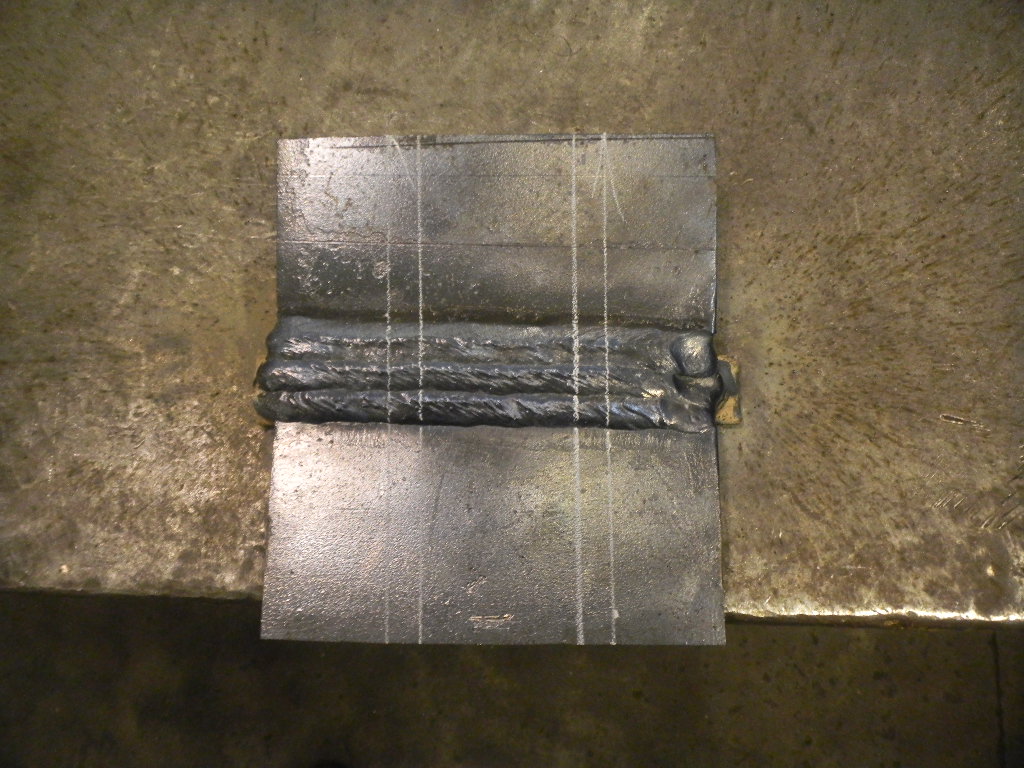

If you don't have to use a T-8 wire, and can use a T-11 wire. Go with Lincoln's NR-212. Or Hobart's 21-B.

212 only goes down to .045, but it'll do 3/4". Of course, 211 only goes up to 5/16" which is on the thin side.
/ Wire suggestions appreciated #5

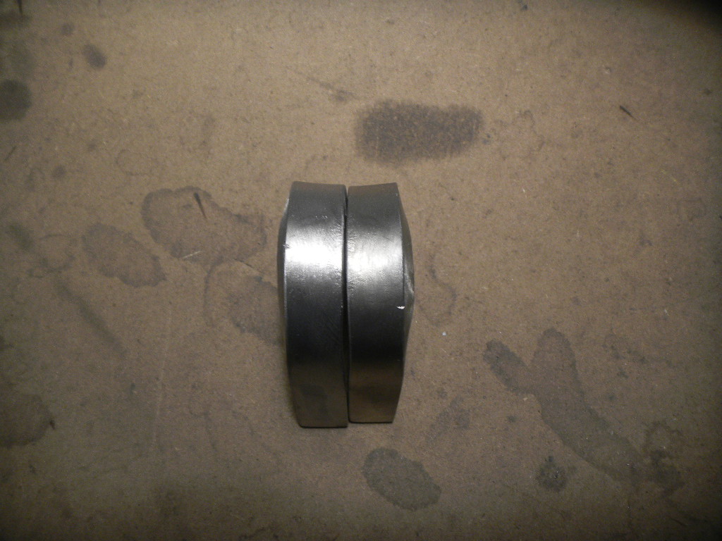

Before the Northridge earthquake in California, these wire manufactures did not put thickness limits on their wire. I can't tell how many 1-inch thick side bends tests I passed with Hobart's 21-B, and other T-11 wires. ;)
/ Wire suggestions appreciated #6

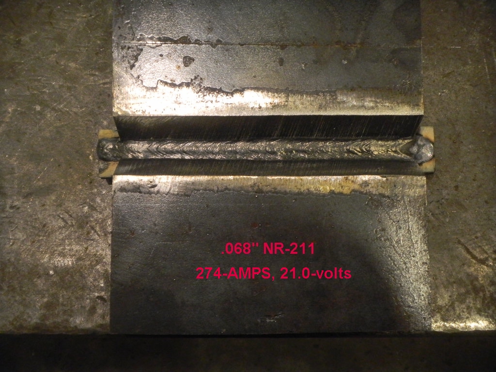

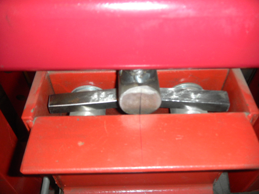

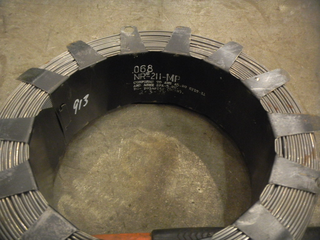

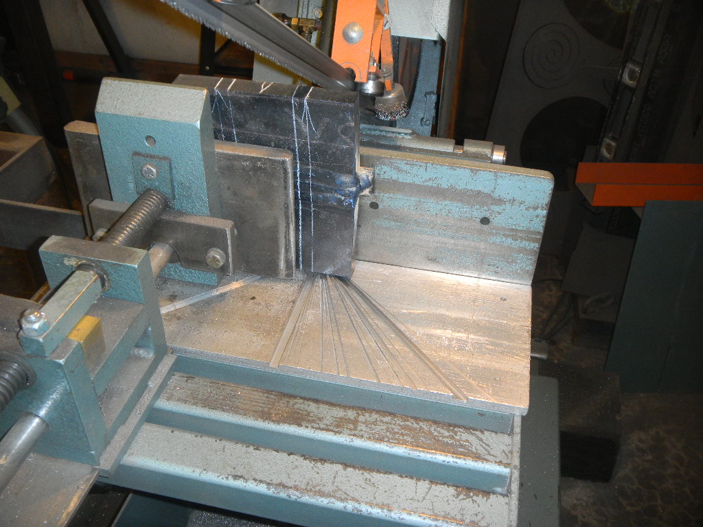

I don't know if that should bother you. My dad passed away in 2010, when I cleaned out his barn I found some rolls of NR-211 that I took off a job in the 1980s. The wire even had rust on it. Over the years several welding inspectors told me they never seen anybody pass a bend test with NR-211. So I thought I would try my luck at it. I don't remember if this was 3/4-inch thick plate, or 1-inch thick plate. :confused:

Do you need low temp impact strength? That's what the NR 232 has. If it's just general welding go with Shield Arcs suggestions. I've ran .068 NR211 and liked it. What gun and tips are you using? That may have something to do with your tips wearing too fast.
