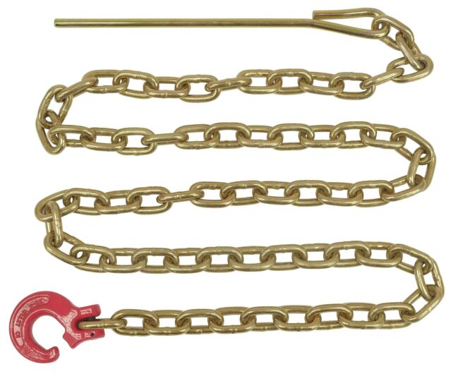

For getting your chain choker under a log, make a 16in or so 1/4 inch rod with an eye on one end, connected to one end of the chain.

For the log end, I prefer this style choker hook. I have not have any problems with it becoming disconnected from the log. Amazon.com
I don't know if this style can be found preinstalled on a chain you can buy. I had to change out the hook ends on mine.
edit: there is this choker chain with the hook preinstalled: Amazon.com

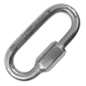

See my post #22, oval connecting link. This is an easy way to add a second grab hook anywhere in the middle of the chain, when you need to effectively shorten a chain for the odd job. I always have one or two either in my winch toolbox, or dangling from one of the chains I always carry.
Depending on the chain and the connecting link, you sometimes have to drop down one size to get the threaded bit to pass thru your chain's eye, if hooking in mid-chain. Since this method is almost always used when doubling the chain over to hook to itself, stress on that link is only half the load, so the diminished strength of a slightly smaller link isn't going to be a limiting factor.
