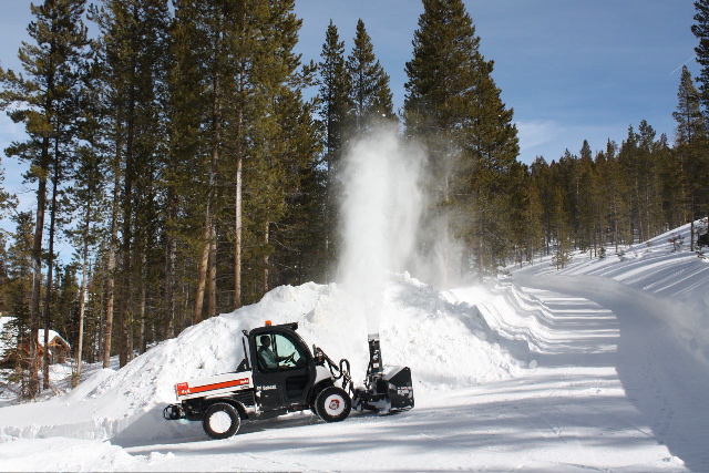

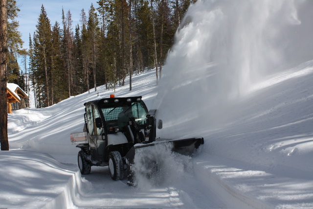

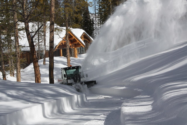

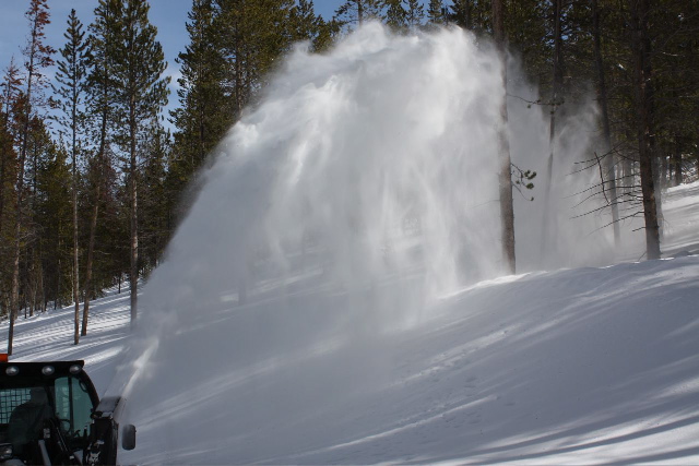

One of our fellow toolcatters wanted some photos of snow blowing and tires. Here they are. This was accumulation of 36" of snowfall over 10 days that settled down to about 22" by the time I got back up. You can see the X-ice tires. This snow was pretty dense, but not wet. This machine is a joy on this task.
