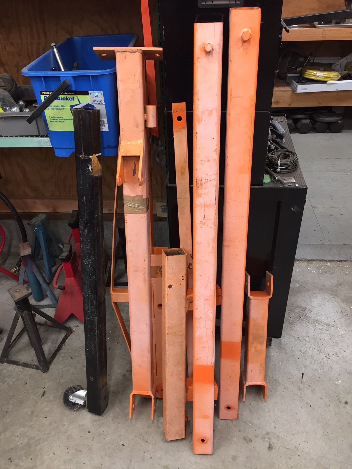

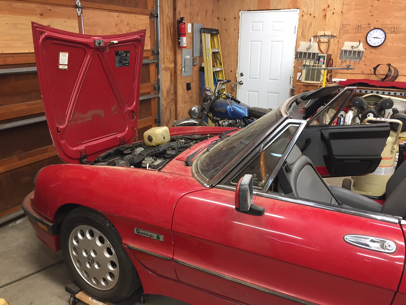

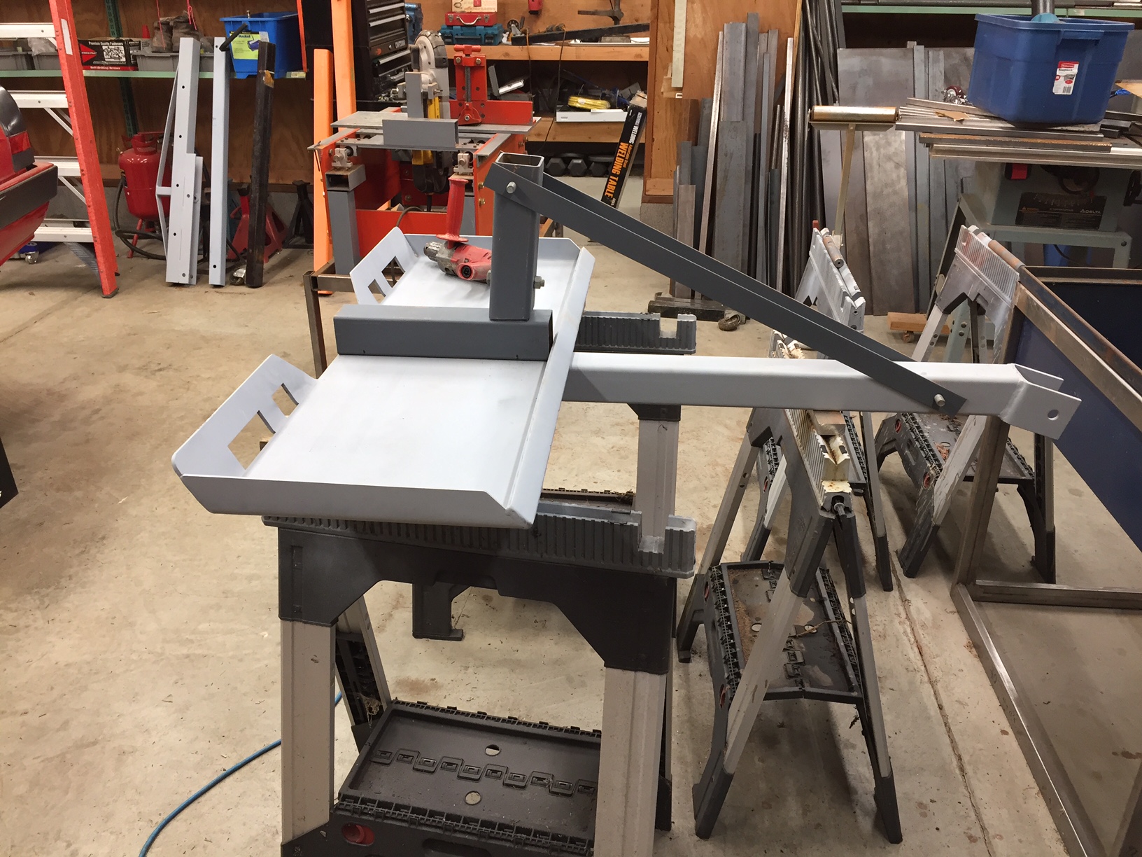

This past spring I finally installed a high efficiency propane furnace in the 900 sq ft shop on California's north coast, so I can work comfortably in the winter. I've been trying to tough it out but finally gave up. It isn't cold compared to the central part of the country but it is too cold for me. Now looking forward to a much more productive winter. First job is getting my wife's old sports car back on the road. Also my old Norton Commando. And at least one tractor project. I am going to graft my 30-year old Harbor Freight engine hoist onto a SSQA plate to make an adjustable jib. Already took the hoist apart and got started on the car.

I’ll be watching your engine hoist project. I have the 1 ton version.

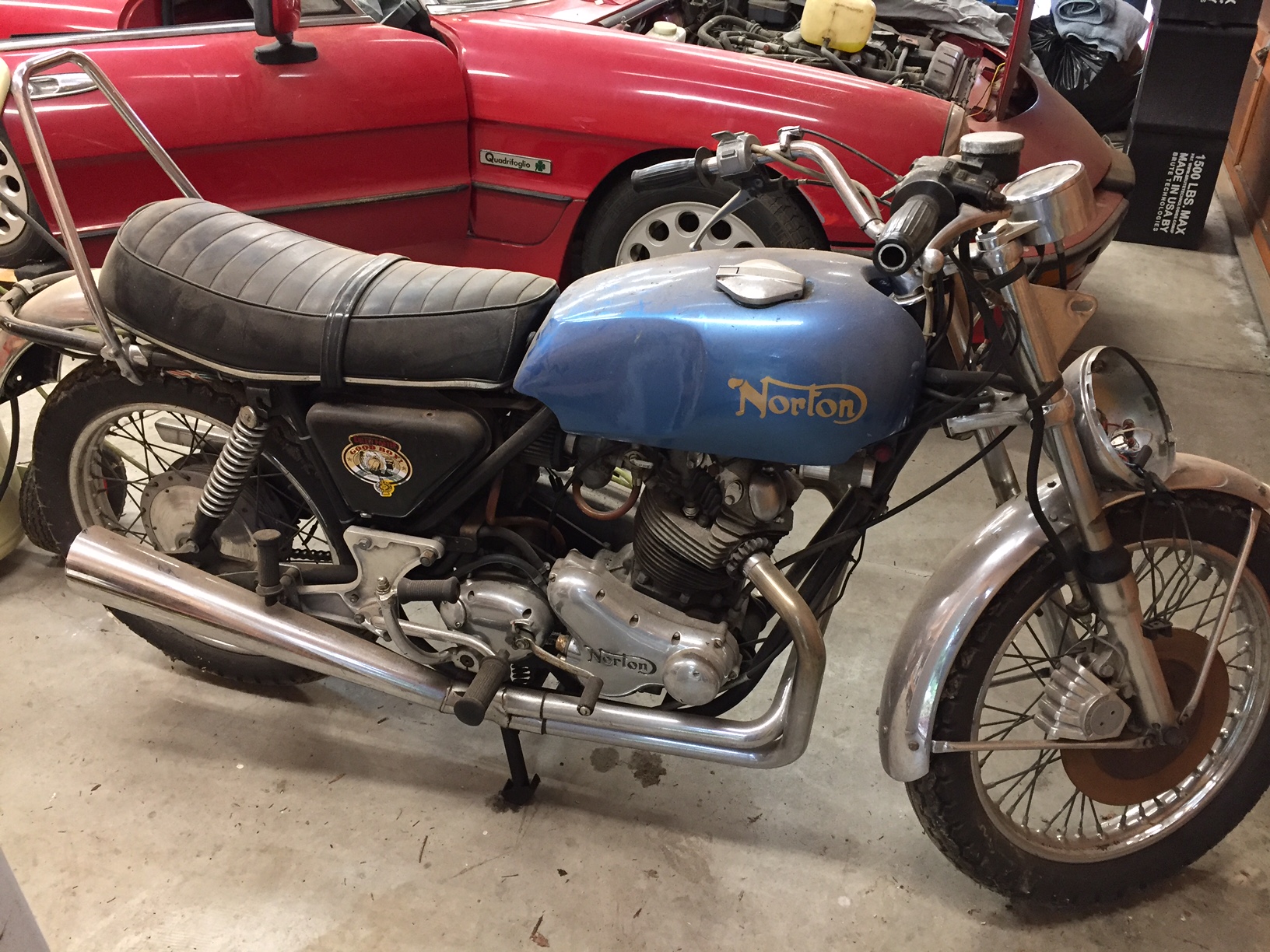

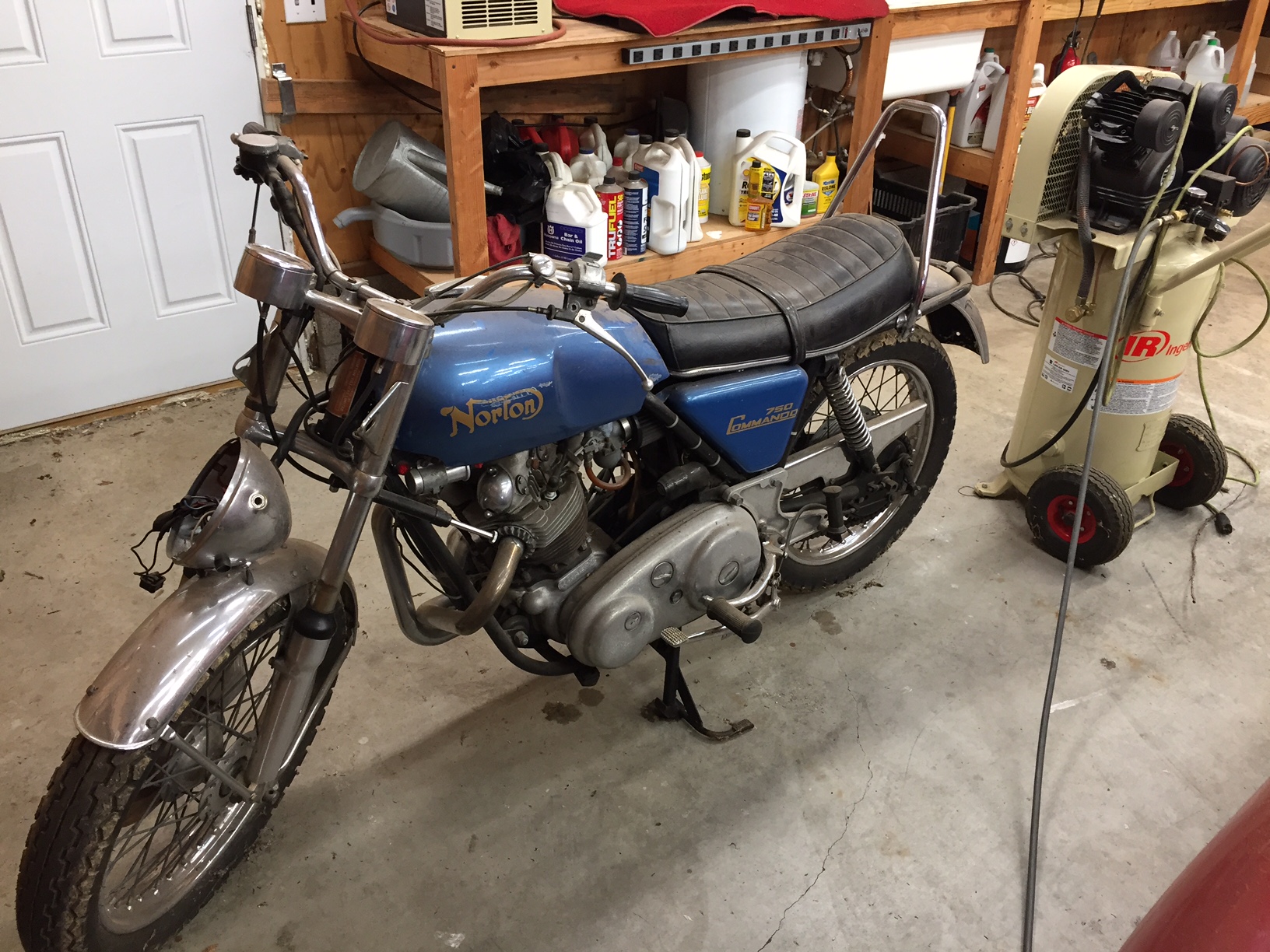

Norton pix. I am starting with the lighting, like all older British vehicles the electric stuff is marginally functional.

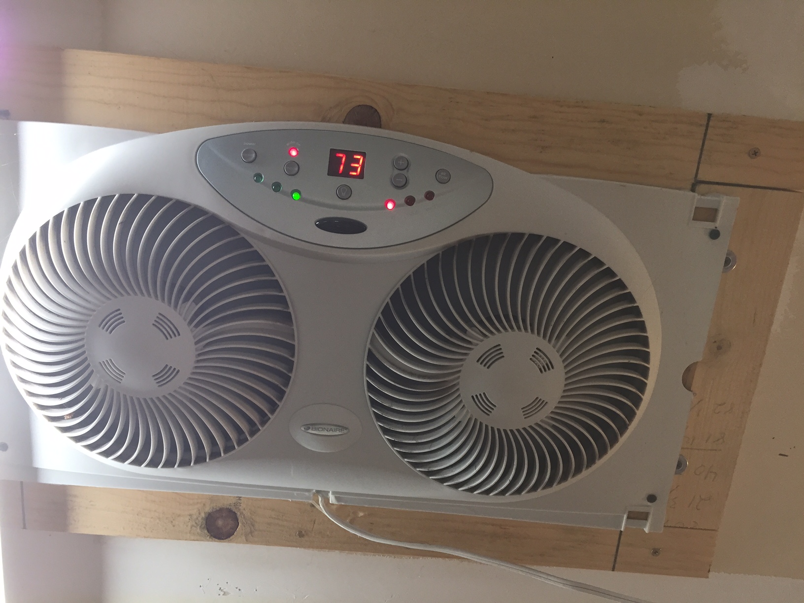

I don't use a wood stove, but for several years I got by with this fan in the ceiling. Above the fan there are two 8" sonotubes that go up to the peak of the attic. On a sunny day the air there is 105-110 degrees. The fan (a $50 window fan) goes on automatically and pulls the hot air down into the shop. It will raise the temperature to 60-70 degrees depending on outside temperature. IF the sun is shining on the roof. If the sun is not shining, it doesn't work at all. So I hope to limit use of the furnace primarily to December and January, when the sun is low in the sky and it is overcast most the time anyway.

Awesome!!! I on the other hand am already heating to keep my shop warm.
In my World the secret is to never let the shop get cold. My building and the concrete under it are kept warm all season. Then it's sooooooo much easier to raise the temp a few degrees. :)

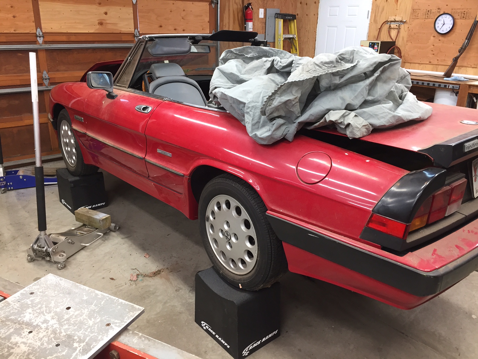

The red car sits just a few inches off the ground so working underneath is not easy. I don't like the idea of working underneath jack stands. I also don't like the idea of spending several thousand dollars on an automotive hoist. Looking through the Summit Racing website I came across these foam blocks. Never used to be anything like that, anyway new to me. They raise the car 12" which is plenty of room to work, and are very solid. And, they are made in Michigan with American-made raw materials.

So ..... why are these safer than properly rated steel jack stands?

I've seen some " properly rated jack stands " that I wouldn't trust a lawn mower on. I've got a set of 12 ton jack stands that I trust. I'd take his blocks over 98 percent of jack stands.

It is a good question one I have thought about too. Growing up we worked on cars a lot, and generally cribbed up under each tire with 2x and 4x lumber if we were going to do serious work underneath. That was completely stable and safe. Jack stands were OK for example when supporting an axle to do a brake job. I like these blocks because they are like cribbing except more convenient. Also, my jack stands (I have 4 sets) would be right at the top of their extended height to raise the car that much, probably not advisable. The blocks are rated for 1500 lbs each, the whole car only weighs 2300 lbs, so there is a good safety factor. And they cannot slip, bend or fall over. A couple weeks ago when planning the winter work I googled "jack stand failure" there is lots of bad news out there.

Got the tractor-mounted adjustable jib just about done. The whole thing is made from cut-off pieces of the old engine hoist. The only new parts are the two 5/8" bolts that hold the back brace, SSQA plate, and mast together. We are traveling to visit family for Thanksgiving, so will finish up when we get back. I will do a write up for Build It Yourself when it is done.
