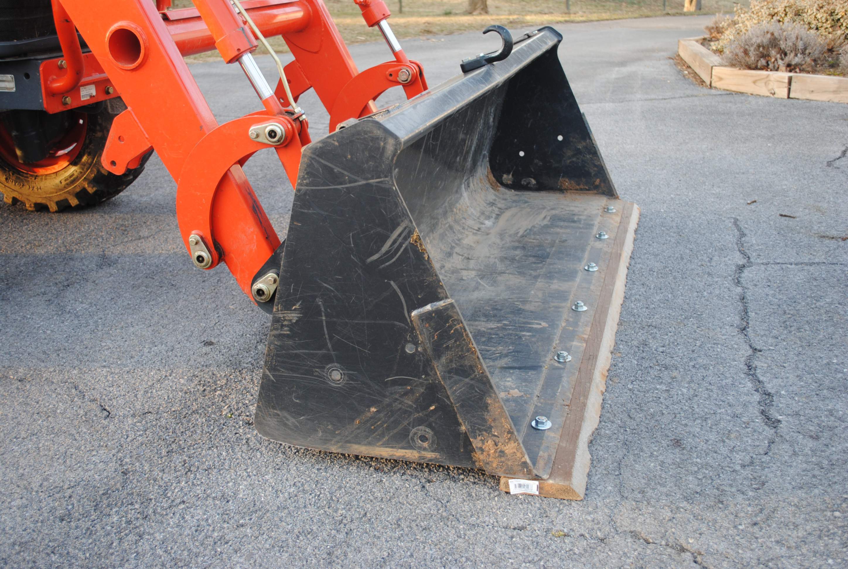

I used my FEL for the past two winters with no problems. Paved asphalt for last year. I added the clamp on edge protector fromm ratchet rake to protect the new pavement and it worked perfect. Right now thinking about a plow for the ranger 570 to take on the majority of snow clearing, and the tractor just to move snow banks back. (The ranger is a little more maneuverable).

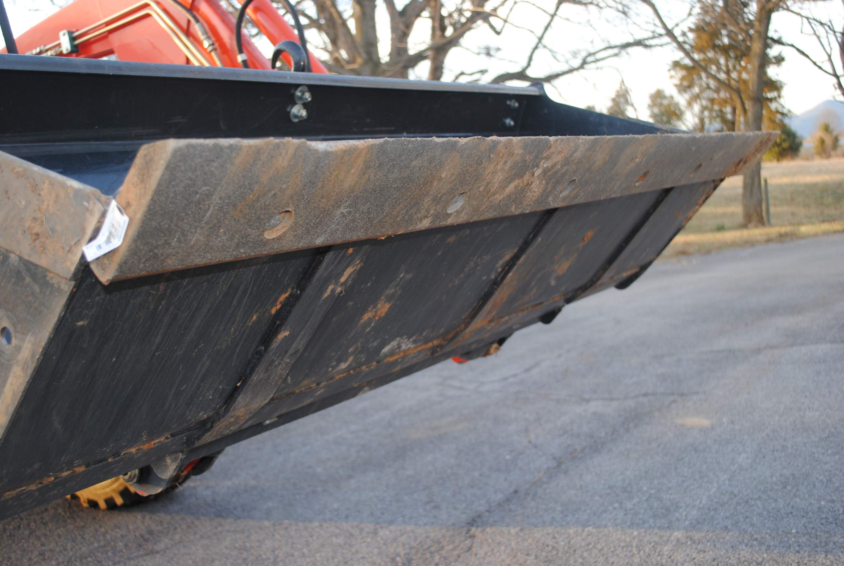

I use a length of 2X6 trex or composite flooring. Do an angle cut across the length of the board and drill holes to match the holes in the bucket. Then countersink the holes on the bottom side and attach to bucket with deck bolts. The composite lumber does not damage my asphalt driveway. Easy and cheap to make another one when chewed up.
