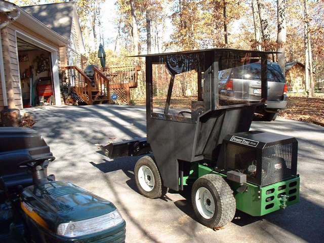

As requested I am reposting a few pictures of the cab I built for my old 180 two years ago. The first picture shows the custom rops that I built the cab around. It would be interesting to see someone build a modified version of this cab to work with their OEM PT rops.

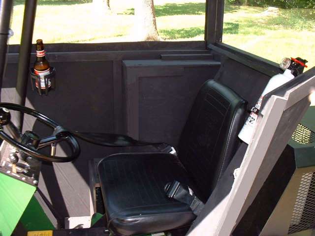

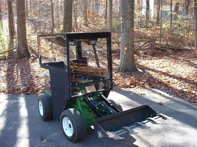

I posted this as an answer to Toy on the other thread should have put it here under Rivco's thread I guess, so here goes again. Between the two of us you should get some more ideas for your cab.
Not sure about the 1430 but, it was very tight in the back around my cab also. As you can see by the pictures I had to taper the frame for the articulation to just miss the back hood. I just took the side windows out during the summer and it was fine.
No wipers were needed as I had the front window striaght up and down along with the lip you see at the top. It kept the rain off of the windows just fine. You can also see an arm rest if you look. My right arm rested on that and the other on the knob most of the time, it was very comfortable working inside.
The front and back windows were made of heavy gage lexan the front window took a couple of hard blows from dead trees when working in the woods, it protected my face more than a couple of times.
This setup gave me more than enough head and arm room, I even had a tool box secured down by the right arm rest.
If I wanted to take the cab off. I had to take out the large front window along with about 15 bolts screws, and tilted it backwards to miss the ROP"S. I needed someone on the other side as it was a little hard to do by myself, then it came off. The floor and seat panels had to be taken out separately.
Toy has also built a cab trying to get him to take some pictures of his and post on here for everyone. I believe he has a 425.

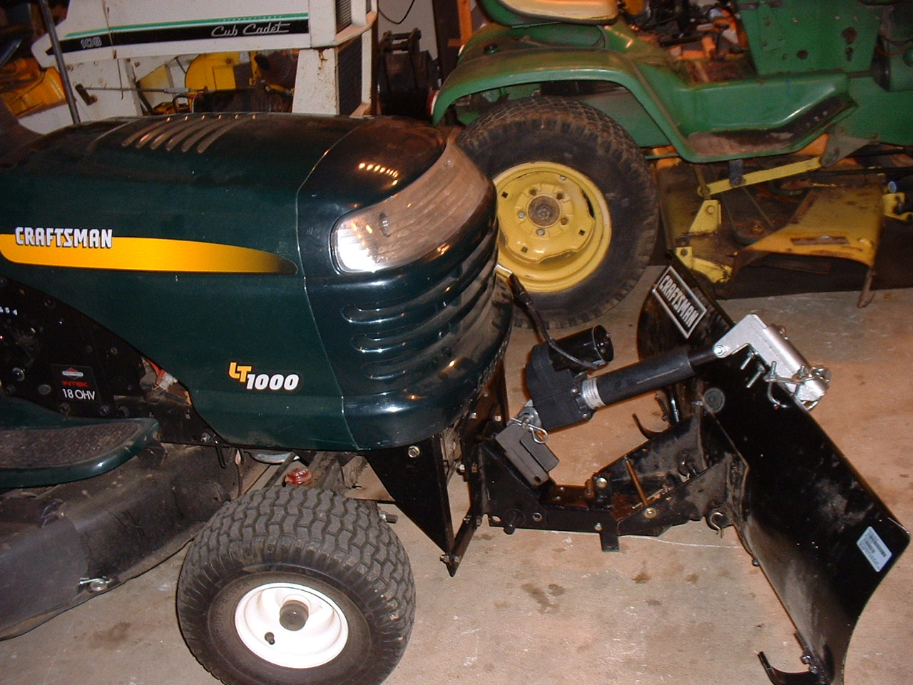

Plowing snow this year won't be anywhere near as fun. My new plow rig complete with chains ... :eek:

I have armrests on my PT425 (2001 model). With the seat all the way back, when I am in full articulation and oscillation, the armrests will rub the engine cover to the point that it moves the seat and/or tears the fabric off the "elbow" area of the arm rest. I would think a hard cab would require me remove the armrests and move the seat forward a bit in order to clear the engine cover in extreme situations. If I were going to cab my PT425, I'd do a solid windshield and soft sides and back with no bottom. I'd also install some sort of electric blower to circulate air inside the cab to keep the breath fog off the windows.
   / Winter Cab Revisited #8
Speaking for myself. I would say it just depends on how you build it. Mine did fine without a blower or wipers of any sort. I did leave a ¼ inch crack at the bottom of the front window for ventilation that could be closed off if need be. Other than that it was very closed off to the outside.
I think because of the head room and air space, it never was a problem. Windows never fogged and, rain / snow stayed off of the windows unless it was a sideways sort of rain. And I could still see fine. Now if I were to go with a soft plastic cab of some sort then a blower would be in order. :eek:
