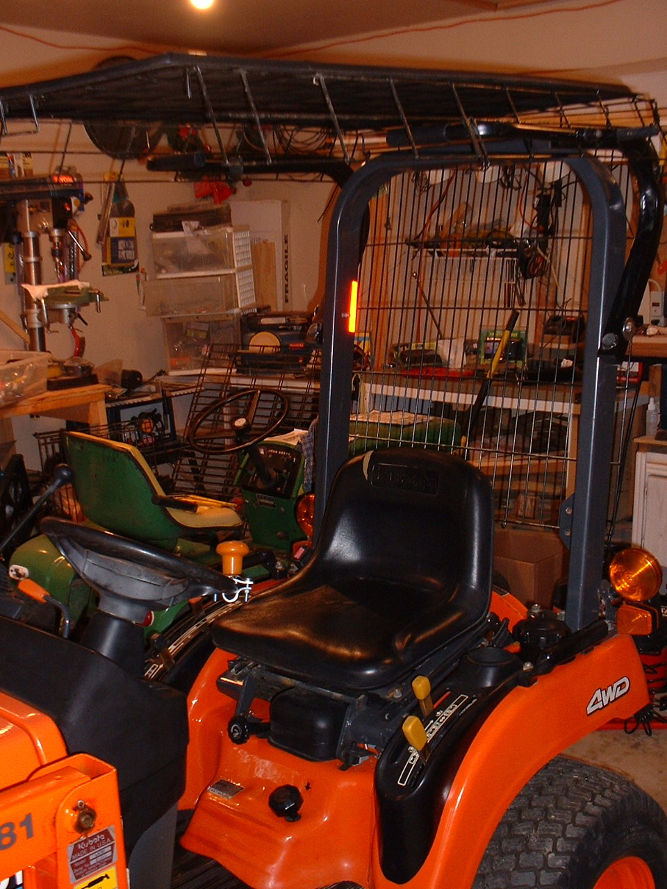

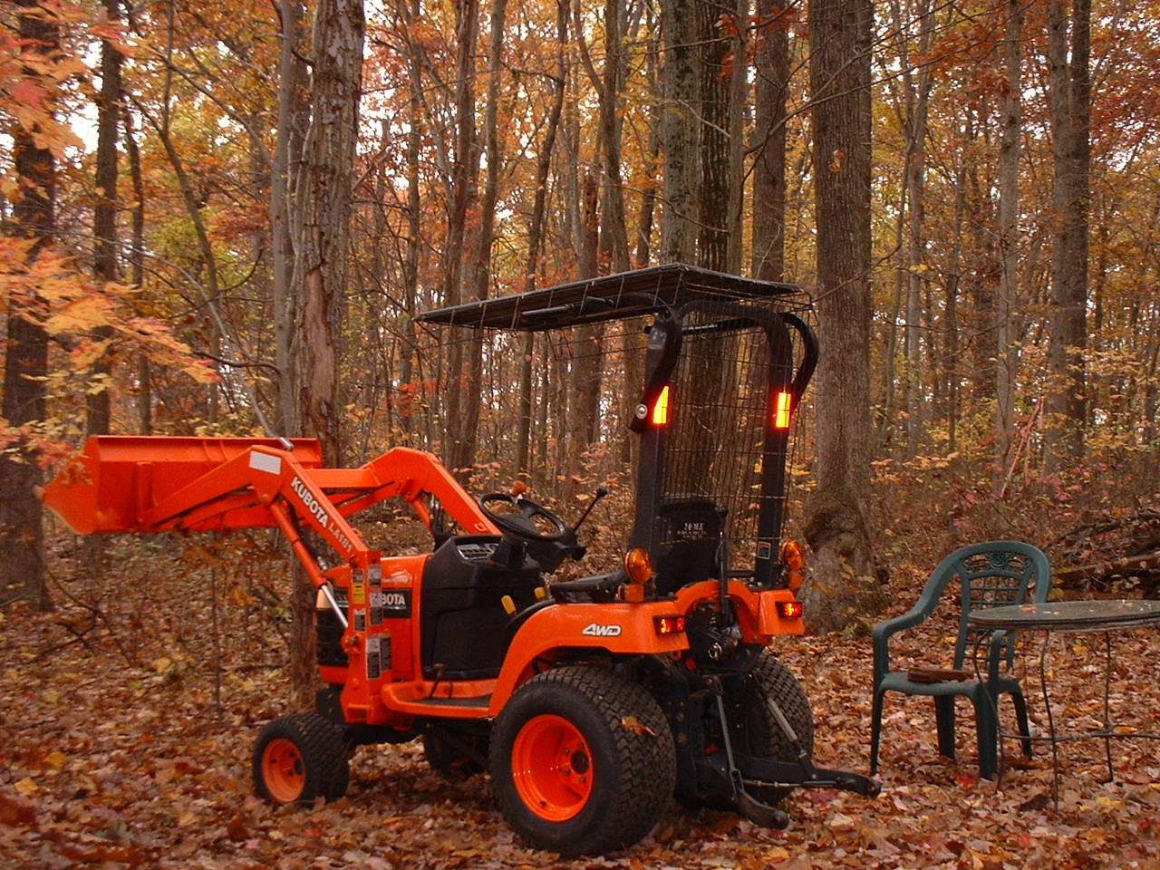

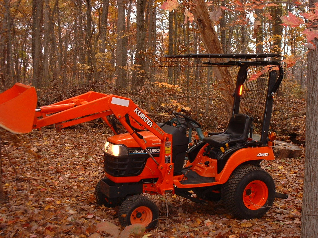

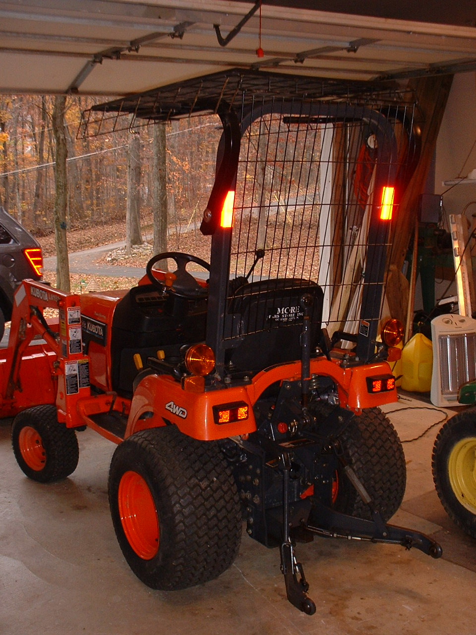

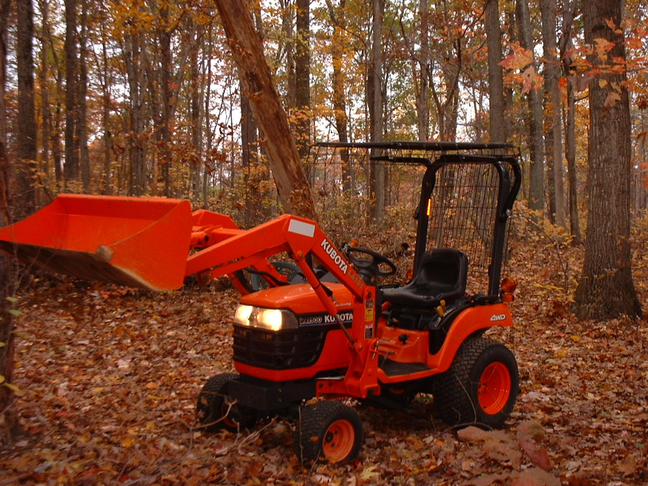

Rather than spend $260.00 for a canopy.
Here is my home made dog crate wire canopy. I'll be putting some plywood under the top for falling tree branch protection. I used two square tube arms off of an old work out station that was collecting dust turned the handles around and bolted them to the rops. It's pretty solid.
Used the plastic dog liner tray that came with the crate on top to keep the rain off. My golf cart cab got here Friday so will be adding that to the mix when the snow fly's. I may add more to the frame but it would take a hard hit right now the way it is. :) Now I need to hook up my new halgens to the top, one backup light then I'm pretty much set.
A few pics.
