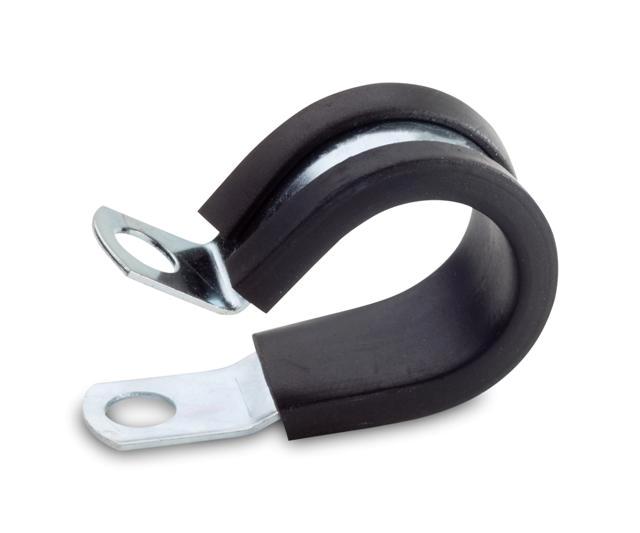

If you don't mind an hours worth of work, it's very easy to make one with a piece of clear plastic and some cheap pipe clamps. Not nearly as pretty as the ones you buy, but about 1/3 the price. Go off and on easy too.

I have a Gator XUV that needs a windscreen but I don't really want to spend $700 CDN for a Lexan one which is what the dealer wants. I am debating whether to do the same as MMagis suggests and get a sheet of plexiglas and some p-clamps and make one.
You would probably need to heat up the bottom edge of the plexi and curl a lip into it to give some rigidity, otherwise it will vibrate bad.

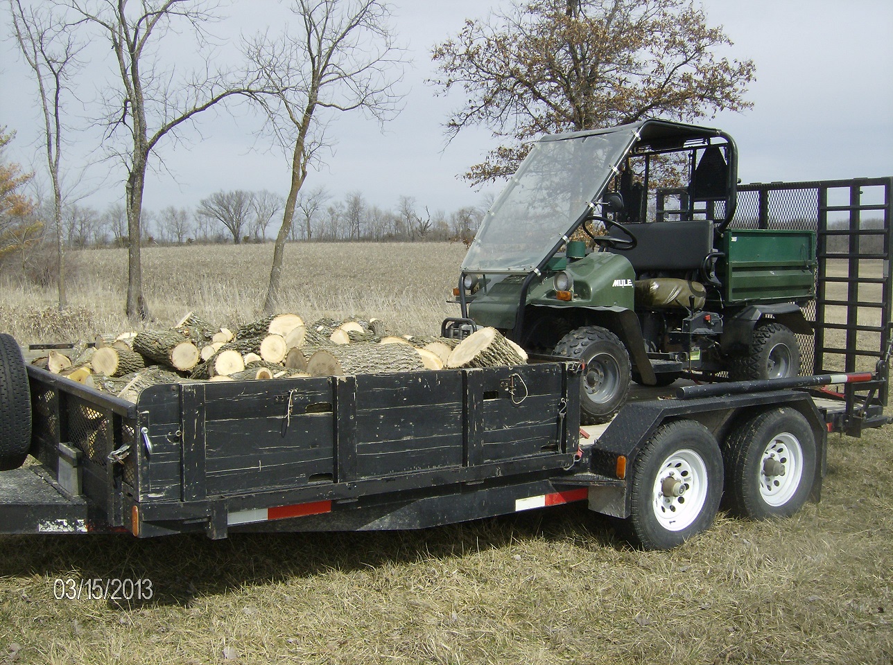

I used 1/4" Lexan on the 550 Mule I used to have: HPIM1088 - Copy.JPG When I bought the '07 "TS" Gator, it had a partial aftermarket windshield on it, I added Lexan to extend the top with aluminum double channel for strength: HPIM1205 - Copy.JPG

It’s been a while, but I think mines no thicker than .150”. It’s worked quite well, plenty thick enough. If you’re able to get clamps all around it, I think .125” would be okay.
