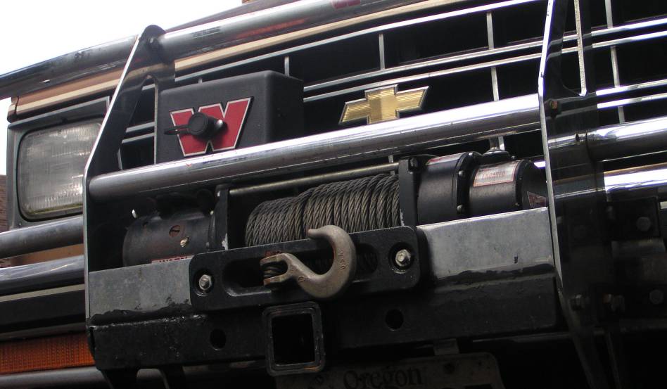

/ Winch wiring #14
Your choice of connections would depend a bit on how much you wish to use the winch with the trailer.
I added a receiver to the front of my Blazer.
Made with a piece of channel iron, and a receiver tube.
It is more securely connected to my winch than my winch is connected to my bumper or frame.
Anyway, so all I do is insert a drop hitch.
Pull up to the trailer and hook on.
The advantage of the hitch is that I now have control of the trailer.
And I have a great multi-purpose winch.
I haven't used it with a tilt trailer though.
