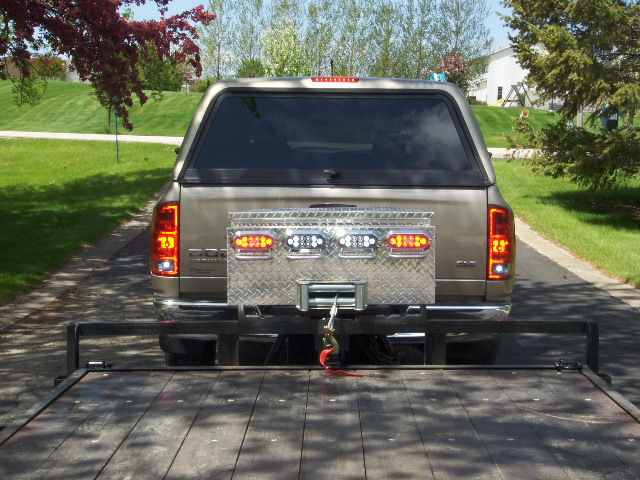

Here is what I just finished after working on it for over a year. I wanted an electric winch for my 18' flatbed trailer, but needed it to be protected from weather and theft plus be removable for use on my truck receiver hitch.
What I came up with is the following. The winch is a 12,000# Atlas with a corded hand-held controller plus a wireless remote. The box is mounted on a 2" solid steel receiver draw bar. The draw bar slides into a 2" receiver that is welded on a steel platform on the front of the trailer A-frame. This is all heavily reinforced to handle the worst possible stress while winching.
There is an Optima blue-top secured in the box to provide stand-alone power, and it can recharged from the truck batteries through a switched connection.
There are also red LED stop/tail/turn lights on the rear of the box to provide additional visibility, plus white LED backup lights that can also be turned on separately for night loading plus strobe as emergency lighting for roadside protection. These white LEDs backfeed into the truck backup lights (also LED) to provide additional lighting and strobe capabilities.
The box is quite heavy and takes two people to move it safely (hence the numerous handles). However, I use my forklift to move it when I'm alone, and it will spend the vast majority of the time living on the trailer which is parked indoors.
Here is a link to a video of the strobes in action. I hope this post is helpful and maybe inspires ideas for your trailer winch setups.

Blast Chamber, you were wise to install the structure for the winch. That 12K has some real power and as I found out, when the whole front of my trailer flexed, just what it takes to contain those things.

Blast Chamber and wkpoor, Both very nice projects,
The ideas and outcomes on this site are so helpfull and inspiring.
Keep them coming:D
