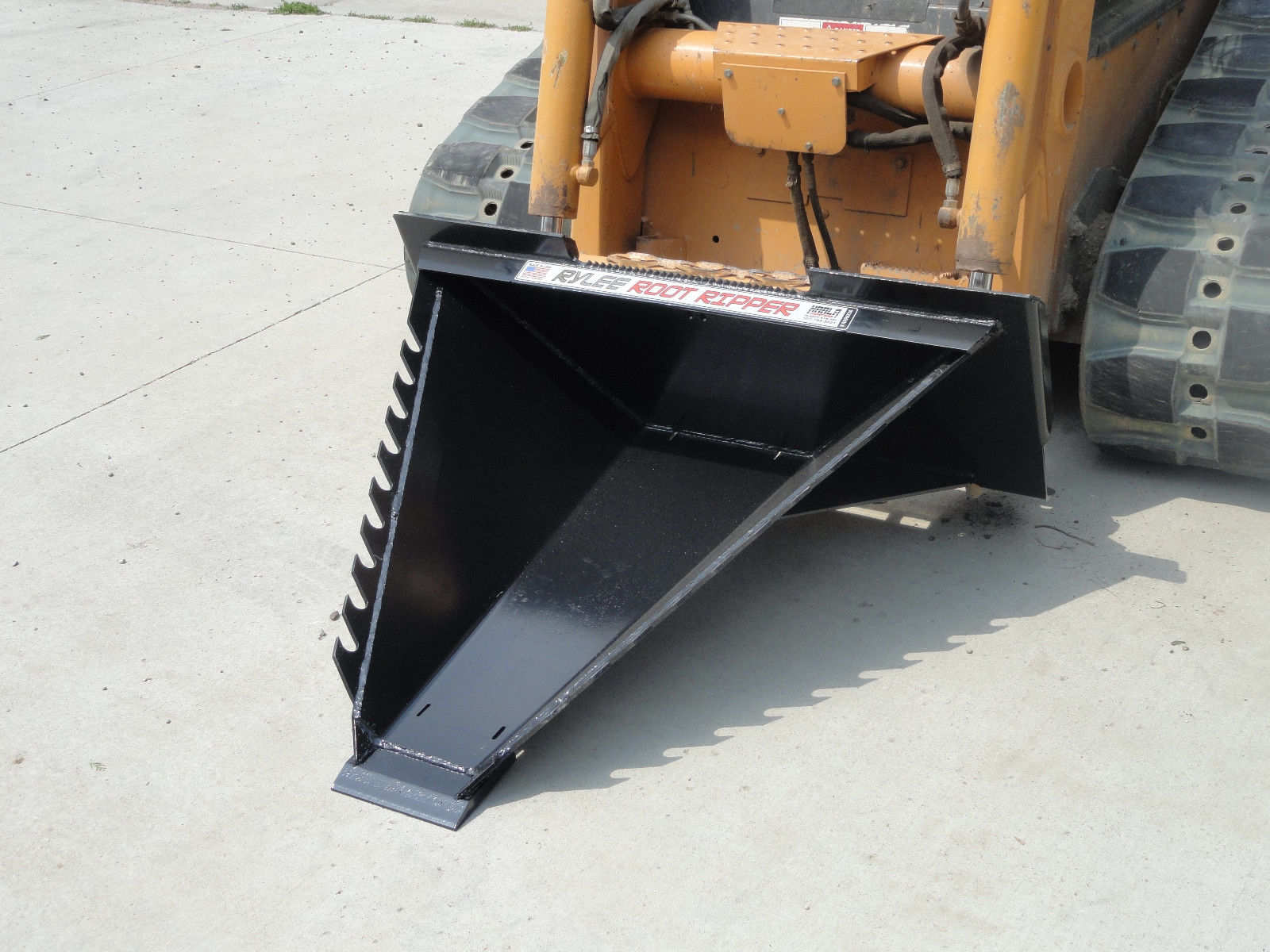

I agree, that bucket attachment spade could damage the bucket with enough force. I'd opt for the QA spade for not much more. ($465 plus ground shipping for the one I pictured). Other QA spades are available from other companies as well.
