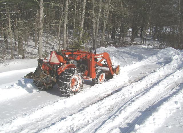

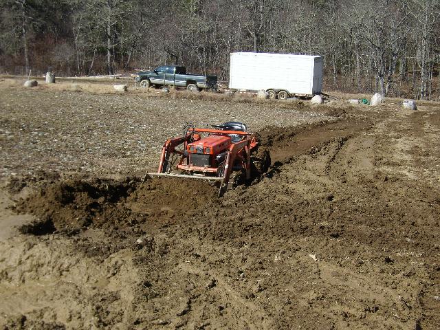

   / Will chains help much on snow? #15
A chained up turf tired toy tractor working in mud and snow. The chains help on either mud snow or just dry ground!:D :D
