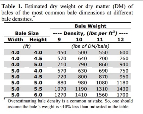

FYI:

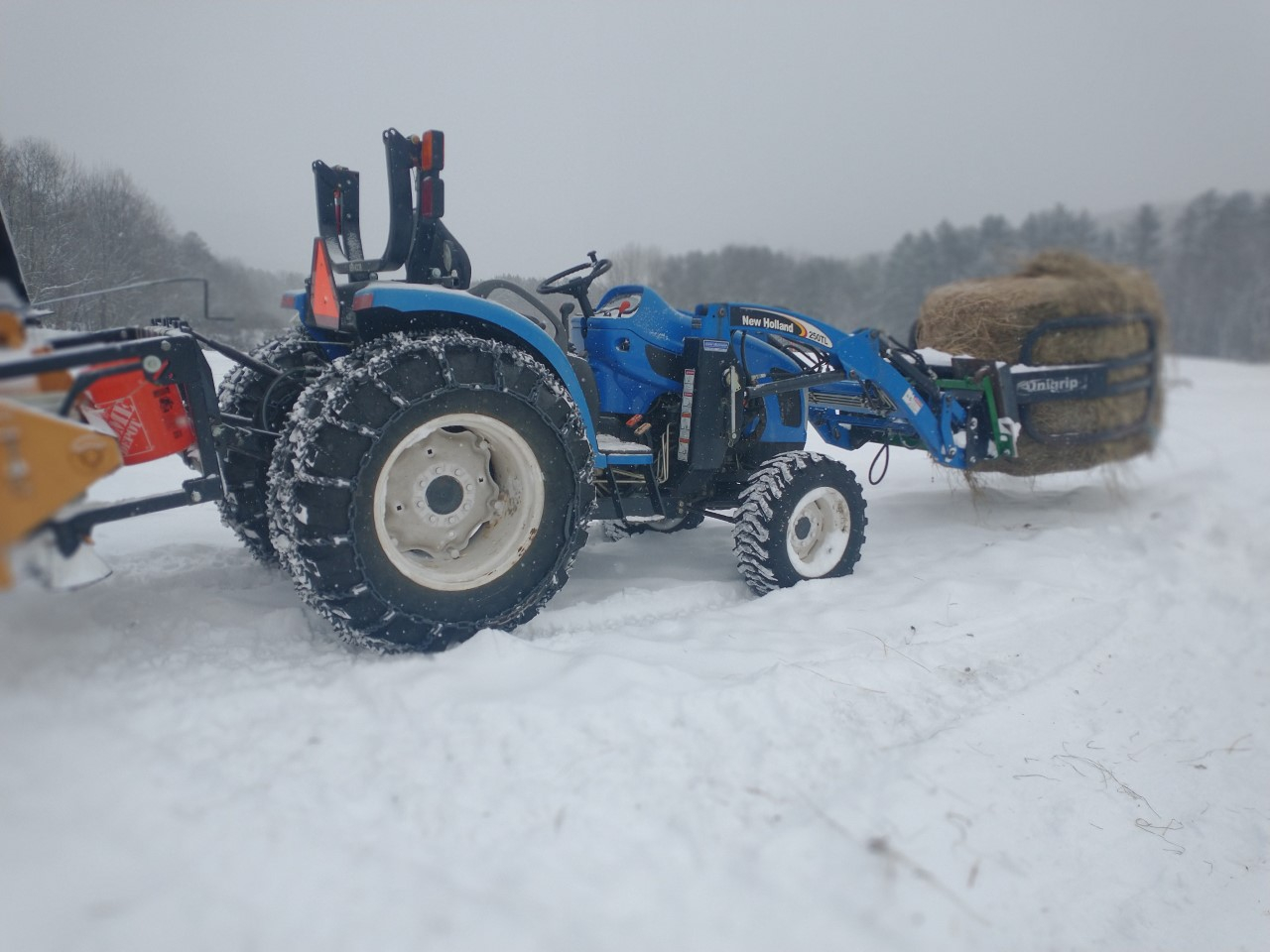

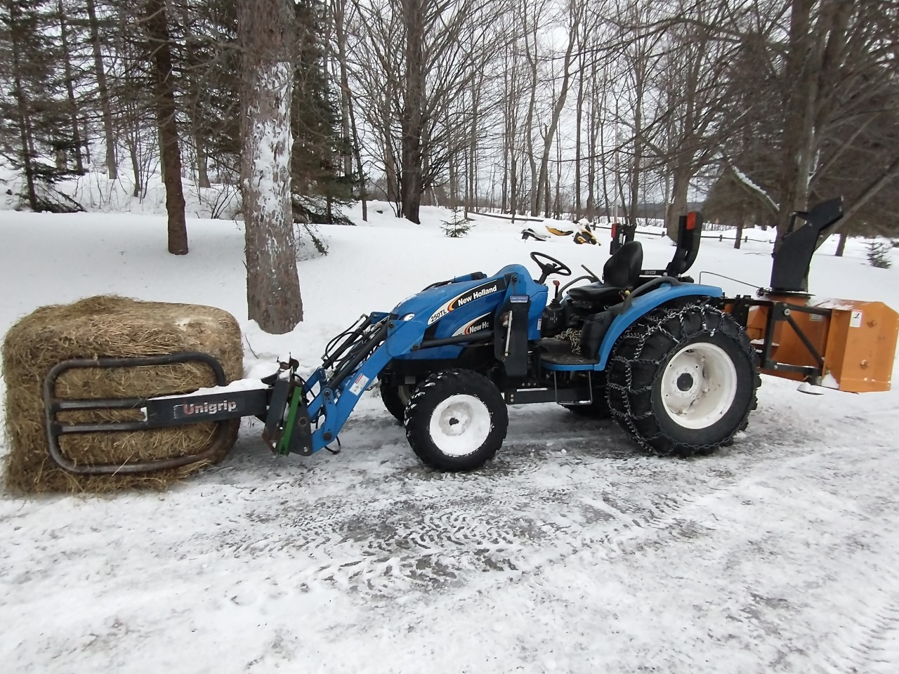

4' x 5' bales that I have been dealing with, moisture makes a big difference & my "bar" is lifting it over my round bale hay feeder. Some of these heavier ones I have to give it the 'momentum' UMPH back and forth while the hydraulics are lifting to get the loader arms up that high...
BTW... I'm using an adapter plate Skid Steer to JD which adds weight and some mechanical disadvantage & it's a very heavy duty bale grabber meant for much larger tractors so the overall poundage & mechanics is working against me. Thus said - Yes, one can, if properly ballasted in the wheels & w/ a heavy 3pt. hitch attachments, - use this tractor for round hay bales, imho... (with extreme care)
