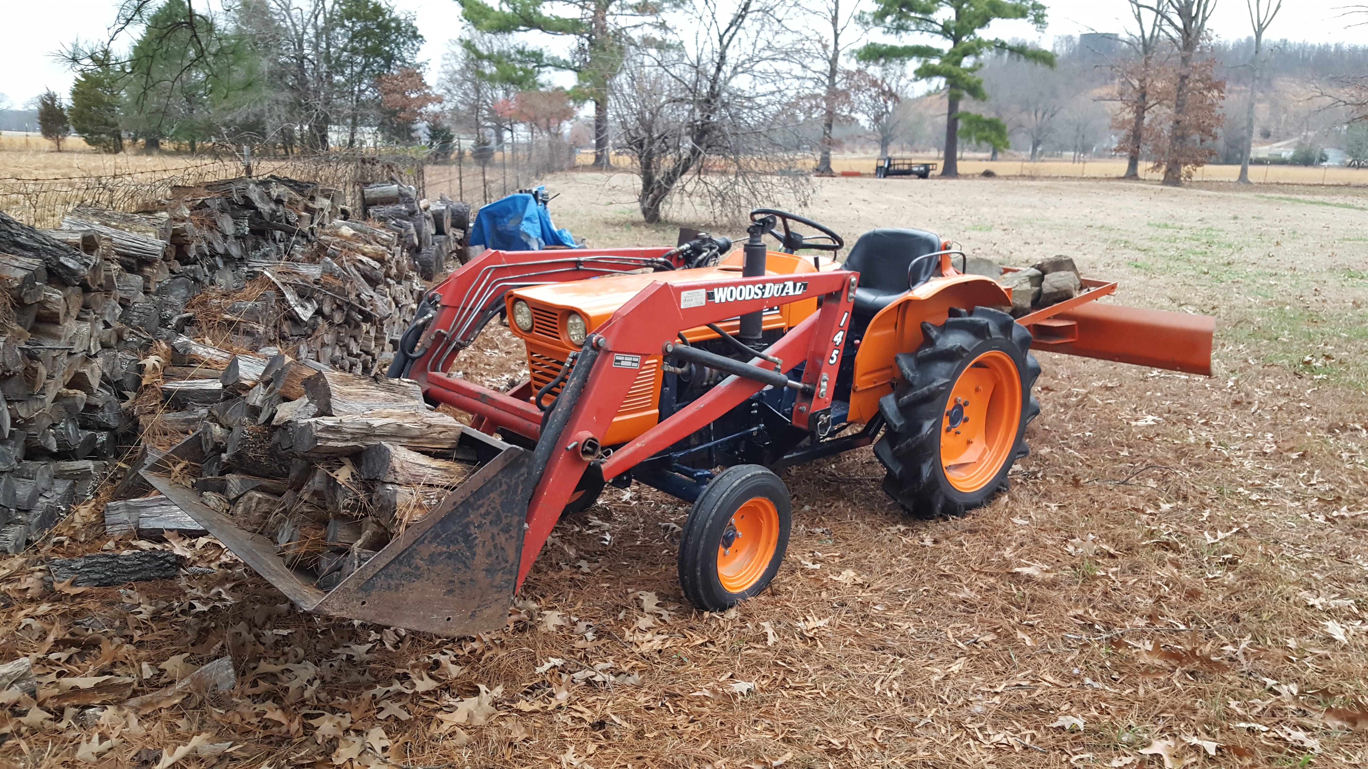

Got a chance to pick up a Woods DuAl loader off a Massey 1010 for a pretty reasonable price. Will it fit my old Kubota L1501?
   / Will a Massey loader fit my kubota? #2
It will with the RIGHT bracket kit...
(Assuming they are similar sized tractors)
SR
Thanks buddy. Picked up the loader. Since my tractor is a 35 yo grey market, purchasing the correct subframe will be out of the question. Gonna have to break out the welder :)
   / Will a Massey loader fit my kubota? #4
Welder and torch make most loaders fit most tractors
   / Will a Massey loader fit my kubota? #5
If you decide not to modify the loader I have a 1010 and I would interested in the loader
I won't have to modify the loader. Just gonna have to build a subframe to attach it to the tractor. Will have to splice into the hydraulics on the tractor as well. Won't be fast but my back will sure thank me :D Been looking for a loader for a couple years now. Will be a nice winter project :)
Finished up building a subframe and got the loader installed and tested. Course after testing it, the first thing I did was hook up the back blade for ballast and filled up my wood rack :cool2:
   / Will a Massey loader fit my kubota? #9
Nice work! As my buddy Jason says, 'We got welders, torches, and grinders... we can make anything fit everything!'
   / Will a Massey loader fit my kubota? #10
That wood looks to be well seasoned.
