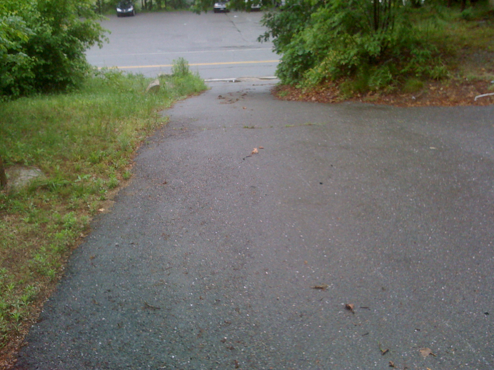

The driveway is a half mile long. Other duties for the tractor besides snowblowing would be using a rotary or flail to keeps the weedy sections tamed down the edges of the drive, grappling to keep the grounds gorgeous and manicured, and to use for whatever else might pop up.

Well Orange Muscle in the Mid Hudsun Valley if your driveway is actually 16 degrees which is quite steep;
Results:
An angle of 16 degrees converts to:
28.67 Percent of a Slope
I doubt that you will be traveling it safely without chains,
my driveway is not paved it is 14 to 16 degrees or up to 28% slope.
With the wet snows that we get I require studded snows on all vehicles that reside here.
I have used most every variety of chain made for trucks or tractors the bar reinforced 2 link spaced chains are good,
however they are a long way from the best, the Euro style studded chains are much better (there are numerous threads here on chains).
When chains are used the best gripping chains will provide traction without spinning, the spinning is what tears up driveways.
All of my snow removal equipment is chained most of the time for my drive.

I agree with Lou.
I spent most of my 62 years in northeast Dutchess County. Plowed snow for a Dairy Farm in the early years, a 1/4 mile driveway with moderate slope the last 29 years and various neighbors driveways along the way. Get chains before winter, have them installed, leave them on. 4 link will probably be adequate, 2 link will ride much better, grip better and spin less. Ice is a concern in your locale as is rain falling on packed snow. You are fooling yourself thinking you can do without tire chains.

OP, 1/2 mile long would be enough for me to consider a bigger cabbed tractor.. You will need chains regardless of the size of the tractor.. Every winter the conditions change, more ice some winters than others.. At the very least you will need 2-link latter chains.

:drink: In all other conditions, I'm right there with ya Vaquero. But if your steering wheel is (effectively) removed, and your tires are (effectively again) bald and dipped in grease,
there's not a lot of driver input. Cowboy's or Indians, bullets or arrows the skill with snow & ice come's in assessing your approach.
It's "glossy" looking because it's ice.:D

I have sloped driveway and BX w/ front blower.
Don't need chains most of the time. But when when mother nature decides to drop the temperature and rain turns to snow with an ice base do need chains to get back up the hill.
