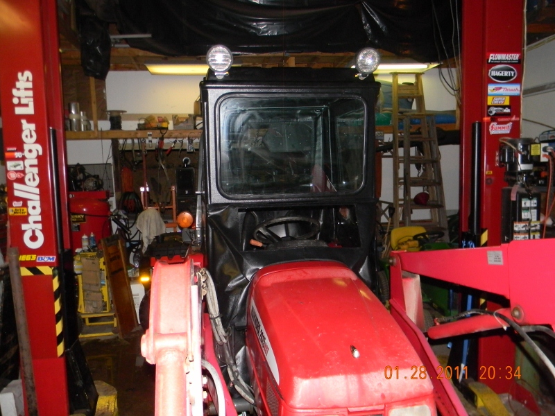

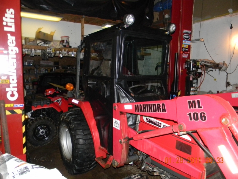

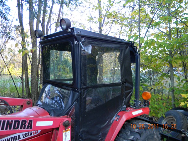

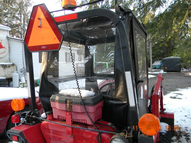

Hi Bill,
Check with RJPartsco.com website.
I bought a cab with glass windshield from them for about $900. It has soft sides and back and the doors lift off for summer use. I bought it before last winter and it worked great. I also added a new RoadPro RPLS-681 Ceramic heater from Ebay for another $50. and stay nice and warm plowing snow. Total was under a grand.
The cab is not listed but the 2816 is the same and is an exact fit for our 2615. The site shows it for $709. plus the cost of the glass windshield option. You can also get driving lights and a windshield wiper if you want.

Wow that seems pretty cool. I want something better than the lame golf cart type set ups but less than a $4000 cab. The Sims cabs are nice but not that great for the money. The windshield is glass but the rest of the panels are just vinal & pleather. The roof is steel though but I'm sure it is a pain to remove everything for the Summer. The one you have looks like it would be "good enough" for the Winter but cheap & easily removed for the Summer. Thanks for the info. So it has two doors that open?? :drool:
   / Will a Cub Cadet cab work on my 2615?
You have really sparked my interest with this George. Can you take some more pics? I want to see how the back is set up, the inside, how it seals around the gas tank & loader valve, etc. Did you put something on the floor to cover up the holes? I was thinking bed liner mat would work pretty well. I think I am going to put in a small heater out of a car from a junkyard. Does it stay "warm" in there or it just isn't as bitter cold & windy?? Do you wish you has a windshield wiper or is it fine w/o one?

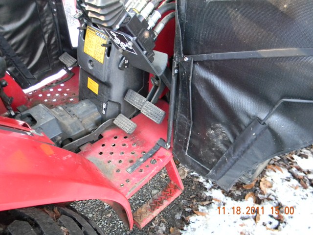

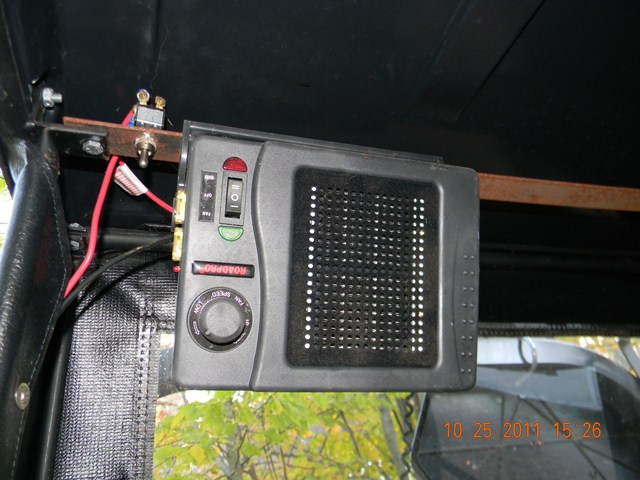

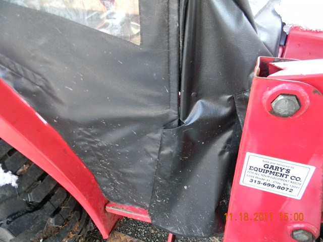

   / Will a Cub Cadet cab work on my 2615? #6

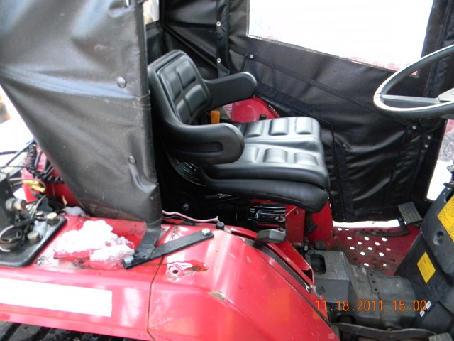

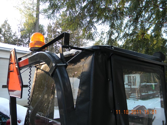

Here's a few more.
The back is tucked in front of the fuel tank and behind the seat. It attaches with snaps so it could be removed in summer as well as both doors.
It has a tube frame and bolts up to exiting holes where the grab handles are (you have to remove the grab handles) and holes in the floor.
The front cowl tucks under the windshield and wraps around and uses velcro to attach to the door panel.
I did not buy the wiper pkg. I figured if I needed it I could order it later. For now I throw some clean snow on the window and use a long handle squeegee to clean it off.
I did not cover the floor holes. I would have but the heater keeps it plenty warm for me.
The roof is fiberglass. I only removed my doors for summer and it worked great. The roof gave me shade on hot days. The back can be unsnapped and removed but I left mine on. If you want to, the entire cab can be unbolted and removed by undoing 12 bolts.
I went with the RoadPro heater because it was easier to install. Again, I figured if one heater wouldn't keep me warm I have room for a second one on the same mount bracket.
There isn't a lot of room for a 12V car heater that has to be plumbed in with hoses and power.
I also added roof lights, a strobe light, and just last month bought and installed a suspension seat.
All total (cab, lights. strobe, heater, and suspension seat) cost me about $1150.
Cab with windshield is from RJPartsco.com (about $900)
Road Lights and strobe from NAPA (about $100)
Suspension Seat with adjustable slide track from smartfarmer on Ebay for under $100 incl. shipping (search Ebay for universal tractor seat)
RoadPro heater (under $50 shipped) also on Ebay.
I think the wiper kit was another $175? from RJParts if you want it.

How do you like the suspension seat? WHy does it look like one butt check of the seat it higher than the other??

Rear window is fine to look out. Just have to be careful washing and cleaning it so it doesn't get scratched.
Main reason I bought the cab is to keep the cold winter wind and blowing snow off of me. Now its more enjoyable to plow. I hated plowing dressed up like the abominable snowman just to keep warm. Before having the cab my fingers nearly froze, now I don't even wear gloves in the cab. You'll be happy.
The seat is an optical illusion. Both sides are equal with a raised ridge in the middle. I like the seat a lot. having a spring suspension is better than none.
I've also had the plastic piece under the wheel off. There's not much room behind it for any hoses. I barely had enough room to mount some toggle switches for the lights.
