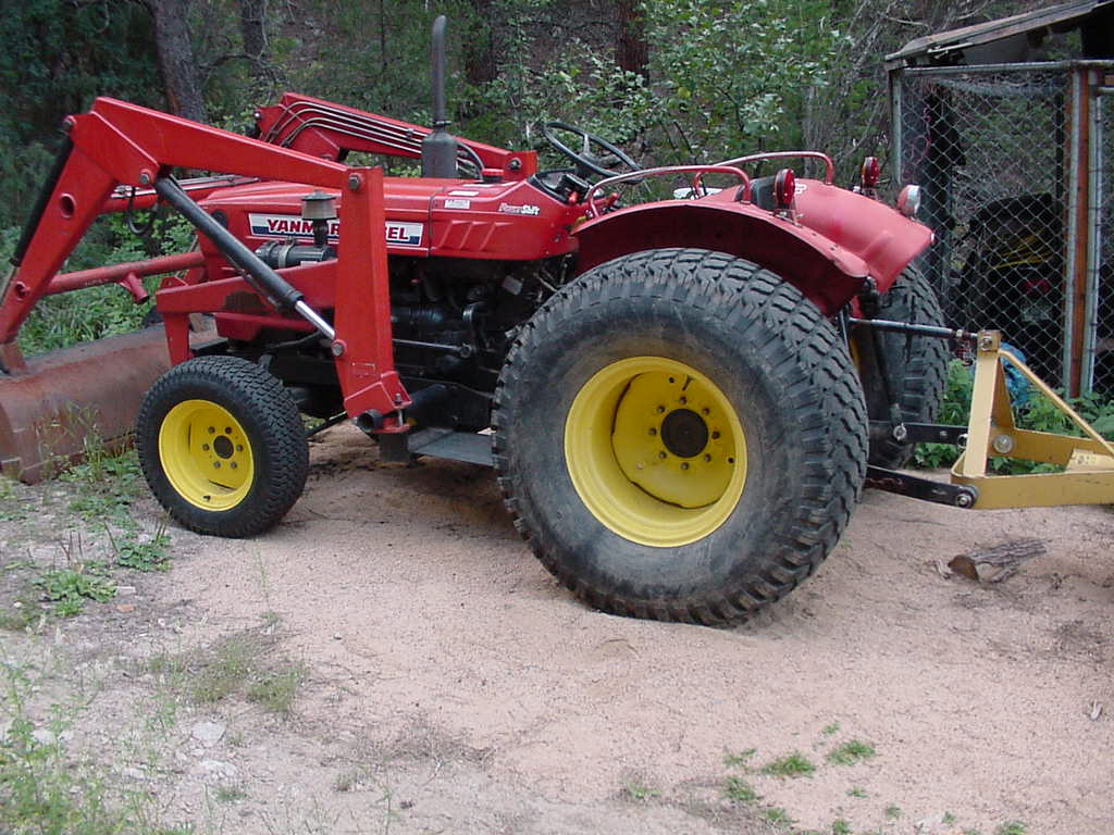

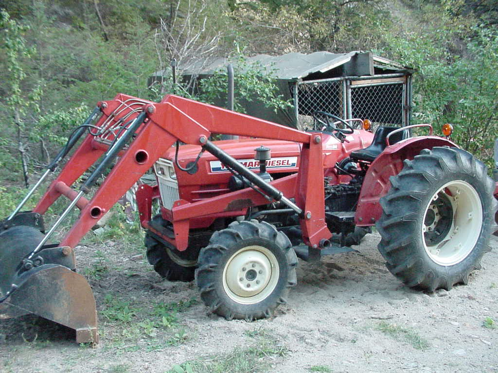

I've never run ags and turfs on similar machines to directly compare. The machine with turfs in the snow had chains, which worked well. Never ran it without the chains. In general turfs stink for anything except not tearing up a lawn.
I did. On the same exact tractor. A 33 hp. For 90% of the work the different tires made no difference in traction. The turfs were a much better ride & more stable on hills. Turfs do suck in deep snow, but we always kept chains on during the winter on any & all light utility tractors regardless of tire type.
We found that turfs plus chain have more traction than bare Ags, but not more than Ags plus chains.
rScotty

I have really been considering the turfs but I am concerned that they could get easily punctured if I were to run over something sharp like a bush stump or something. What's your experience with that?
   / Will 10 Horsepower actually matter on the same size tractor? #107
Turfs are not very sturdy tires.
   / Will 10 Horsepower actually matter on the same size tractor? #108
I wouldn't take a set of turfs, IF they paid me! lol
