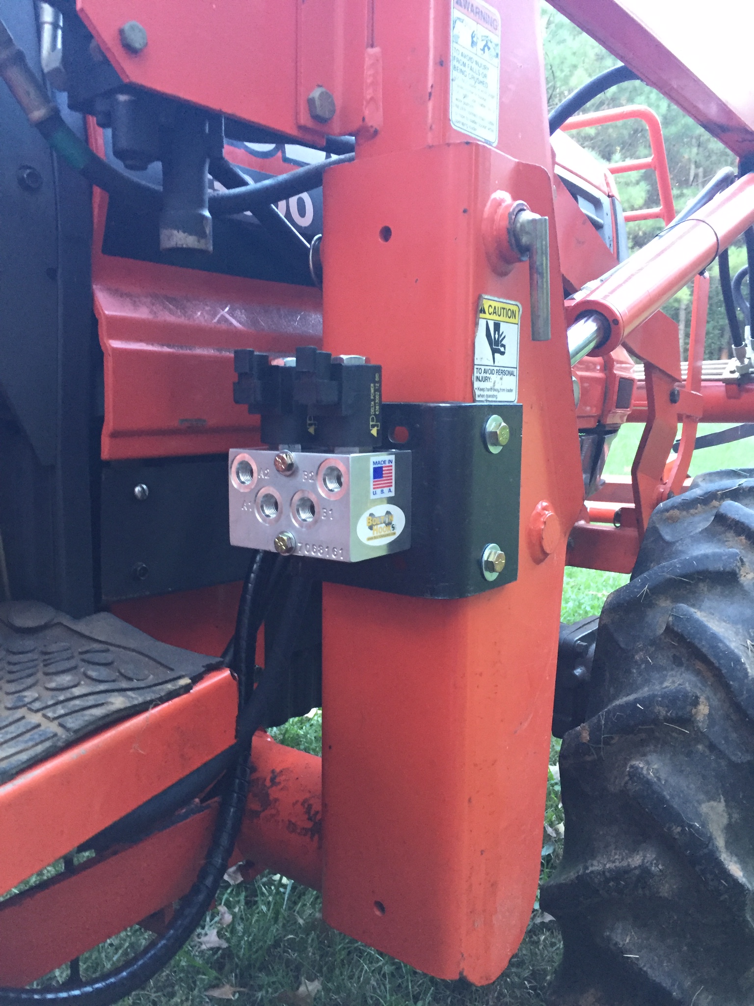

Late yesterday I looked closer at my loader and where I might mount the valve. I won't be able to mount it where you did or near the tower, there's just not enough room around in there anywhere. I bought the loader used about 15 years ago and as the hoses went bad, just took them off and had them made the same length. That's the reason it looks like spaghetti.
I may end up having to make a bracket and bolt it on near the front. My valve should be here this week and I'll be able to try to position it somewhere.

I'm one step closer to getting my new grapple up and going. At first I wasn't sure where I was going to mount the diverter since there wasn't a lot of room. After getting a few ideas from what others had done I decided to use a piece of angle that I had in the shop and mount it to the outside of the loader's upright. I ordered the diverter kit last week and got it on Saturday.
After prepping the angle, drilling and tapping the loader's upright, drilling the holes to attach the valve I tried a test fit. Seems to fit good and should be out of the way.
The fittings should be here this week, hoses will have to be made, wired and a little orange paint.
