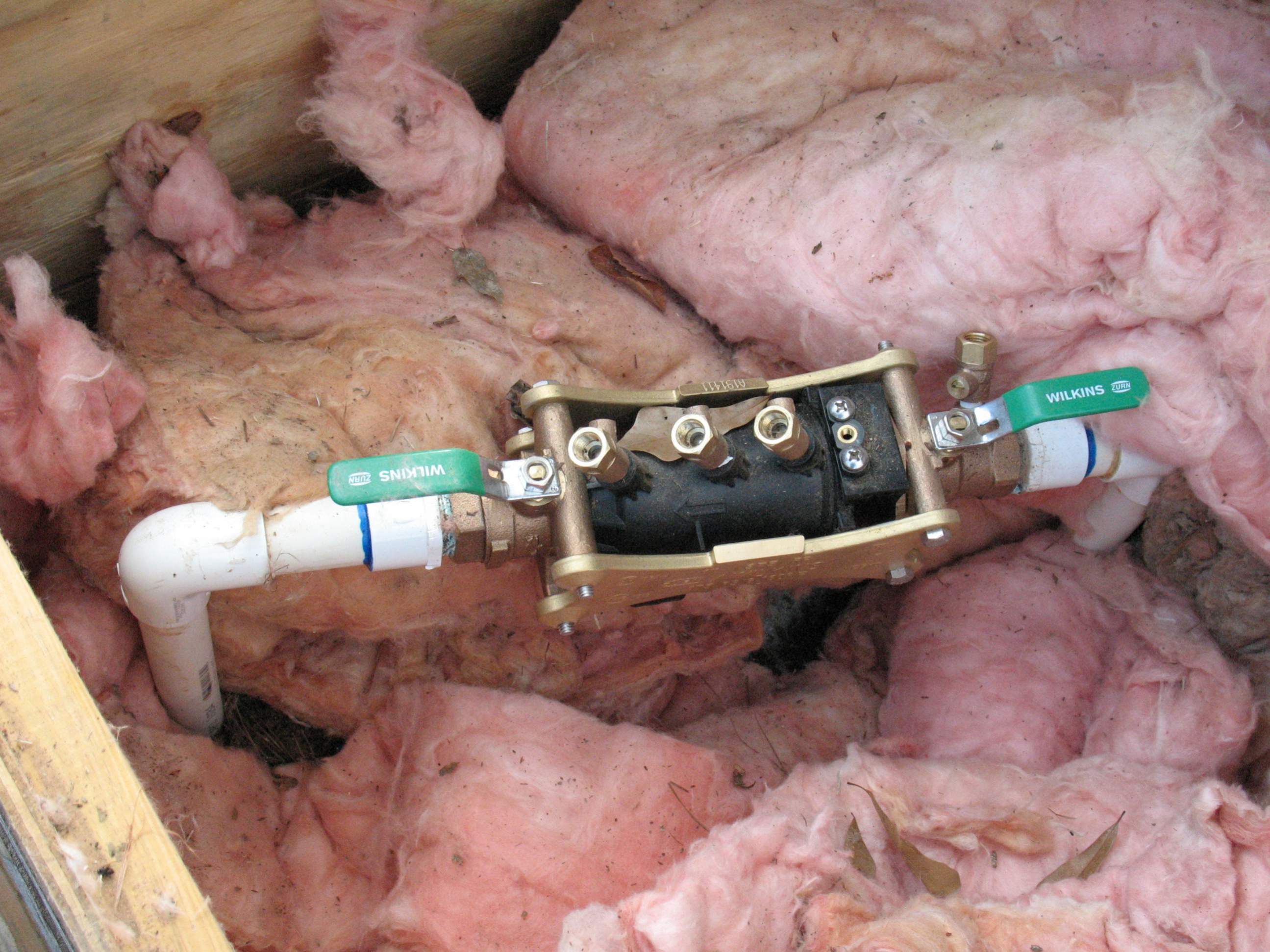

IMG_1189.jpgAround here, once past the meter, you can do any work without a plumbers license and the only back flow preventers is at the hose bib and are really just a vacuum breaker. If anything is at the meter it is on the county water supply side. I do have a huge one for my sprinkler system that is required but it is tied into the main line before the line to the house.
