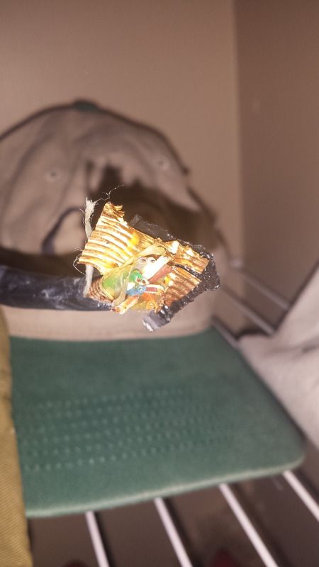

I've lived here for 6 years. My wifi does reach to the barn, but just barely. If I shut the barn door, it doesn't. As old as I am, I like to take breaks, check email etc on my phone at the barn. Any winter projects with the barn door closed, I can't do that.
Thinking of setting up access points with old routers. So tonight in my living area I set one up, got it working, and I'm leaving it here in the living area. My main router is on the other side of the house. The signal has been good, but with this router, now access point, the signal is very strong, speed is better. So, going to setup another old router I have for the barn.
What really kicked this off in doing this, besides the poor signal, I discovered a wire the previous owner and builder, ran from the barn to the utility closet where my router is. The distance house to barn is 200ft. Here is a picture of the end of the wire. My question for those smarter than me....can I cut a cat5 cable in two, then splice the cat5 ends into this wire to get signal to the barn? If I can, I'll end up with a very strong, I think signal in the barn. What's the odds of it working?

You could certainly crimp new RJ-45 connectors on both ends of that wire. That appears to be a good quality CAT5 direct burial cable so it should work fine over that distance if it has not been damaged somewhere.
You may want to check for continuity between the wires. If the cable is good they will not be connected to each other.
Great.....I did not know what kind of wire that was. So much the better. I need to get a crimping tool though...I've needed one so many times, OR...can I just twist wires together?

Cat5 spec is good to ~350ft, assuming it's a good cable that should work with the right termination.

Hard for me to tell from the picture how many wires are in that cable looks like direct burial phone line best I can make out????
   / Wifi to barn #8
I does not look like twisted pairs that are in cat5 - worth a try though.

I've got a problem with the wire termination on both ends. After a little research, here's what I think is the best way, at least for me. Advise me if I'm wrong.
The wire terminating in the house is short. I'm thinking of putting a punch block there. Punch in the existing wire and then 1/2 of another cat5 cable that got the right end plug so it can go to the router.
On the barn side, a fair amount of wire was coiled there....in my stupidity, I cut that wire off, several years ago, but still have the wire. There is enough for me to route the wire inside the barn....then do the same thing there with a punch block...but instead of the cat5 cable...punch in the piece I cut off. It has some length to it. Route that to an electrical source...probably higher up....then another punch block, with the other 1/2 of the cat5 cable punched down so I can plug into the access point.
IF.....I had a crimp tool for crimping the ends on...I'd do that instead of the punch blocks. Since I don't, is the reason to use the blocks instead of buying the tool. Seems cable is disappearing, and I doubt I'd ever use an end crimping tool again for anything.
