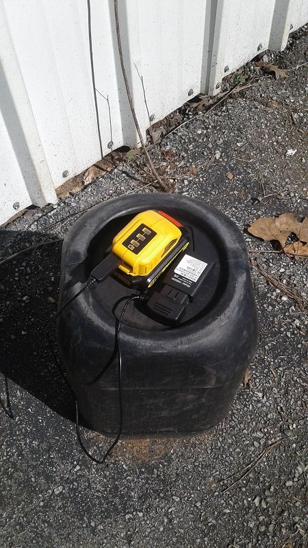

Like I wrote - I looked into it. I also was about to run fiber to my workshops. Then along came Mobley.
I usually get 5 to 20Mbps speeds almost anywhere I go in Northeast Mississippi with my trusty Mobley setup. Which consists of a DeWalt 20v Max USB power source, a battery and an adapter.
Which is twice as fast as I get on the landline router.
So I stopped looking into it :)
