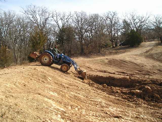

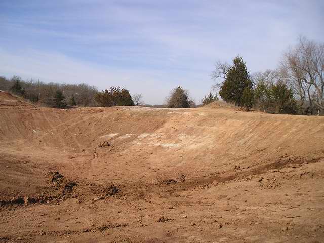

1. High-rabbit is definitely a road gear. I have a steep road going from my house to our lake (a little over 1/4 mile) and the tractor has a hard time starting up that hill in high-rabbit. No problem in high-turtle, but...
2. High-turtle will bog down on fairly steep hills when carrying a load of dirt in the bucket. I have one run that's about 25' long and probably a 20% grade. That's about as steep as I can go and I have to hit it running to maintain. Otherwise I have to shift down to low-rabbit.
When cleaning out my pond, I found that with a huge heaping load of silt and going up very steep banks, I'd have to shift down to low-turtle just to pull out of the pond. Two examples are attached. Notice the tracks going up the far bank in the first picture. That's a low-turtle hill I guarantee. The bank in the second picture I could climb in low-rabbit.
