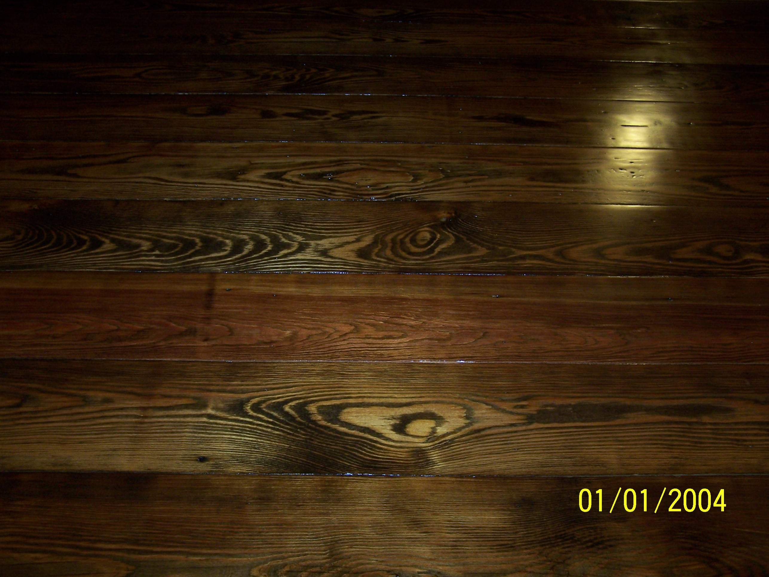

Moisture fluctuation was a concern of mine. I did not have a moisture meter but could tell the boards were dry. They have been stored in the old house for 30 years. I kept them in my basement for 4 weeks before starting the construction with no expansion. The top is attached to the base with cleats so if I notice any expansion I can remove the top easy and work on that.
The boards are 3/4 inch thick and attached to 3/4 inch plywood. I guled the boards on the edges and to the surface of the plywood, Used 1-1/4 inch brads to hold in place and put some screws through the bottom. I don't think I will have a problem, but if I do it is an easy fix. I attached a pic of the top.

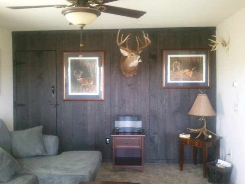

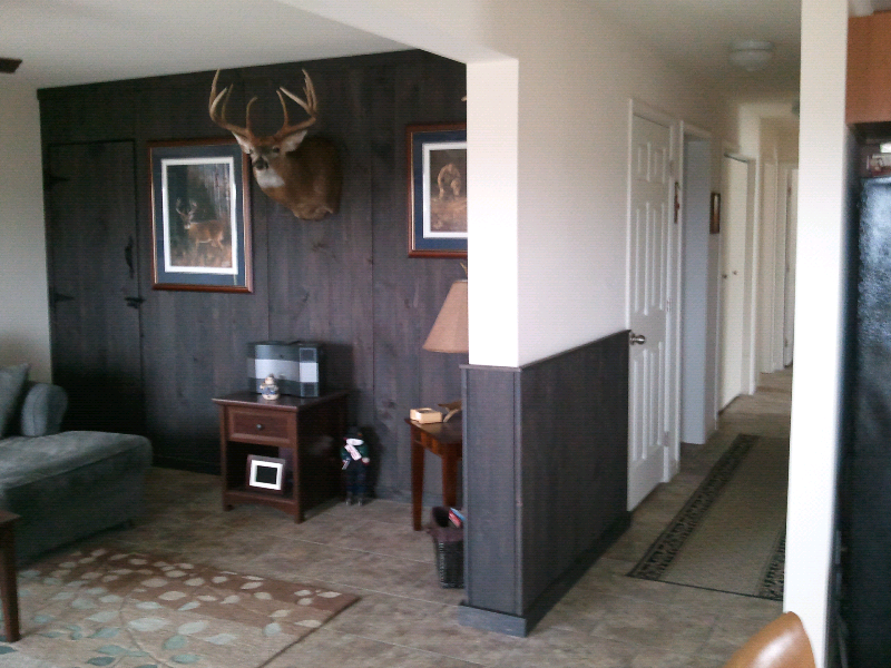

Great job! I love it. I love the look of that weathered old wood look. I wanted start incorporating it into my house, but in order to keep it some what consistent in color,(since I was lookin for weatherd barn board) I went with ruff cut pine, and used a greyish black transparent stain to bring out the grain. Only recentley started, but think im gonna run all through the house with it now. Even made a new closet door that looks like a barn door.
The boards are shrinking up nice now, and I painted the walls black before I started, ads a nice touch.
