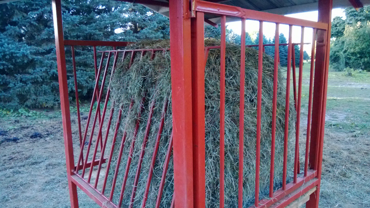

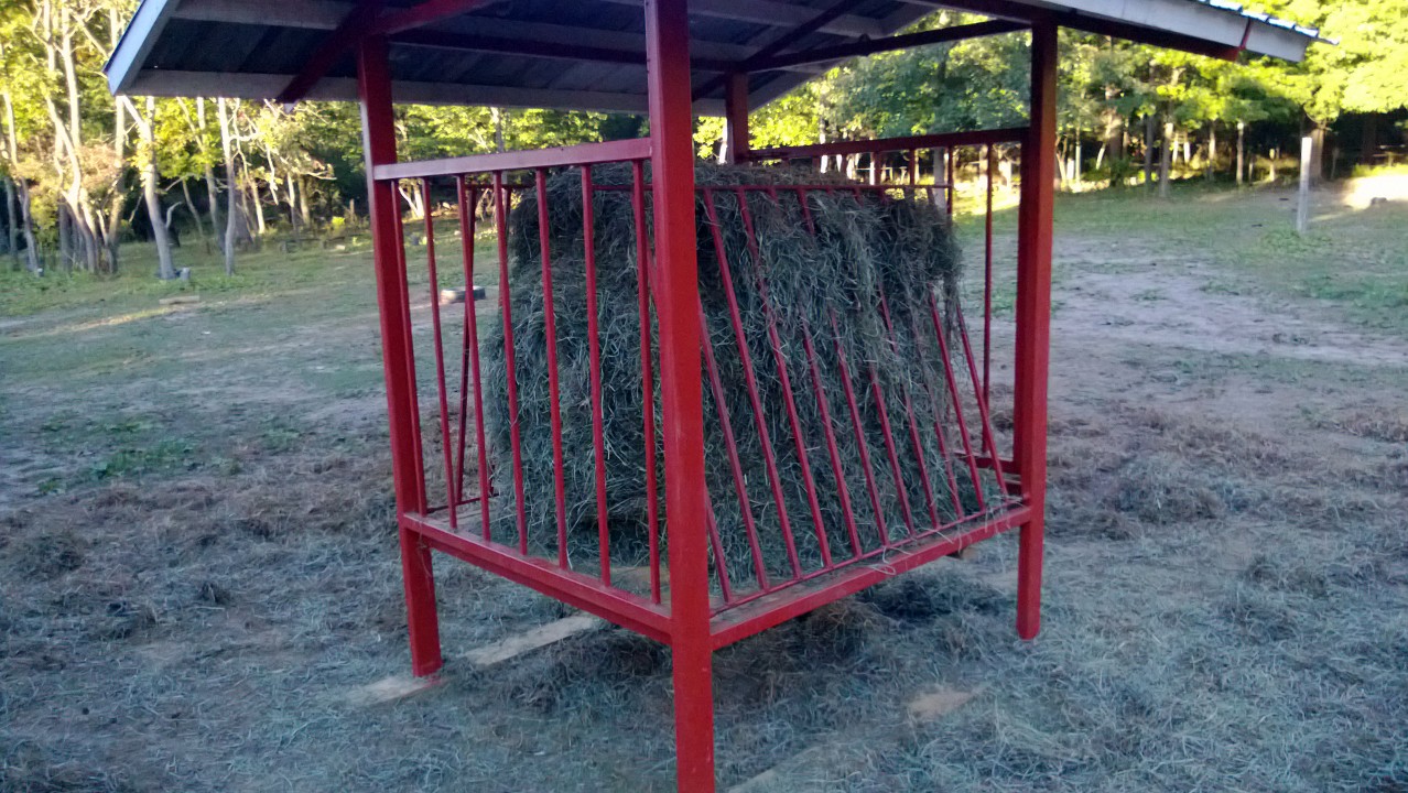

Wow... nice feeder. Any pix of it with a round bale in it? Great for horses... off the ground and covered. How meny horses do you feed with it? Looks like the sides fold down as the hay gets eaten, so they can get to all of it? We do our own squre bales, and with only 1 horse and 3 ponies its not too hard to keep up with. If we had more, and fed in the field I would steal your design in a heartbeat!
We feed 5 with it. Yes the sides follow the bale down as it is eaten. We can also lock the sides up so that they are forced to clean up what they spill, then let them down again. Or once the bale is partially eaten, lock the sides up and pull the amount of hay we want them to have access to near the sides. In just a few bales we have learned how to reduce waste. And thank you for the compliment, however the design was Klene Pipe's patented design, I only modified to fit my needs.

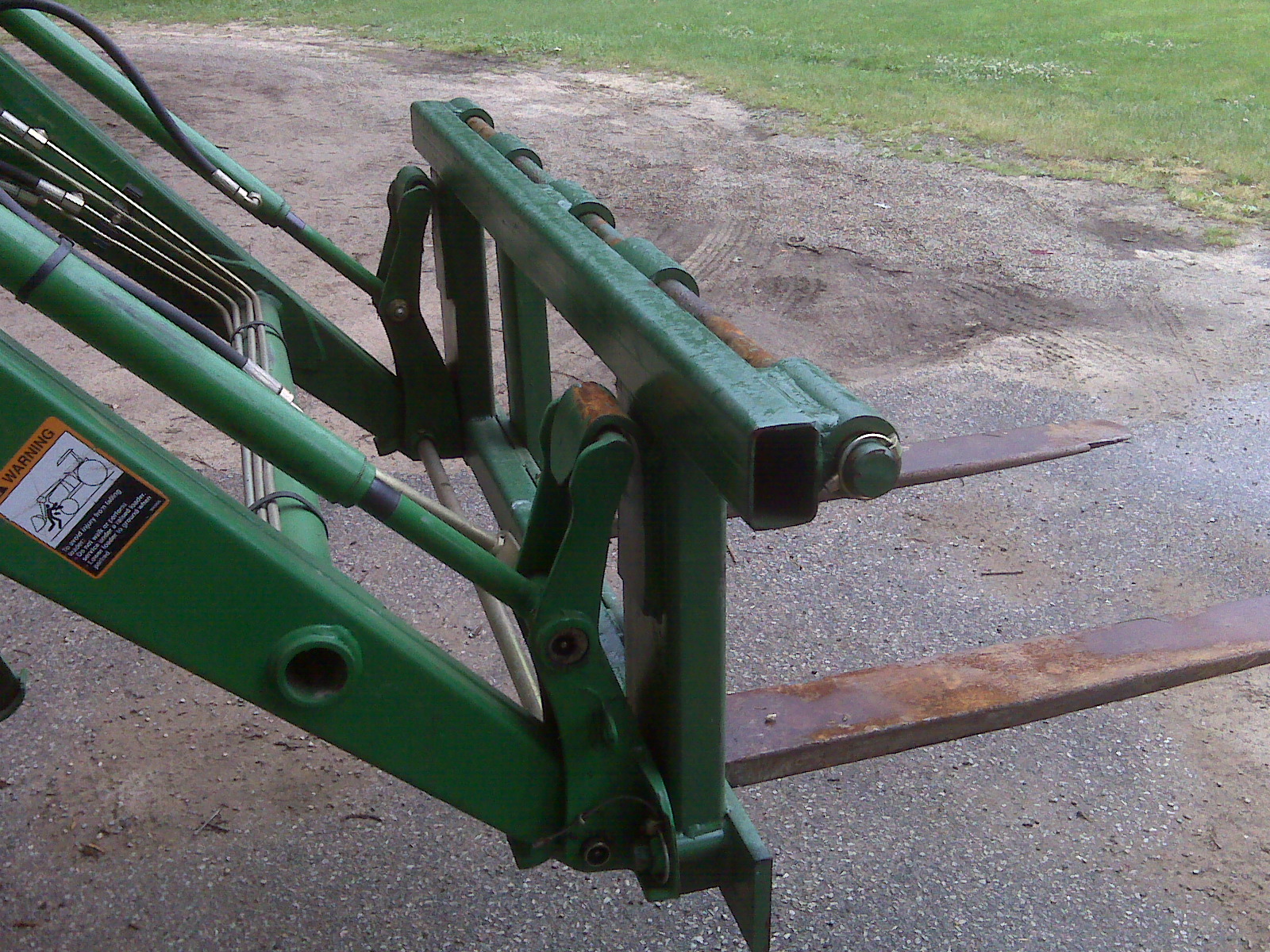

My next one is going to be a 5045 or 5055, gonna keep my 790 though. I do the same thing, trick I learned is you can curl more than you can lift, I roll the bale spear forward a little, lift the bale, then curl it back. It will gain you another foot or so on the front of the bale, at least it does for me. The other thing I have is a forklift mast that hooks into the backhoe sub frame, I can lift 1500 lbs. on the rear with no troubles at all. Cant dump or reach but it works well when its on the tractor. I just lift the bales between the forks and set them into the feeder. Trouble with that is I don't keep it mounted on the tractor most of the time. By the way I love your feeder, nice design and looks well built.
Building a rear lift is another option that I may pursue, but I have not told my dear wife about any options but a bigger tractor yet. She does not read this forum by the way. I thought about going with a spear attachment tot he FEL as my forks are rated at 5000#. Way of an overkill, but they were what I had access to when I built the fork attachment. The forks are welded to pipe that is held onto the quick attach with a bar. I could make a spear and probably save 200# of weight that could go to the payload. Again not an option shared with my bride.
Thanks for the compliment on the feeder, we've had horses long enough that I knew it had to be sturdy. Always surprised at how they can get themselves into trouble.
