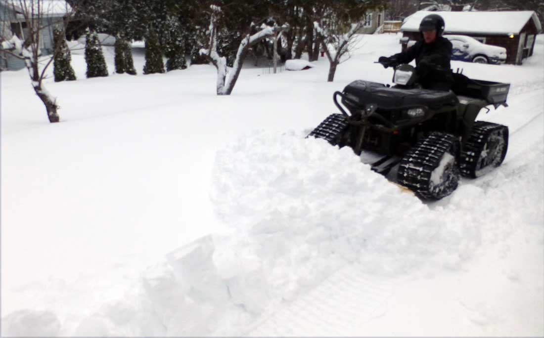

I have a snowblower already. It has its uses but also want an attachment that is quicker to get the job done as well.
Since we got a 6ft blade on our 6x6, we pretty much quite the blowing business. And we really do receive snow here.
