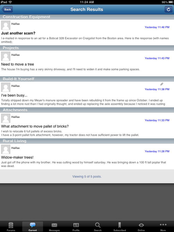

The OP created 5 new threads in 12 hours. Those are the only posts. It doesn't seem plausible that the posts are real. ...buying a house and need to move a tree, getting a come-along in 30 minutes to pull down the tree in this thread and it's 11:28pm when it's posted, rebuilt a manure spreader. Doesn't this look like SPAM?

Hmm, that is certainly curious, however, none of the posts really smell like spam. Perhaps the OP can explain for us.
