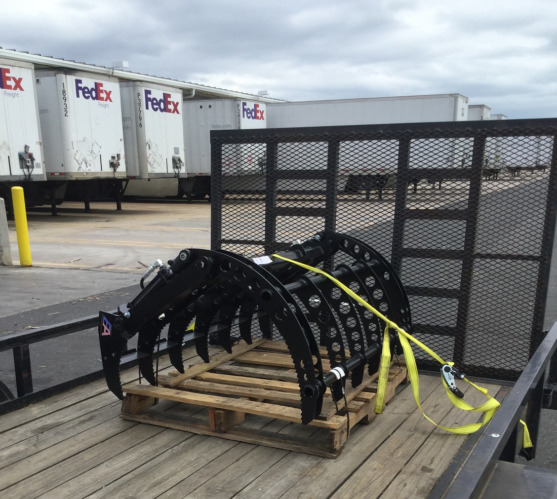

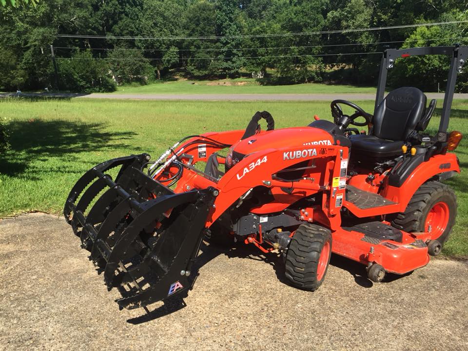

Picked this up today. Looking forward to putting it to work next week. Will be going on a Kubota b2601
Thanks for the business, man!
Fun times ahead. :dance1:
Show it off more if you get a chance!!

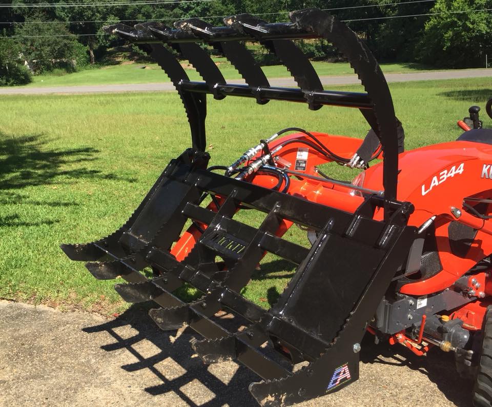

#182

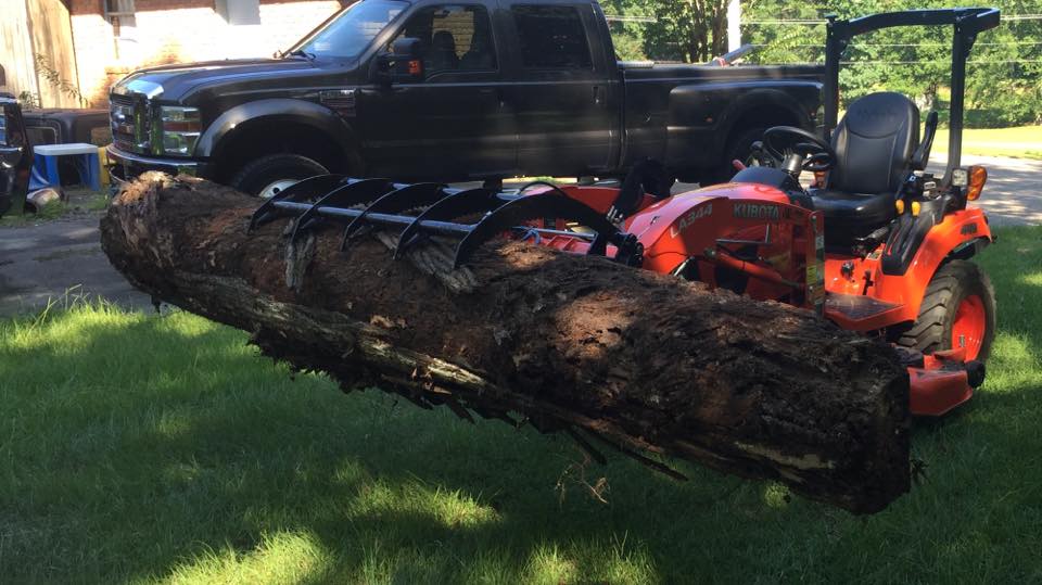

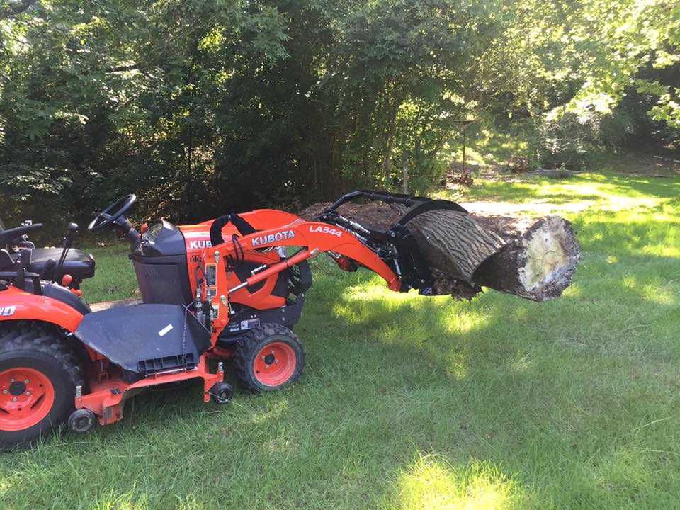

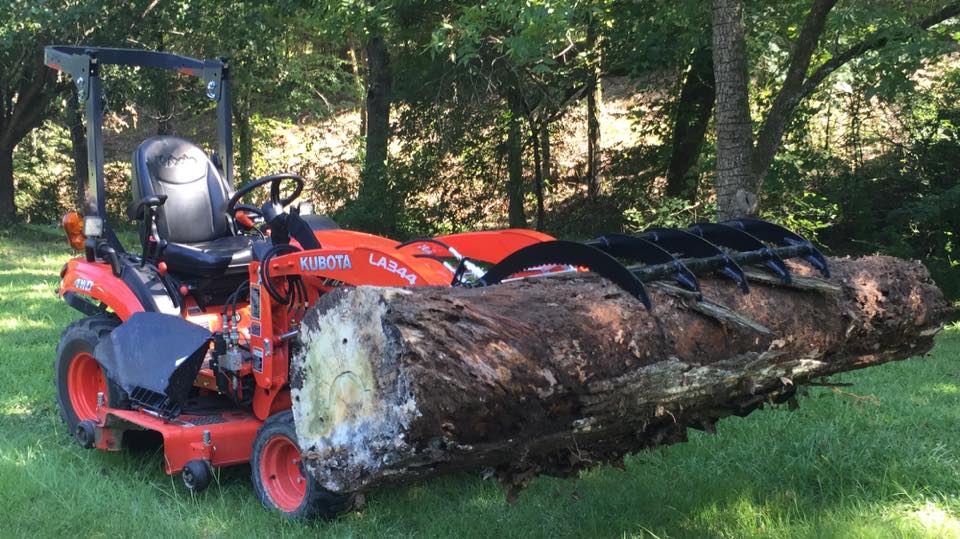

This 48" BX Wicked Grapple Rake was specially requested black in color. To my knowledge it is the ONLY 48 we've ever painted anything other than Kubota Orange.
Jerry from Mississippi has it on his BX2680 tractor and the size of those logs amaze me, especially with no rear ballast. :eek:
Travis

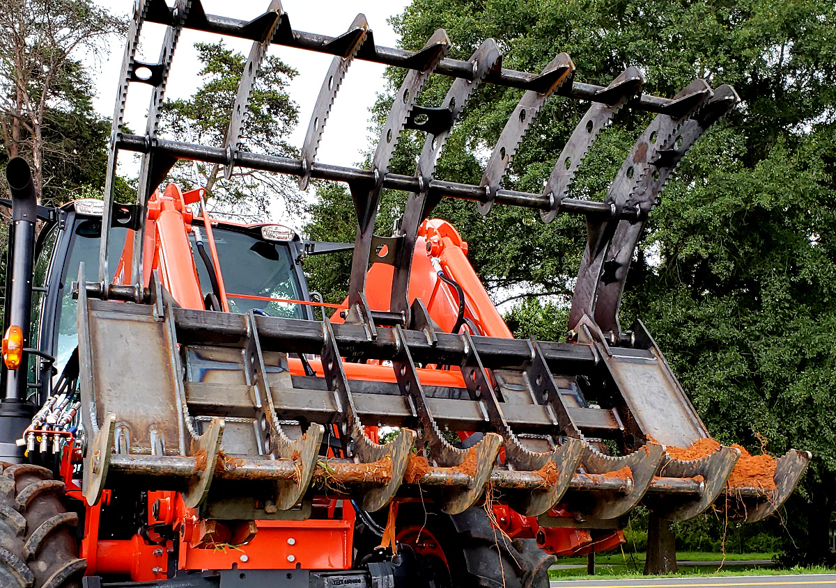

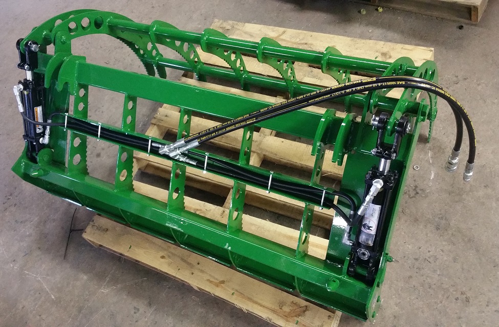

ALL Rake Style Wicked Grapples will soon be outfitted with DOM tubing, similar to what is on our brand new Wicked 66, instead of lower bolted in runners.
The pipe will plane and serve as a depth gauge just as the runners do.
It will be more durable, but probably only noticeable if you go into full blown Ted mode. ��
It will also be more expensive, so prices may rise some.
We CAN still send your grapple with runners during this transition period if requested....just let me know.
If you already have one with runners, replacement parts will continue to be available!
Here's a visual...
Travis
