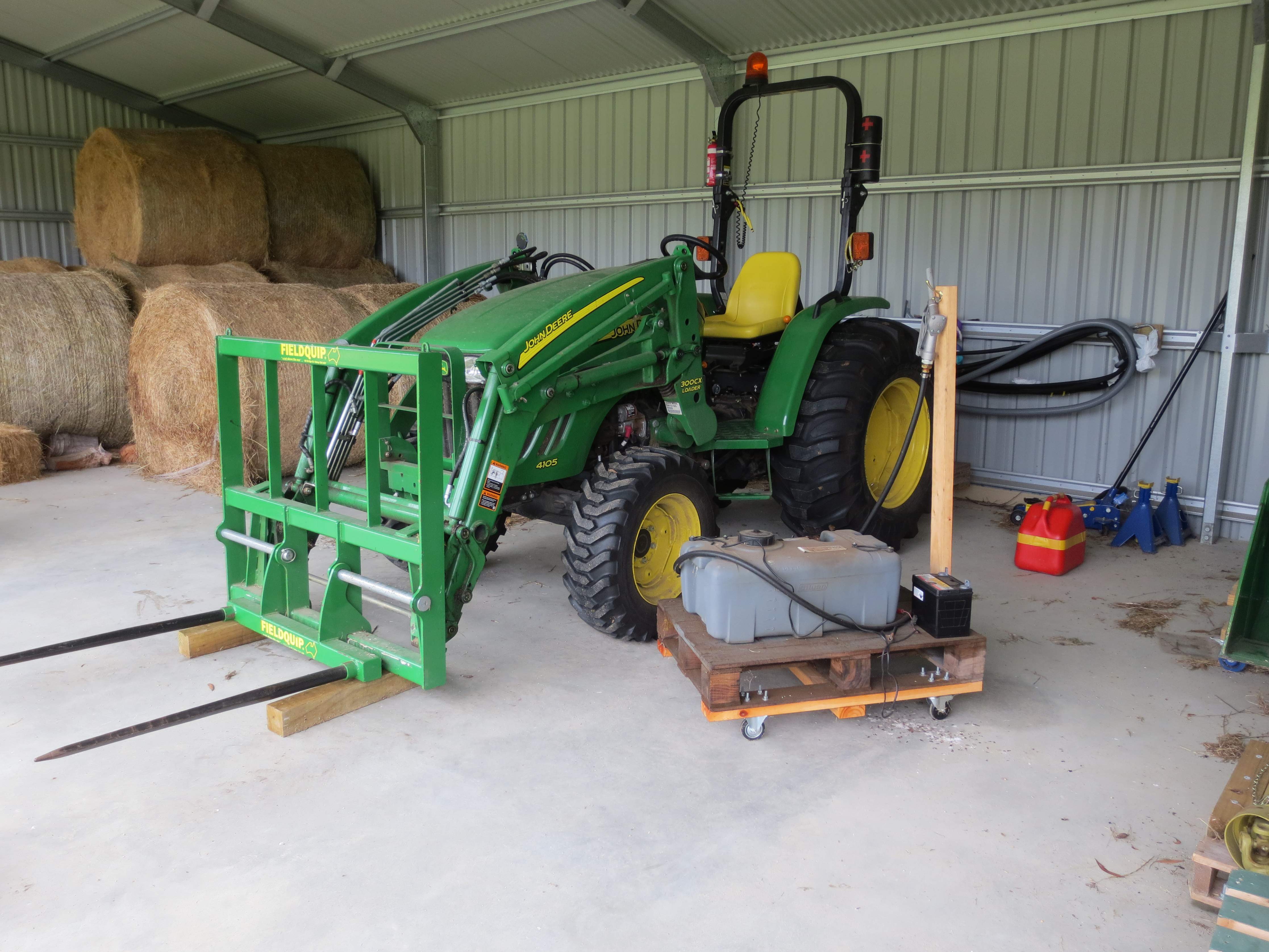

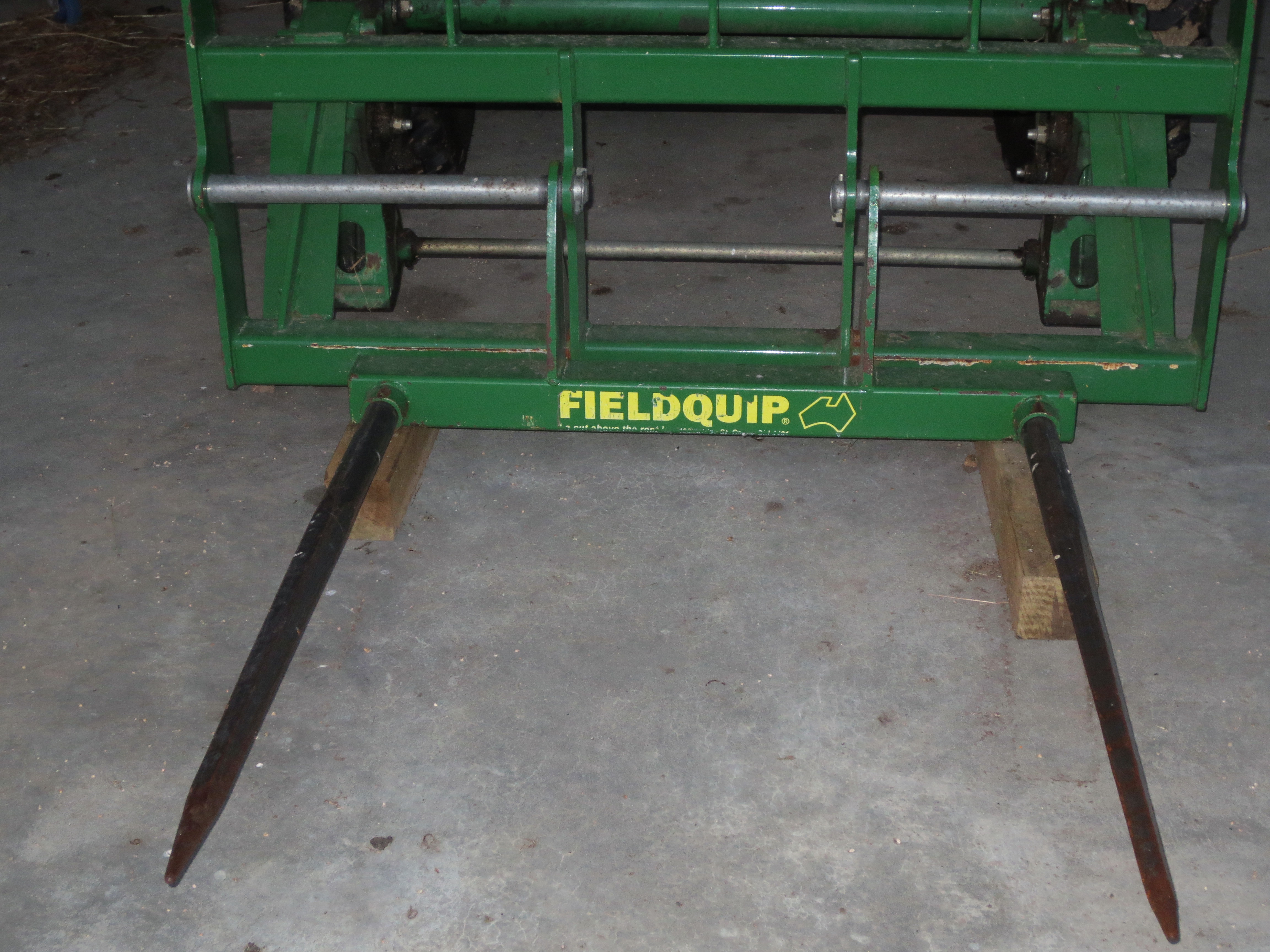

BTW, I could use a set of forks on rare occasion. Do y'all find it easier to use a true FEL fork attachment, or just bucket clamp-on forks? My loads are 300-500 pounds max, just moving stuff on & off my pallet racks.
Dedicated forks are better, both because as K0ua stated and balance/lifting-capacity.
I've said that I have a combination pallet-fork/bale-spike attachment. Personally, the spikes are what I use the most and they rarely come off but all I have to do is un-pin and slide the steel bars back, lift off the spike assembly, and then slide the forks (individually) onto the steel bars. Then slide the bars into the holes and pin.
