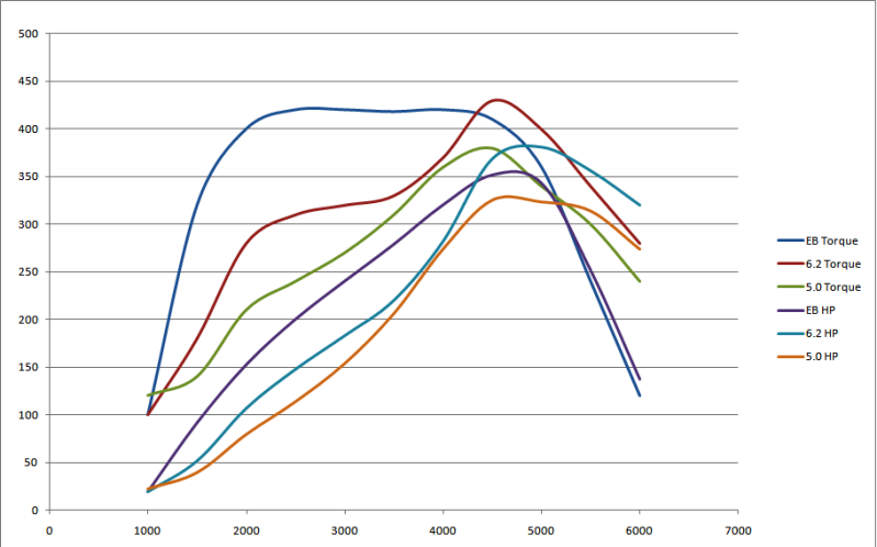

The little EB makes peak TORQUE at extremely LOW rpm & no need to rev its guts out like the much bigger V8 Requires.
The much bigger V8s are sports car engines, peaking at high rpm where you dont want to be all day while towing. Especially with VVT V8 engines in pickup trucks, horsepower numbers are for bragging rights only but in no way reflect usable horsepower in the economic rpm range.
The Ecoboost still reaches peak horsepower at 5000rpm so in heavy towing, you still need to shift down and throttle up like the V8 as the top end of the power curve is quite similar. Just in lighter towing when you dont need the full horsepower, you can keep lugging along at roughly 1000rpm lower, making the same power, with the ecoboost.
Now if we had the 6.7 Cummins, Duramax or Powerstroke power figure in this same graph, peak power would reach as high, albeit at 3000rpm, and torque would be off this chart, its so much higher.

Again, the new 3.5 Ecoboost with max tow package produces 400HP at 5000 and 500 ftlbs torque @ 3000.

I understand how impressed you are when comparing it to your former gas V8s but youre not impressing the diesel guys with it, that have max power where you have max torque, and they have 1075 ft-lbs torque at 1600rpm... The Ecoboost is (quite an) improvement on the light duty gas engine, not an equal to the big diesels, the pistons just travel too fast at rpm where it makes its power, so it wears quicker in heavy duty towing. Two different animals.
Make no mistake about it, I am in agreement that a diesel is superior when it comes to heavy hauling. My post was more directed at the graft posted in post #314. It has older data and compares gas engines.
