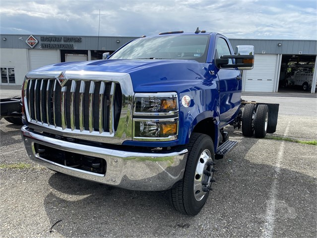

I was thinking Jeep might give it a try again, or possibly International. There’s so much profit in trucks.
With the way the anti-fossil fuel winds are blowing here, one has to wonder if anything new will be offered
Here ya go.
