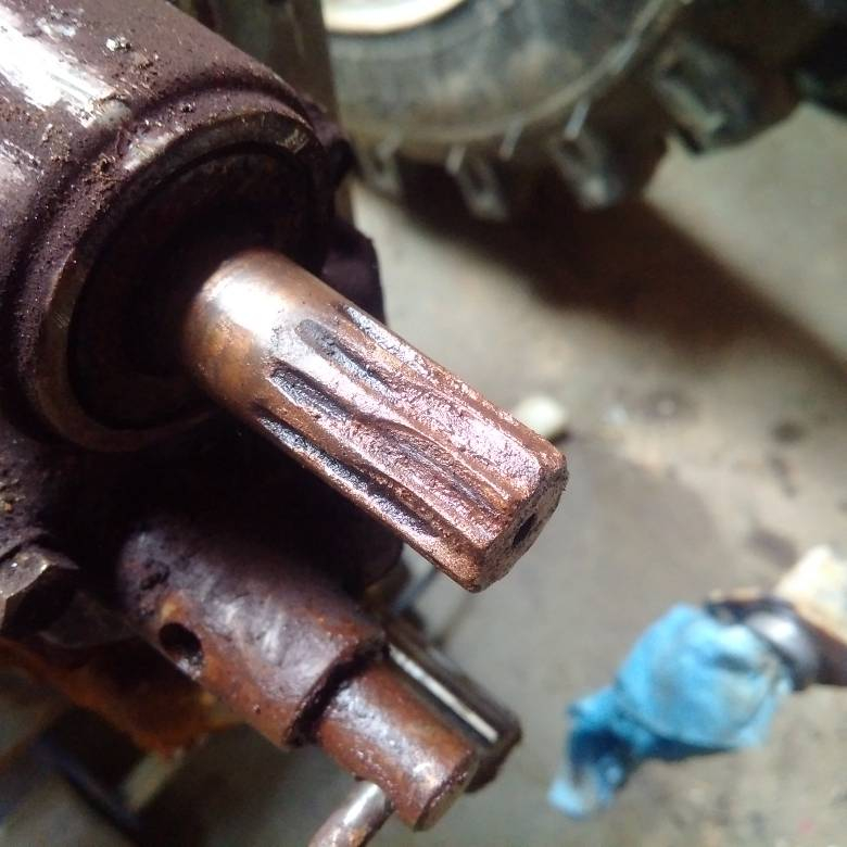

This might open a real hornets nest, but Saturday am I was asked a question from one of our "Big City Weekend Folks" that I really had to stop and think about. The question was: "Sombody told me to turn off 4 wheel drive (on my tractor) when I'm on the road (Pavement), Why?"
I would not say a hornet's nest but there sure is a lot of going off on tangents here. Harmless but distracting. Buried in a few of the other posts is the meat of the answer to your very basic question. Here is WHY:
1) Tractor 4WD is designed, built and intended only for off-road use. Key to that is that there is no 3rd differential to facilitate the front drive running at a different rotation rate than the rear. ALL "4wd" cars and trucks use the third differential in a transfer case to accommodate the front and rear running at slightly different speeds.. You tractor doesn't have one.
2) The implications of 1) are that if you run in 4WD on pavement the front and rear tires have a disagreement on exact rotational speed. In a perfect straight line they may disagree by only a few %. Around curved maneuvers, much more so. Something has to give so you get hopping/jerking on the pavement because the tires must slip going slightly different speeds. The end result is higher wear on tires, on the gearing, on the entire drivetrain. Therefore the extremely well-founded and logical directive is "Don't do it."
It should be footnoted that on soil and gravel and other surfaces (where tractors are designed and intended to be used) slippage to accommodate differing speeds of the front and rear drives, is radically easier and normal than on dry pavement, occurs all the time and no one notices. Even on normal off-road soil, etc. you are reducing wear and tear on the drive train slightly by being selective about when you turn on your 4WD. There is a recent "other thread" that discusses this in some detail and I am too lazy to hunt it. Suffice it to say each operator has unique and individual good reasons for being in or out of 4WD such as steepness, load being pulled, surface slipperiness, etc. Safety/braking is a big one since your brakes use all 4 wheels only when in 4WD.
   / Why no 4 wheel drive on roads? #60
Most tractors have smaller wheels on the front than the back. The smaller wheels rotate at a faster rate than the rear wheels.
There is a small amount of play in your gears, as the rotation rates are slightly different, they will quickly reach their maximum and start to bind against each other.
Attached is an image of a front axle shaft where I suspect the previous owner did exactly what you are asking about. At least it was only a shaft and coupler that was damaged instead of gear teeth in the transmission or transaxle.
