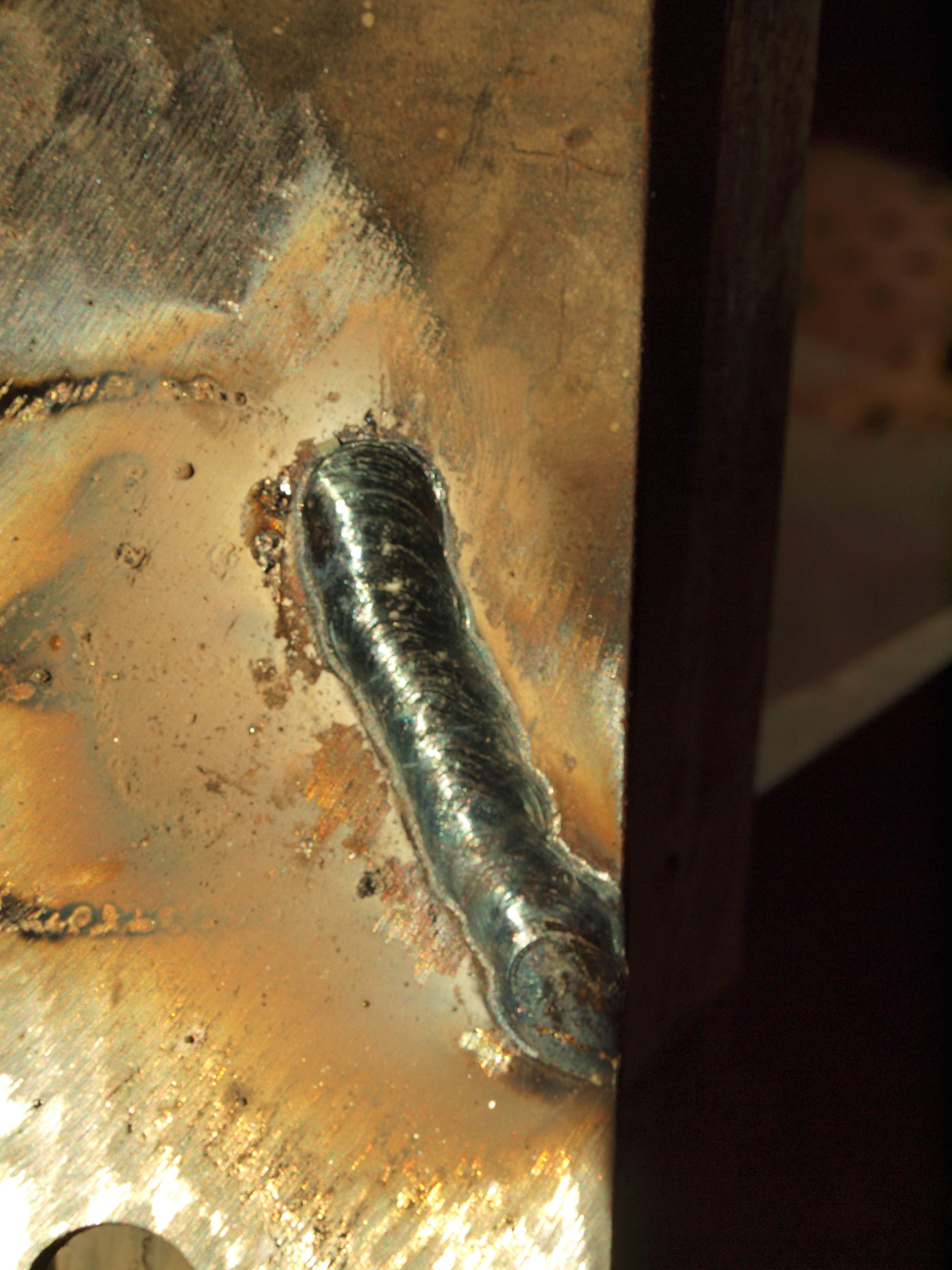

Thanks dstig for the more technical explanation making perfect sense. I welded it back up using the Tractor supplies' Hobart E7018. It is no wonder the 7018 is a almost everyone's go to rod as it is just about idiot proof. Best welds I've made and I stink at welding. There was a bit of an undercut on the 1/8th rod at 115* on my inverter welder but I think I was going a bit slow. Anything less temp wise seemed to stick the rod. At any rate I'm glad I bought a bunch. Thanks Gary for the gentle lead.

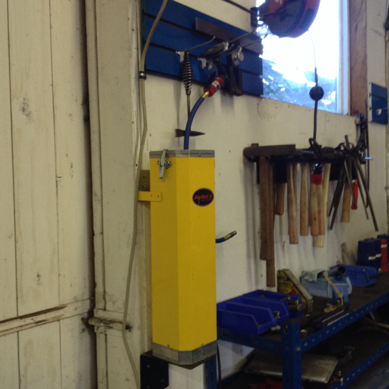

If you "bought a bunch" of 7018, you might want to get one of these for each size you have -
Welding Rod Keeper
Put ALL the rod in those BEFORE they draw dampness and KEEP it there, tightly closed - otherwise, you'd be better off just buying a few sticks as you use it.
Lo Hy rod is the only kind this is really necessary for, and if it gets wet it can (sorta) be "rejuvenated", but it takes a hot oven and several HOURS to do - if it's KEPT dry, that can be done as simply as these cannisters or a small refrigerator repurposed as a "dry box" - a light bulb inside and a small vent hole in the top works pretty good... Steve
(If you're doing Xray quality welds, ignore all this and do what the inspector says :D

Thanks Bukit. This case you're showing me seems a lot handier as you just unscrew the lid when you need rods. Much easier than what I was going to do when I thought to simply tape up the seam of the plastic case the rods came in. Someone wanting me to do xray quality welds is akin to me taking out your appendix. You wouldn't want me for that either even if I am cheaper than most docs. You would be on an outpatient basis however as we go out for pizza after most surgeries done in sterile environment of the garage.

If you "bought a bunch" of 7018, you might want to get one of these for each size you have - Welding Rod Keeper Put ALL the rod in those BEFORE they draw dampness and KEEP it there, tightly closed - otherwise, you'd be better off just buying a few sticks as you use it. Lo Hy rod is the only kind this is really necessary for, and if it gets wet it can (sorta) be "rejuvenated", but it takes a hot oven and several HOURS to do - if it's KEPT dry, that can be done as simply as these cannisters or a small refrigerator repurposed as a "dry box" - a light bulb inside and a small vent hole in the top works pretty good... Steve (If you're doing Xray quality welds, ignore all this and do what the inspector says :D
In addition to what Steve said, these portable ovens set at 300 degrees come up for sale used quite often. I am relatively new to 7018 but they run 'sooooo' nice right out of the oven.

The refrigerator with light bulb works OK for cellulose fluxed rods like the 6010/6011 but it doesn't get hot enough to keep moisture out or remove it once absorbed in low hydrogen rods. The 50# boxes and even 10# ovens from Phoenix dryrod keep them at 300F and are well insulated so the heating element doesn't run much of the time so it is much cheaper in the long run to put the money into a drybox oven and save on electrical cost PLUS have them at the right temps and always dry which will save you from having a bunch of rods go bad (bad as in wont weld without pin holes ).
I found a good 300# one on Craigslist many years ago for $150 and keep all my LH rods in it and it on full time. Most of the time, my shop electric bill (separate meter from the house) is just the minimum amount so it isn't really costing me anything to run it.
I see the 50# size occasionally for as little as $50 so not a lot of money invested to be able to keep your electrodes protected.

The goal of having a rod oven is to keep the rods dry, not keep them hot. A thermostat controlled heater will keep the rods dry, will even dry out wet rods over time. Maybe not as quick as a 300* rod oven. With rods that have been exposed to the atmosphere and absorbed moisture, High heat for a few hours will dry them out for immediate use, but rods that just need to be kept dry dont need 300* degrees to stay that way. A Christmas tree light will provide enough heat in a small area to keep a few lbs of rods dry with out spinning the electric meter off the wall
