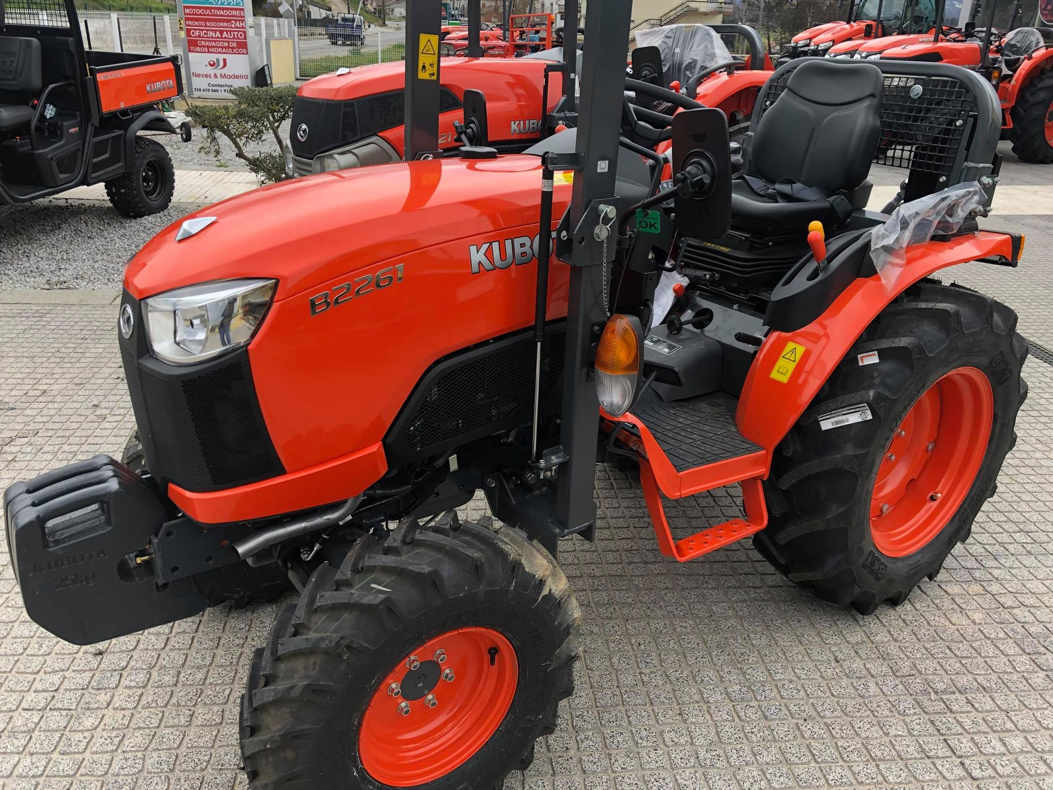

What is the advantage of a mid mount ROPS?

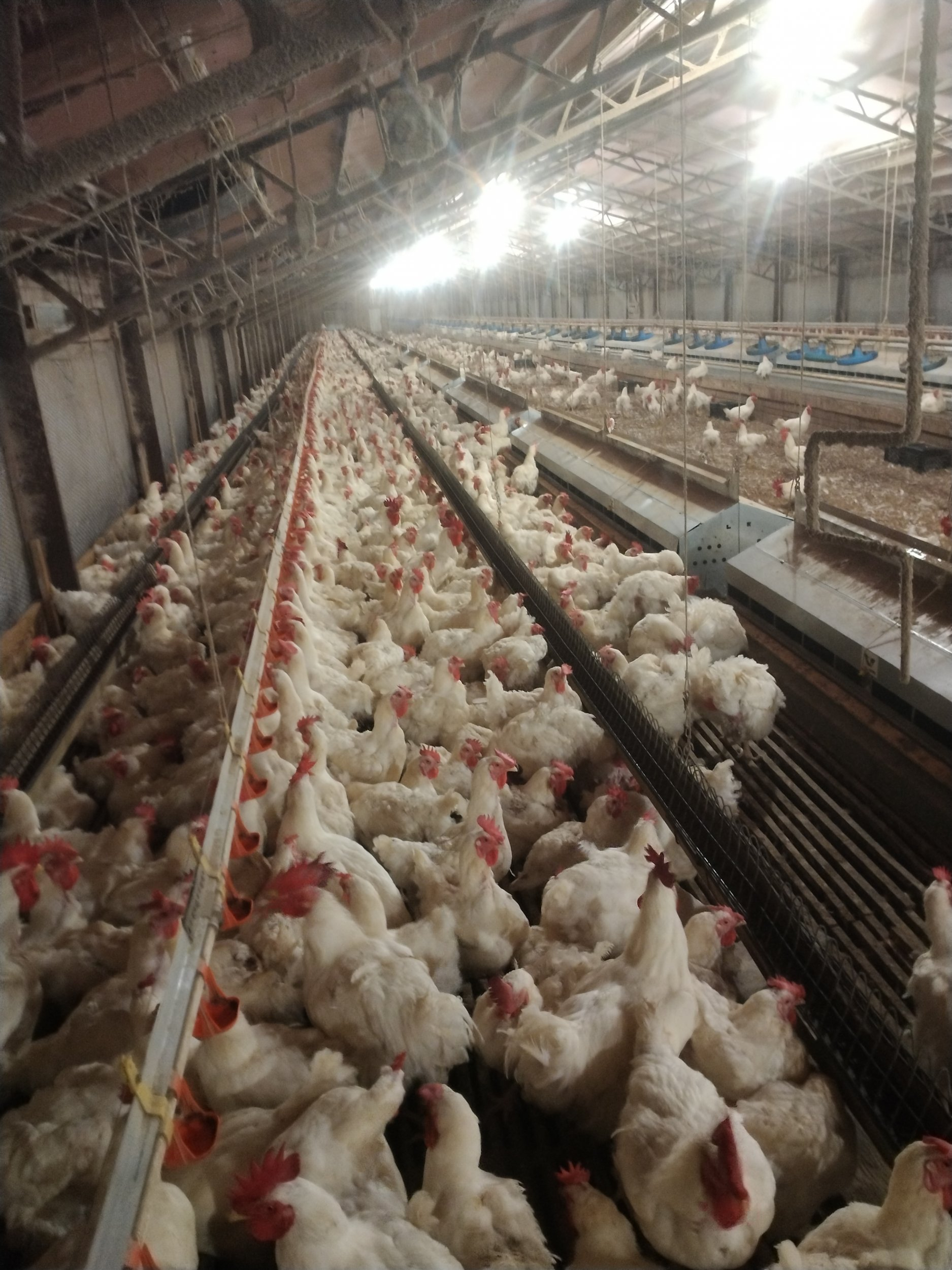

Have to put them down in layer houses to fit under nests.
Basically folds all the way down, which is essential to work under trees, like on orchards. Since, most compact tractors here are setup as orchard or vineyard tractors, they have this style of ROPS.
The highest point becomes the operator but the operator can move around, so then it becomes either the steering wheel, seat or the small ROPS in the back that works in conjunction with the middle one in case of a rollover.
Safety wise, it offers the same or better protection to the operator compared to the rear ROPS. As long as the ROPS as up on both cases of course.
