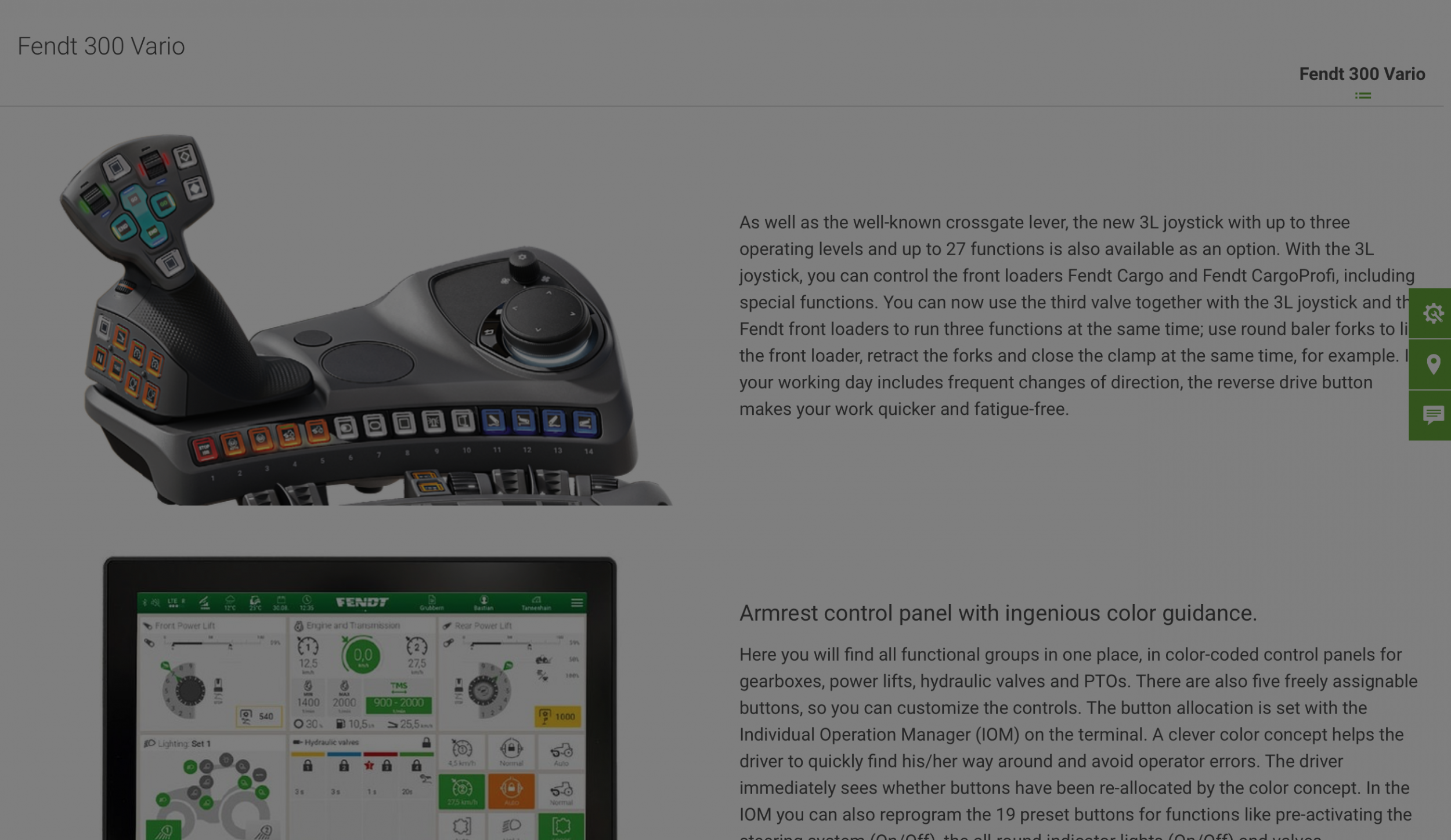

I don't have a a Fendt dealer/service in my area and the $55k price point is likely below what a Fendt costs for a 75hp unit. Thanks though.
I've been doing some reading on the Fendt and finding information hard to come by. That's often the case when dealing with different technology, but it puts a big premium on having a really good local dealer. Especially on that dealer having a committed long term service department. The kind of service that Mercedes has for their mechanics - and other makes used to have - where mechanics start young, go to school often, and stay 30 years.
I believe that Germany has that type of educational system and workers. I don't know that the USA does, or ever will again. The older generation had the advantage that mechanics was simple enough for anyone to do their own work. Electronic controls and software adjustment are inexpensive alternatives that make dealer service important,
Anyway, Fendts seem very sophisticated, but I'd want a really committed dealer nearby.
rScotty
apologies with the dark color, it's how Fendt sets up their site & nothing I can figure out changes it.

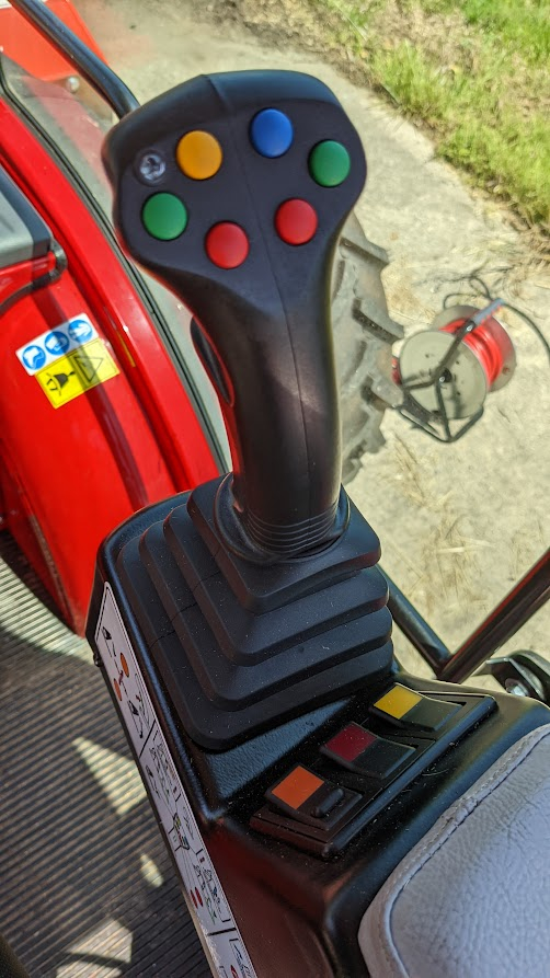

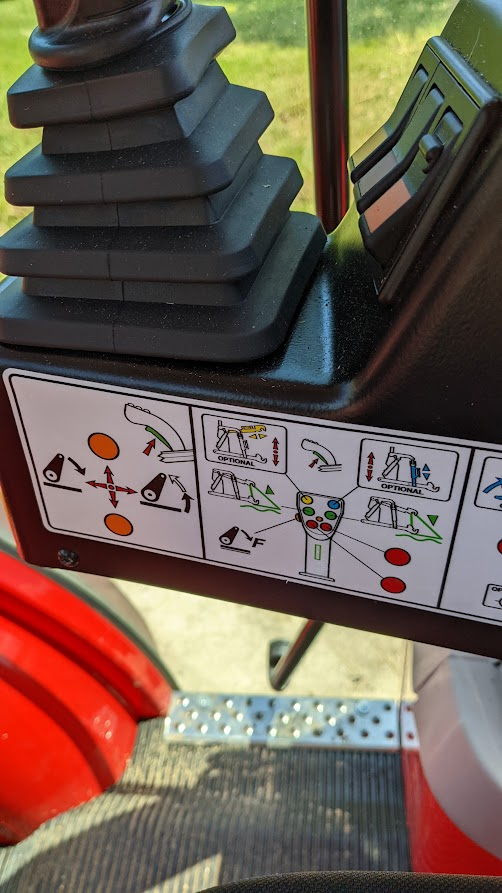

I think a lot of the european tractors are like this. My new Italian tractor is joystick controlled and color coded. Little weird at first but I ended up really liking it.
