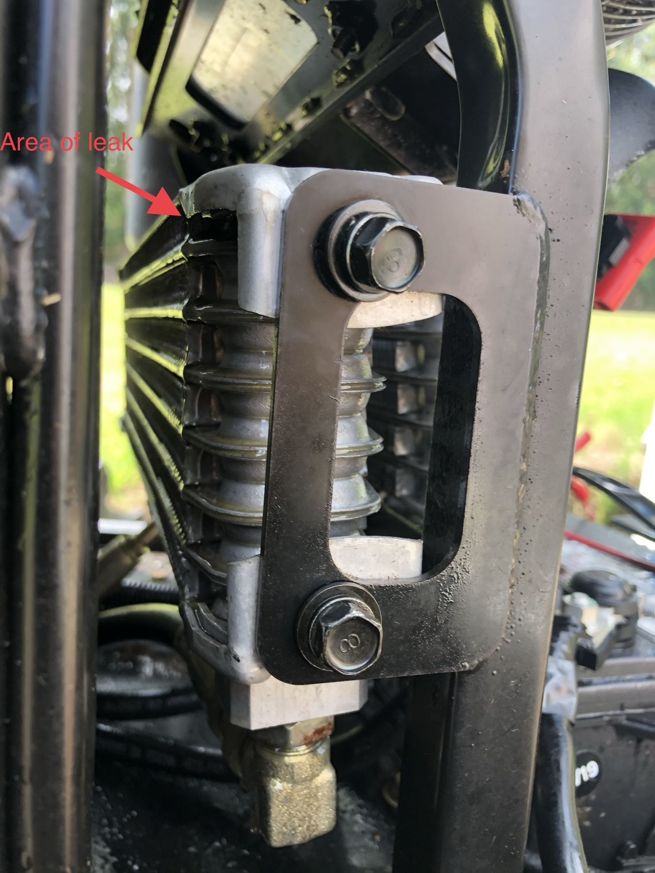

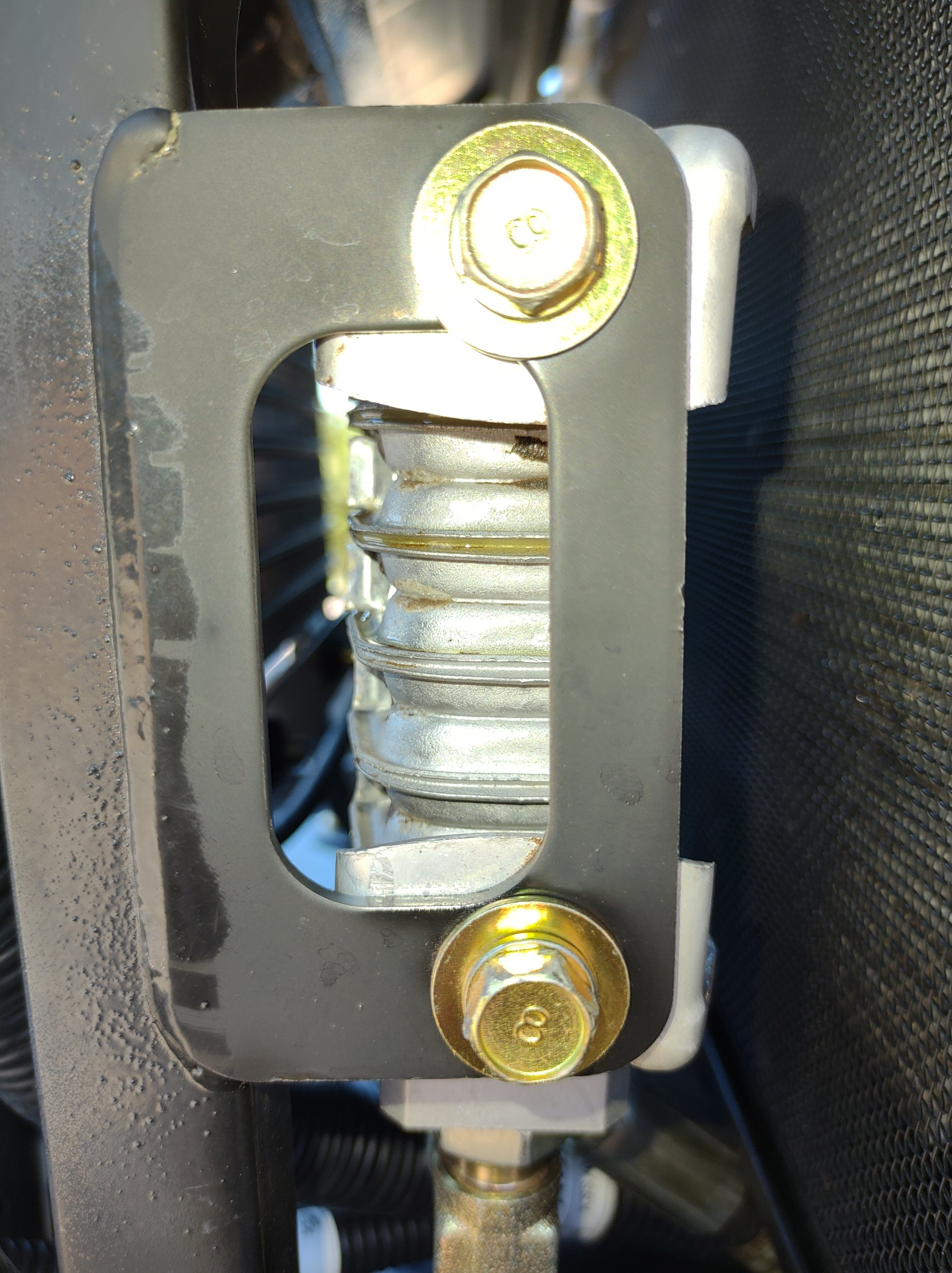

Mine was a leak at the top (about 300 hours)
Replaced to cooler, no problems.
Figure I’ll take the old one to a radiator shop someday.

That looks like where KKL's cooler is leaking to me, from the top somewhere like yours was Sodamo.... Easily fixed 👍

Thanks for sharing your experience sodamo. It seems suspicious that I might have a very similar problem. Was it difficult to replace? Do you just loosen the nuts immediately below the cooler?
After I washed off the grime and used it for a couple of hours, the dirt re-accumulated pretty quickly. I think it was still soaked in oil. I made it to the store today to get a degreaser. Once I get all of the existing oil off, hopefully it will be easier to to find the source.
   / Why is my T/M cooler covered in oil and dirt? XR4150HC #15
As I recall, 2 nuts & bolts each side. Loosen then you can remove the hoses. Needed to move the fittings from old to new. Installing new pretty much reverse except I think I didn’t tighten hoses until in place. My leak did get worse over time until I replaced the cooler. I think a radiator shop could repair.

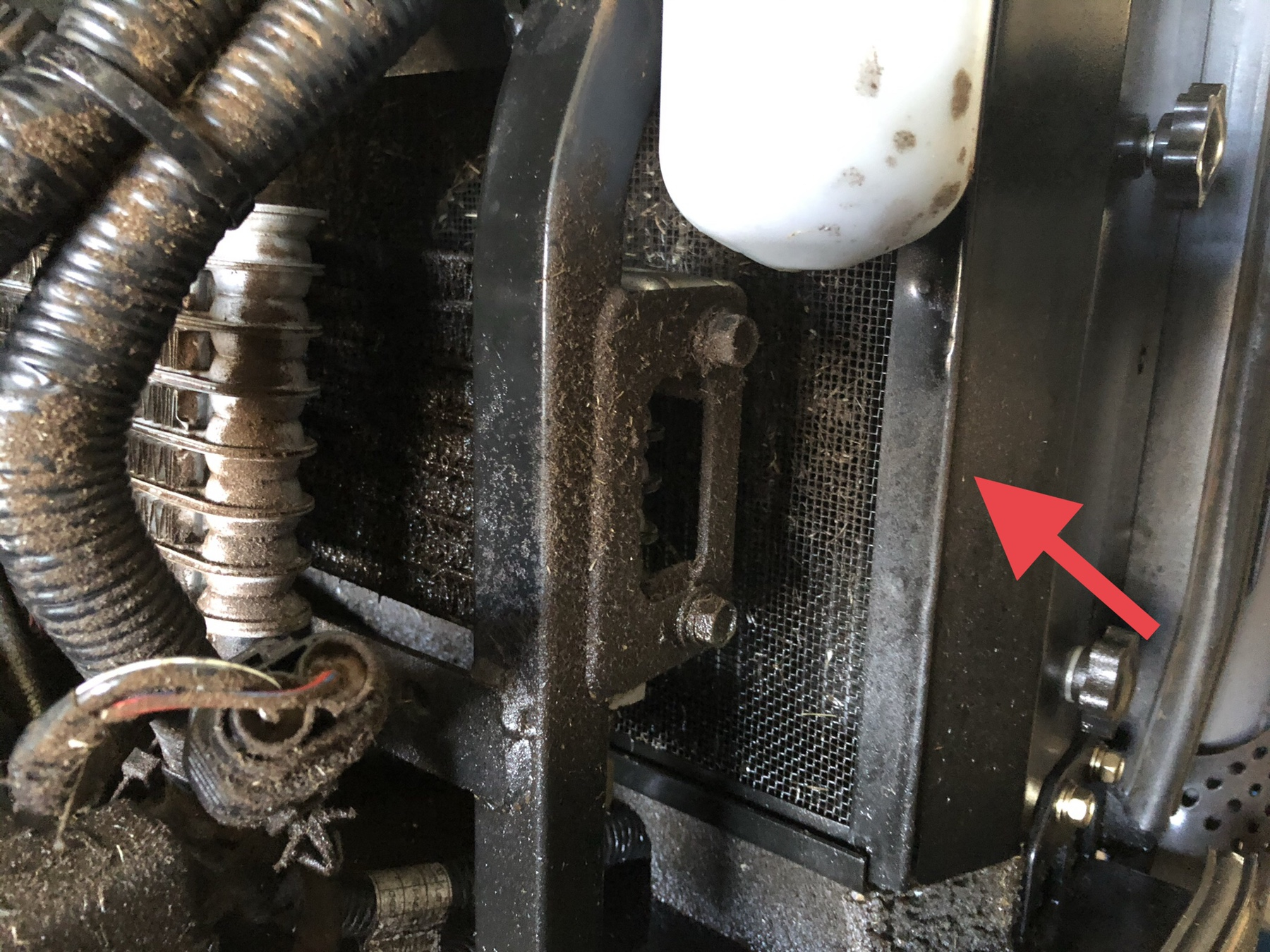

I think my leak might be in a similar area to sodamo's. It seems to be in the left upper corner area as oil accumulated in the edge ridges. See photo. Even though I've cleaned and degreased the whole unit a couple of times, dirt still seems to adhere very quickly throughout the unit. The AC fins right in front of it stay completely clean. It doesn't make sense to me that I leak in one corner would coat the entire unit. Is there any other reason these coolers would be naturally sticky?
The part number changed from 40266755 to 40323120. Makes me wonder if the original wasn't prone to this failure. Online it appears to be about $160.
