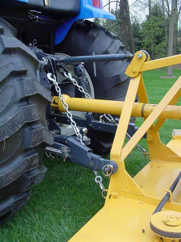

There are several things wrong.
1) As others have noted, the frame is somewhat bent. I think you may just want to replace or fabricate something new. KK's design is probably not the best shape and you could probably get by with something straighter. See arms on attached mower.
2) There is not floating top link, which would allow for the deck to move and maybe have prevented the initial bending
3) Others have had a similar problem with the KK deck, just as you describe, because of the high-mounted pins. Usually the solution has been to simply lower the pins to another location - either the bolt hole below, or drill new.
4) Your top link is rather long, but I expect its so you can get a level mowing. You may want to investigate the installation of the flexible top connection (floating top link) and the addition of check chains instead to get improved and very level mowing. Again, see attachment.
Good luck. I'm sure with a little work you'll have a deck that will last a lifetime and give a great cut too boot.
