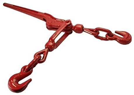

here you go
Yes, this is definitely what I was asking about!
Now, these are for cars, and say they're just for short distances at low speed, just for emergencies. I wonder why? Perhaps it's because they are held on by fabric straps, which they may have done because people tend to have expensive decorative wheels on cars that they don't want scratched. On top of that, a car can easily go fast enough that a chain flailing around could do major damage including to other drivers.
I think if I were going to design something from scratch I'd make them entirely out of chain, and design mounting hooks into the wheel on the inner face, and an attachment point on the outer face of the wheel that includes tightening ability, such as a bolt you drive into the wheel. Nice and strong, so it's not breakable by use.
