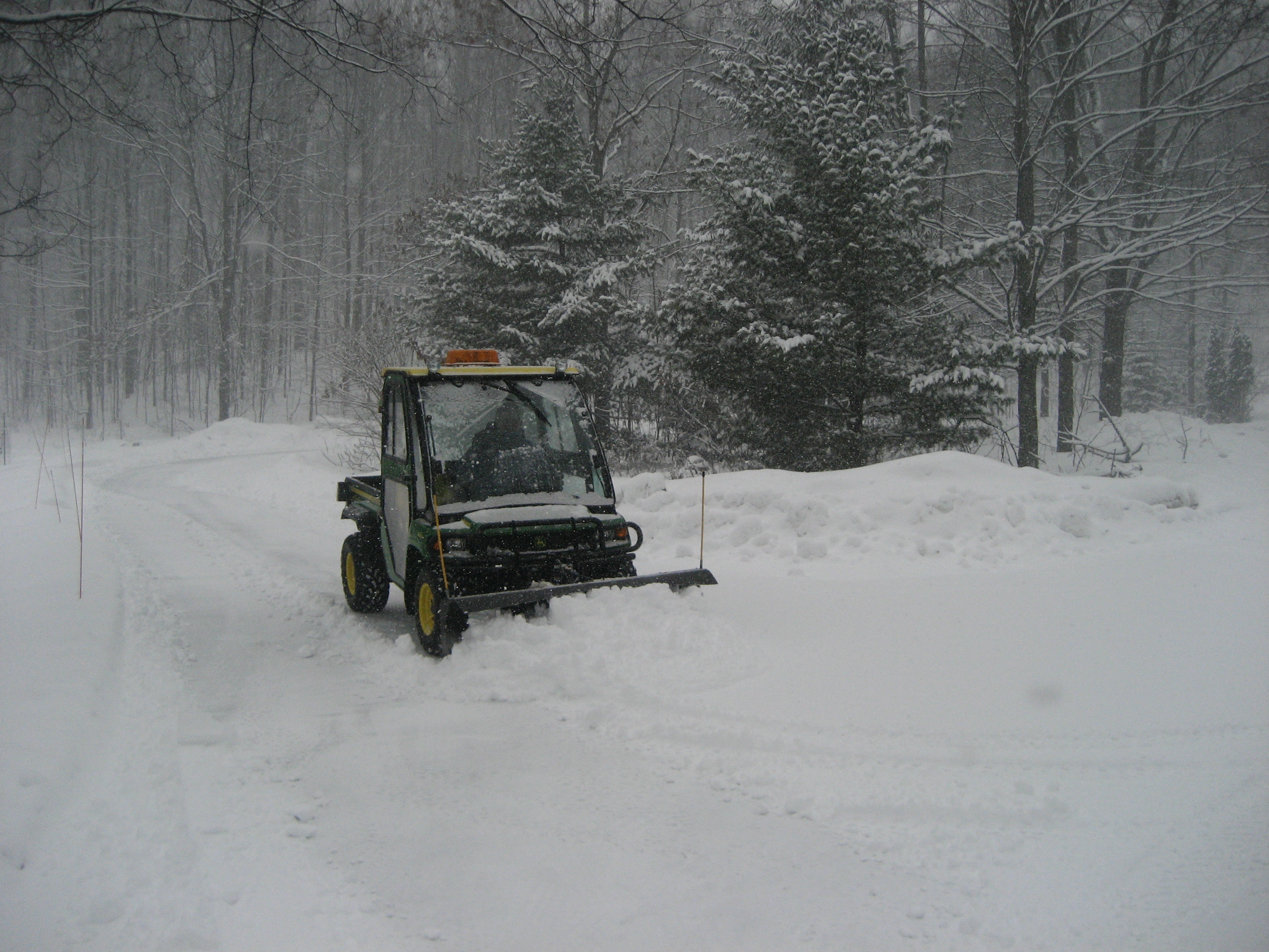

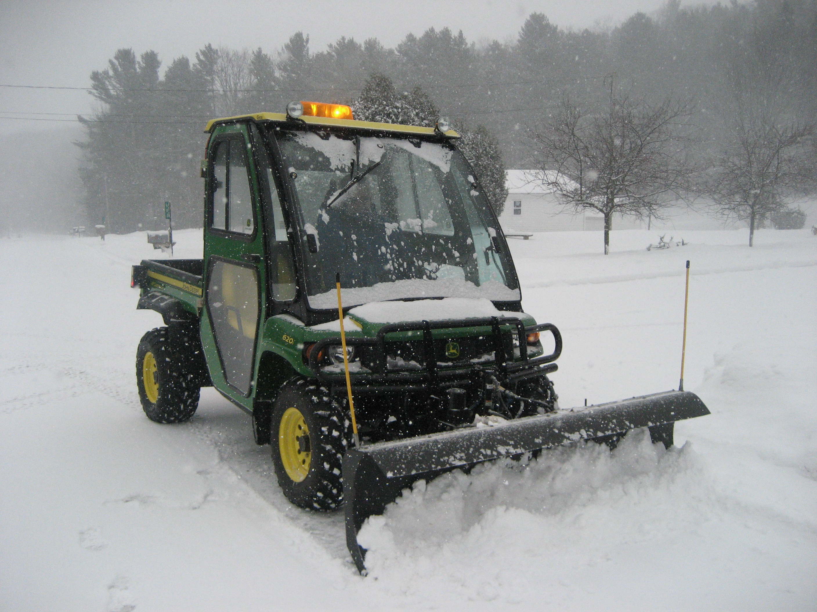

I had a JD Gator 620i (very similar to your 625i, just an earlier version) and I never had any problem plowing, even up to 18" of wet, heavy snow. The plow on my old Gator was JD's "PowerTach" hydraulic plow. To answer your question, though, I did investigate blowers and the only thing that I found that would have worked was the Berco blowers -- and boy, those are not cheap! Gator plowing.JPG
Is your drive belt OK? How are your tires? I never bothered with chains...when I had my Gator in 4x4 there was plenty of traction, especially if I locked the differential.

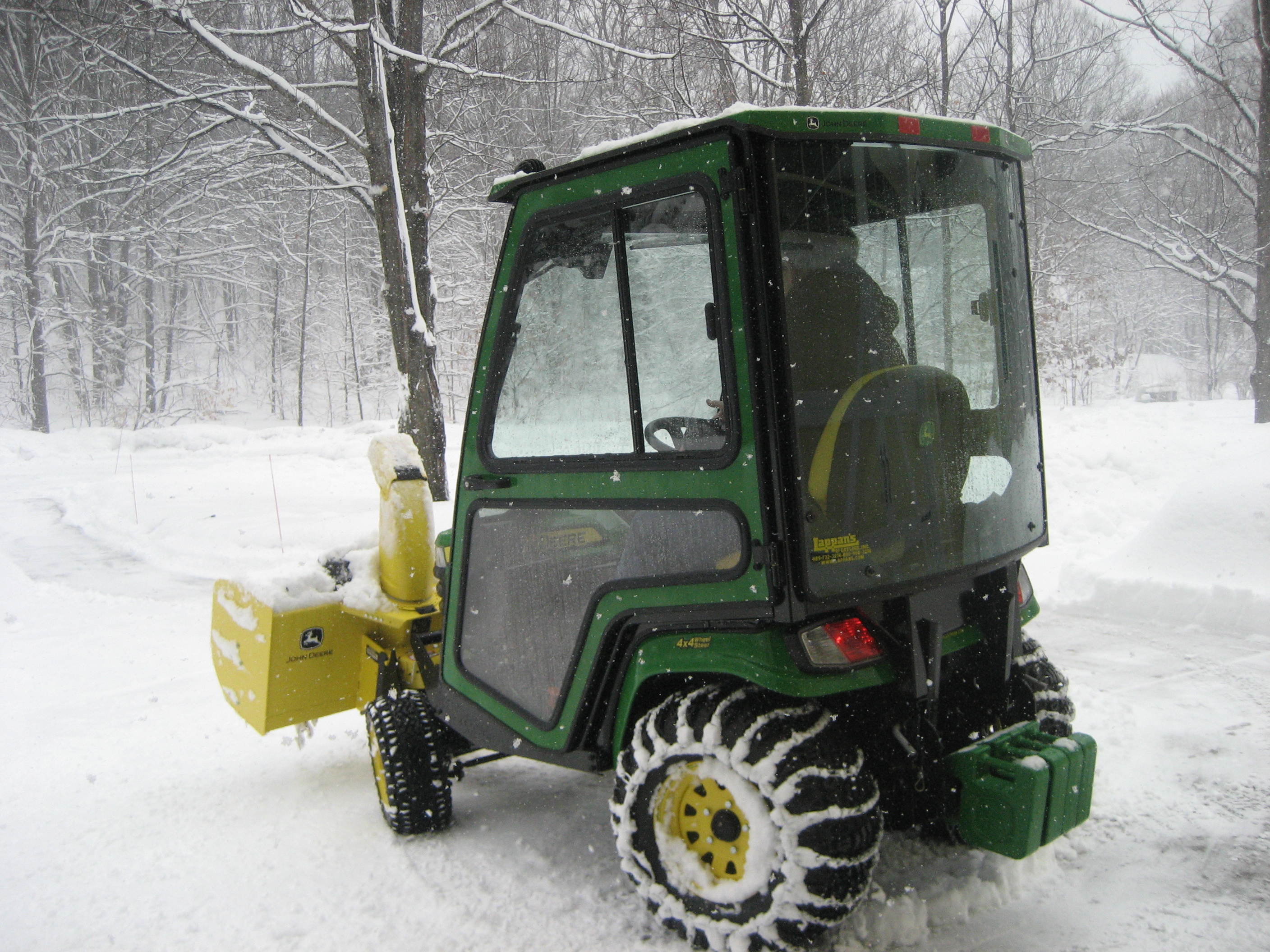

I never put chains on my Gator, but I did on my JD X739 and I did not like them. I bought a set of TerraGrips but never got a chance to use them when I dumped the X739 and bought my Kubota 1100C before this winter started.

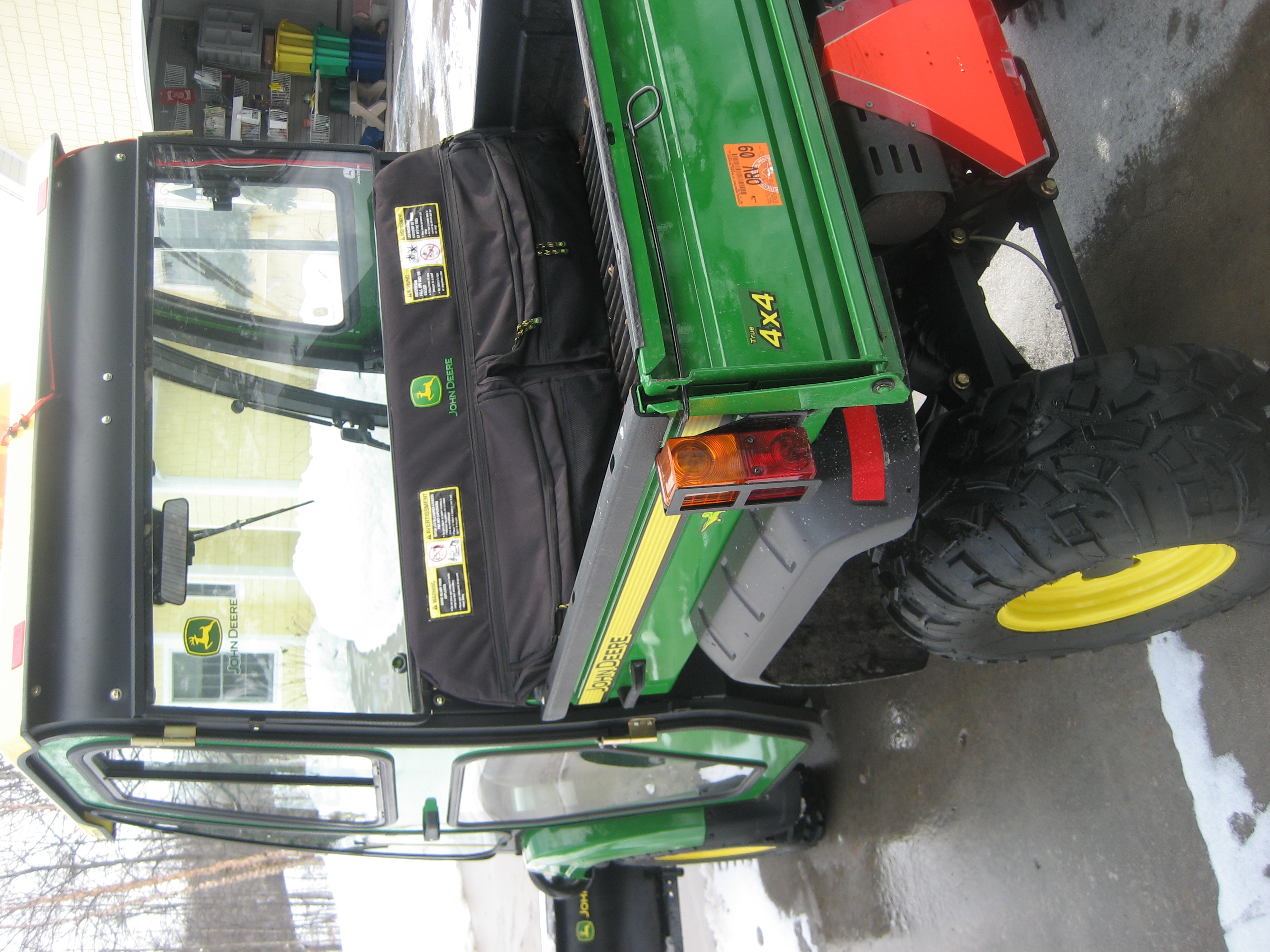

One thing that really helped my Gator maintain traction was just to put a couple hundred pounds of bagged sand ("Tube Sand") in the bed.IMG_4855.JPG

Wow that's unbelievable to me. You are even going uphill in the picture. Currently the bed is empty. Maybe I just need to add a bunch of weight. Or get new tires. The tires look fine to me but I don't know anything about the history of them. Maybe they suck. They have big deep treads though.

I had some sort of halfway decent ATV tires on my Gator, nothing special, but the weight in the bed really helped. I'd suggest putting enough weight in the bed to offset the weight of the plow. You have to figure that if you add 300 pounds to the front end, you're changing the weight distribution of the machine and will end up with a lower percentage of weight in the rear unless you offset it somehow. Good news is that "Tube Sand" is cheap (and comes in handy if you ever get stuck).IMG_3693.JPGIMG_2595.JPG
